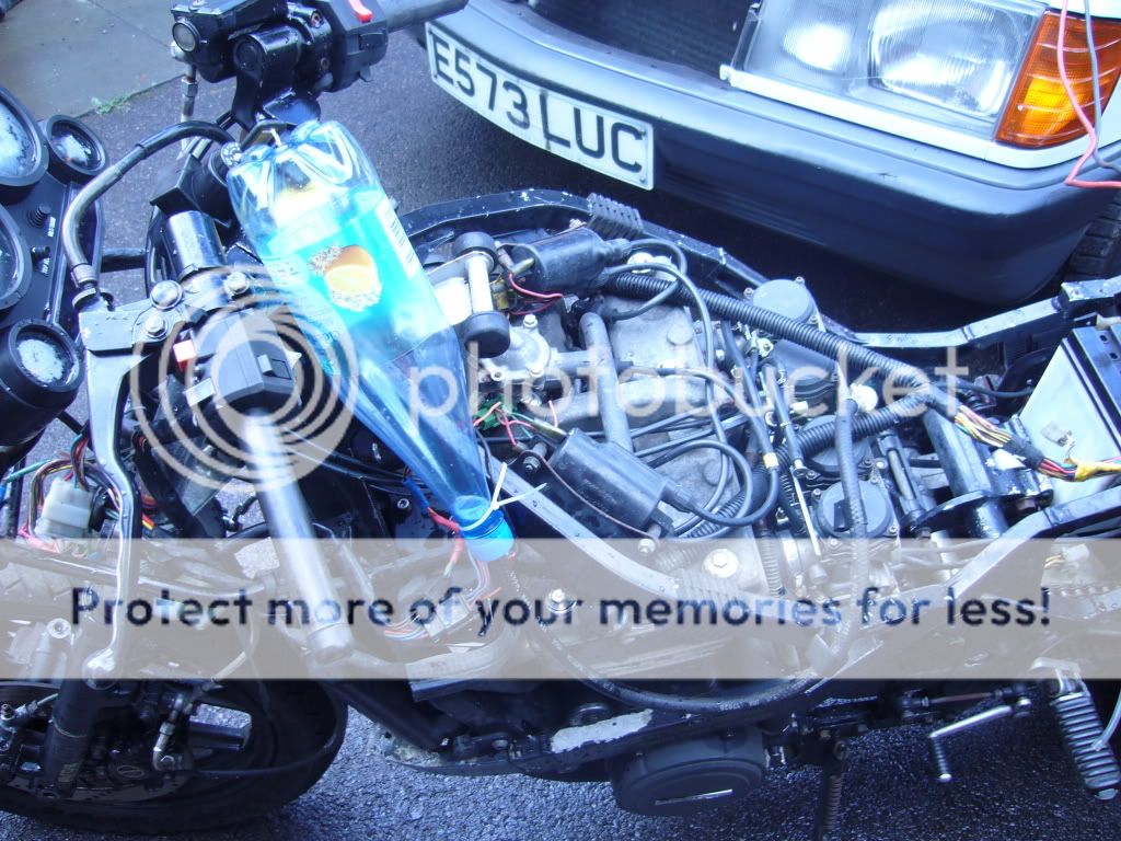

So I got the bike home last Thursday and started cleaning. I removed tank and fairings etc. Pressured washed it and put it in the garage. Each day I spend a couple of hours working on it.
Today I got it running, smoothly, but definitely only on cylinders 1 and 2. MMMM, burnt my hand when I grabbed the pipe on 2! 3 and 4 were cold. But is did allow me to check a couple of things, Rev counter works, as does the volt meter, most of the electric's. I dont appear to have any water leaks, but there is a sheared bold in the head cover.
Once I have worked out how to attach the pictures properly, I will add them as I started taking after I saw what Squishio was up to.

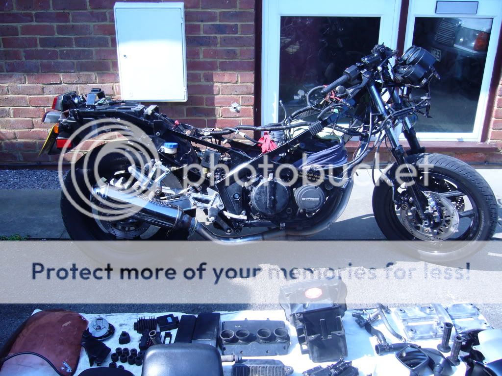

Here we go. I had already started work so have no before photo's. I started by pressure washing the whole bike. Then I started on the front wheel. This is after an hour or cleaning.
https://i634.photobucket.com/albums/uu62/russeleoin/Kawasaki%20GPZ400R/P1020507.jpg
other side, not started.

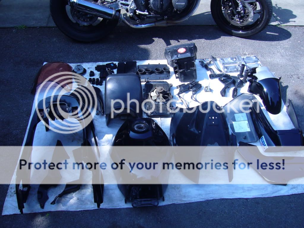

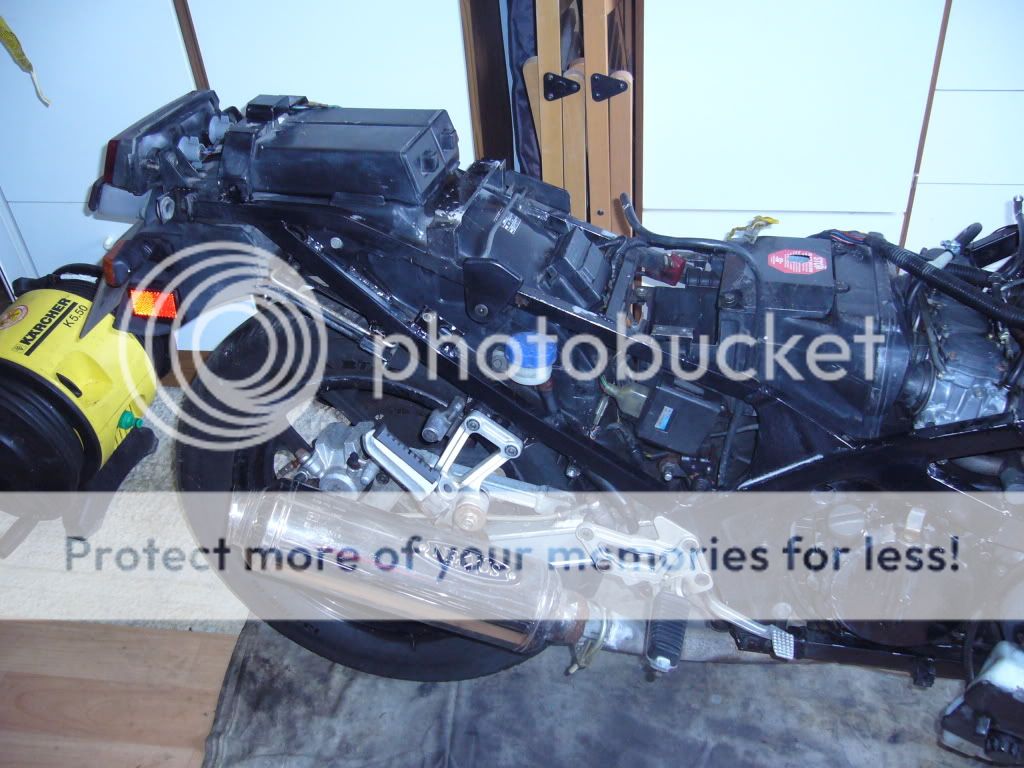

As it stood yesterday.
https://i634.photobucket.com/albums/uu62/russeleoin/Kawasaki%20GPZ400R/P1020508.jpg

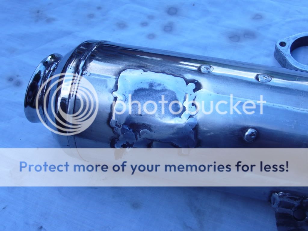

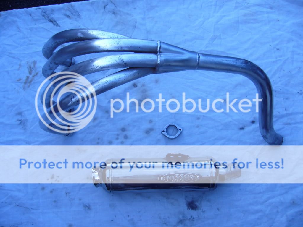

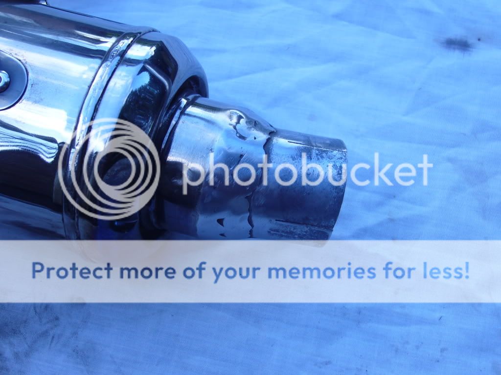

The dreaded Nexxus 4 into 1 and a very poor weld.
https://i634.photobucket.com/albums/uu62/russeleoin/Kawasaki%20GPZ400R/P1020509.jpg

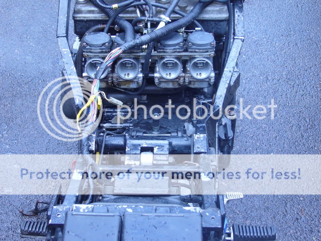

About to pressure wash for the 2nd time( dont worry, I stuffed the carbs)
https://i634.photobucket.com/albums/uu62/russeleoin/Kawasaki%20GPZ400R/P1020513.jpg

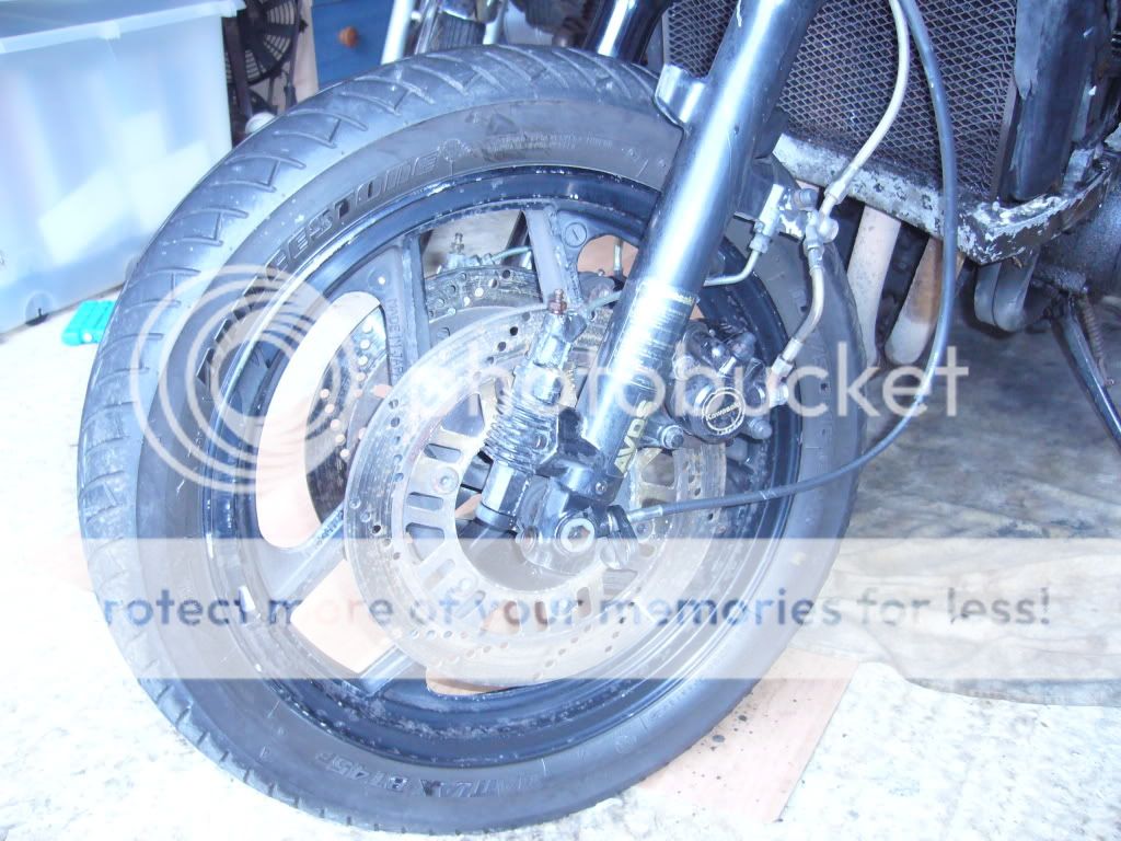

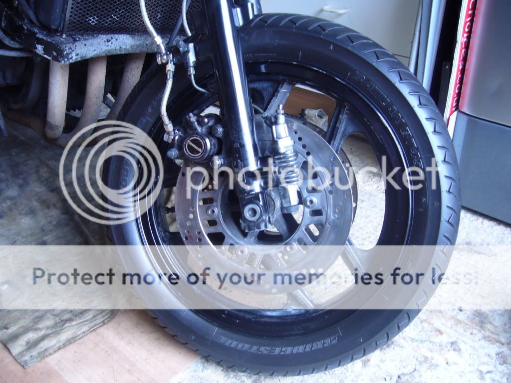

Washed.
https://i634.photobucket.com/albums/uu62/russeleoin/Kawasaki%20GPZ400R/P1020514.jpg
Emergency tank to get it running, and run it did.

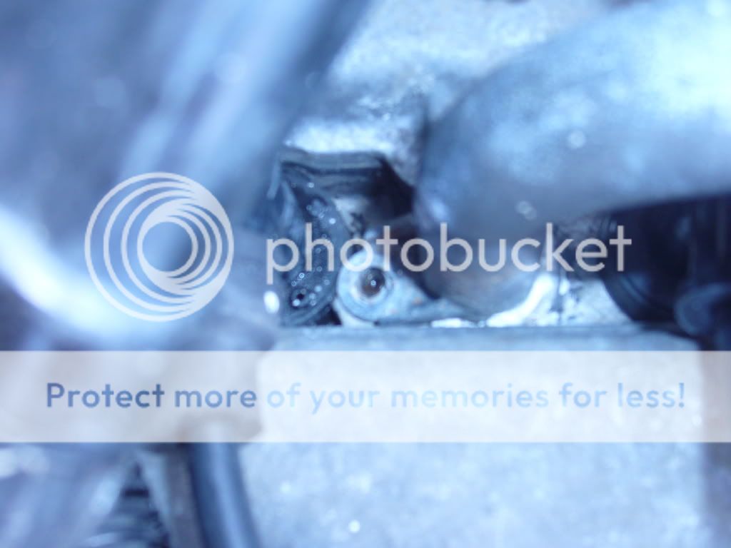

https://i634.photobucket.com/albums/uu62/russeleoin/Kawasaki%20GPZ400R/P1020517.jpg

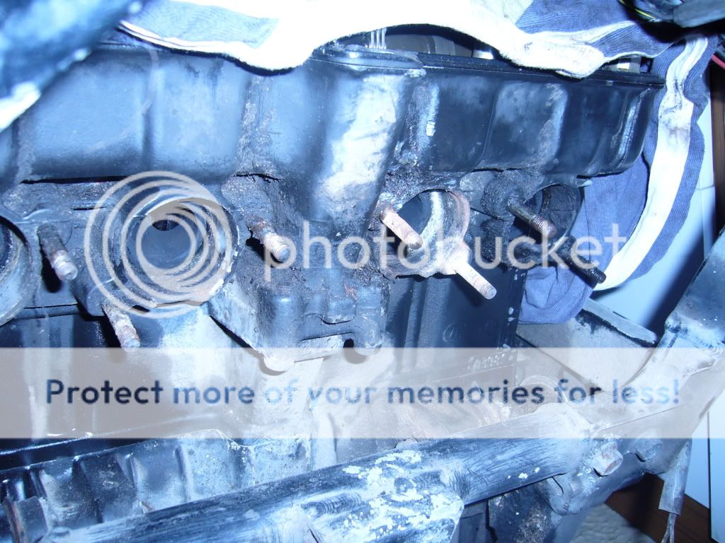

Only serious problem, is the bolt holding the cooling pipe to the head has sheared and someone has already tried to drill it out. Oh well, I will have to deal with that later.
https://i634.photobucket.com/albums/uu62/russeleoin/Kawasaki%20GPZ400R/P1020520.jpg

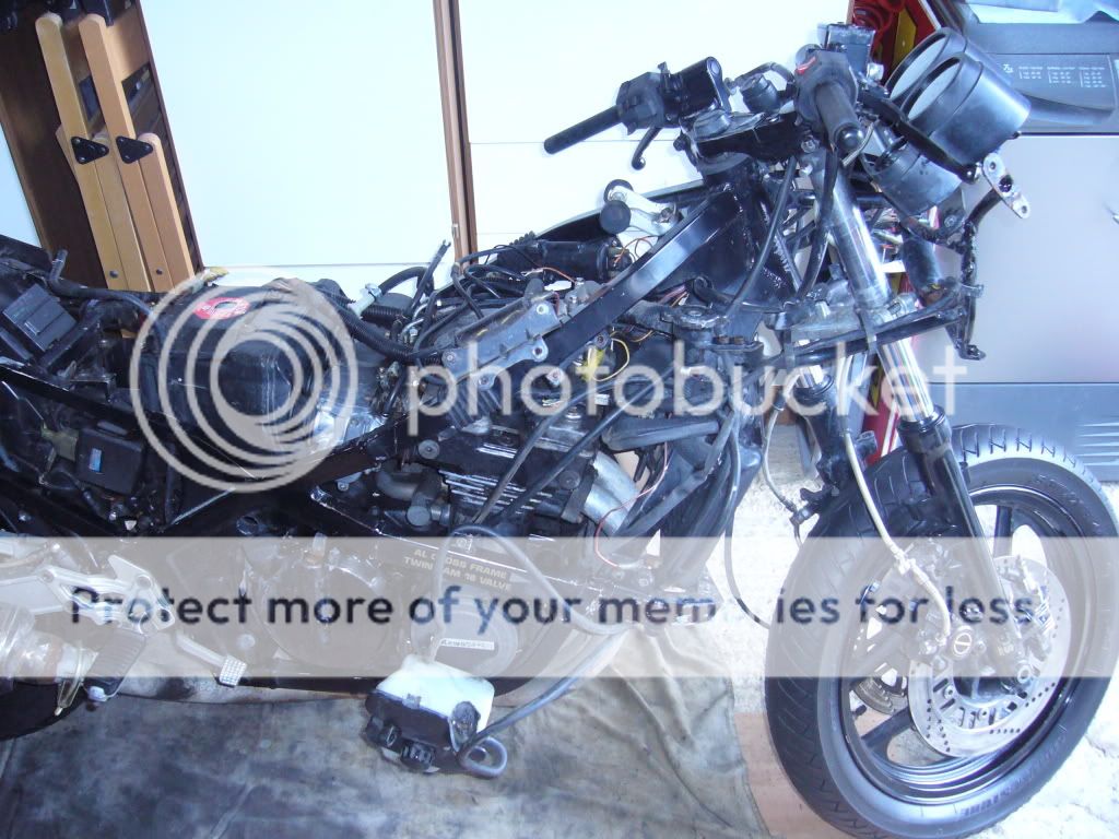

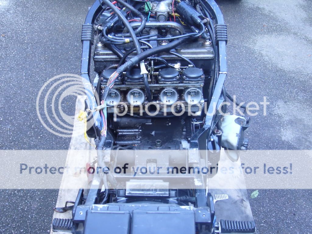

This is where I left it on Sunday
https://i634.photobucket.com/albums/uu62/russeleoin/Kawasaki%20GPZ400R/P1020525.jpg
https://i634.photobucket.com/albums/uu62/russeleoin/Kawasaki%20GPZ400R/P1020524.jpg

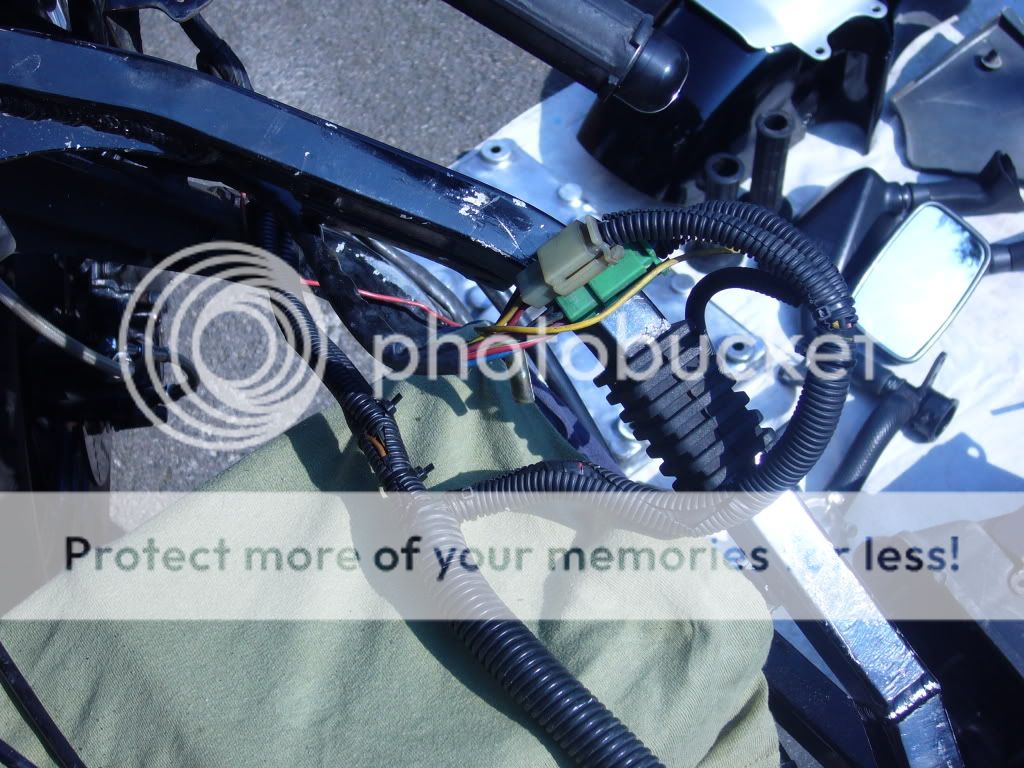

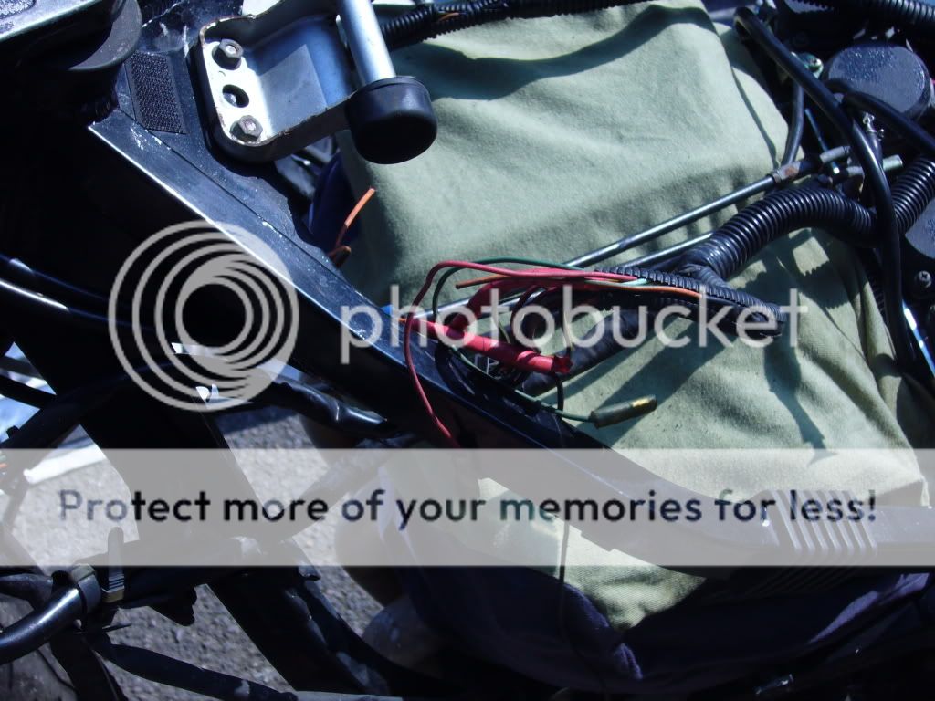

I hate tatty wiring
https://i634.photobucket.com/albums/uu62/russeleoin/Kawasaki%20GPZ400R/P1020526.jpg
But I dont need a new one, just tidying the old one.
https://i634.photobucket.com/albums/uu62/russeleoin/Kawasaki%20GPZ400R/P1020527.jpg

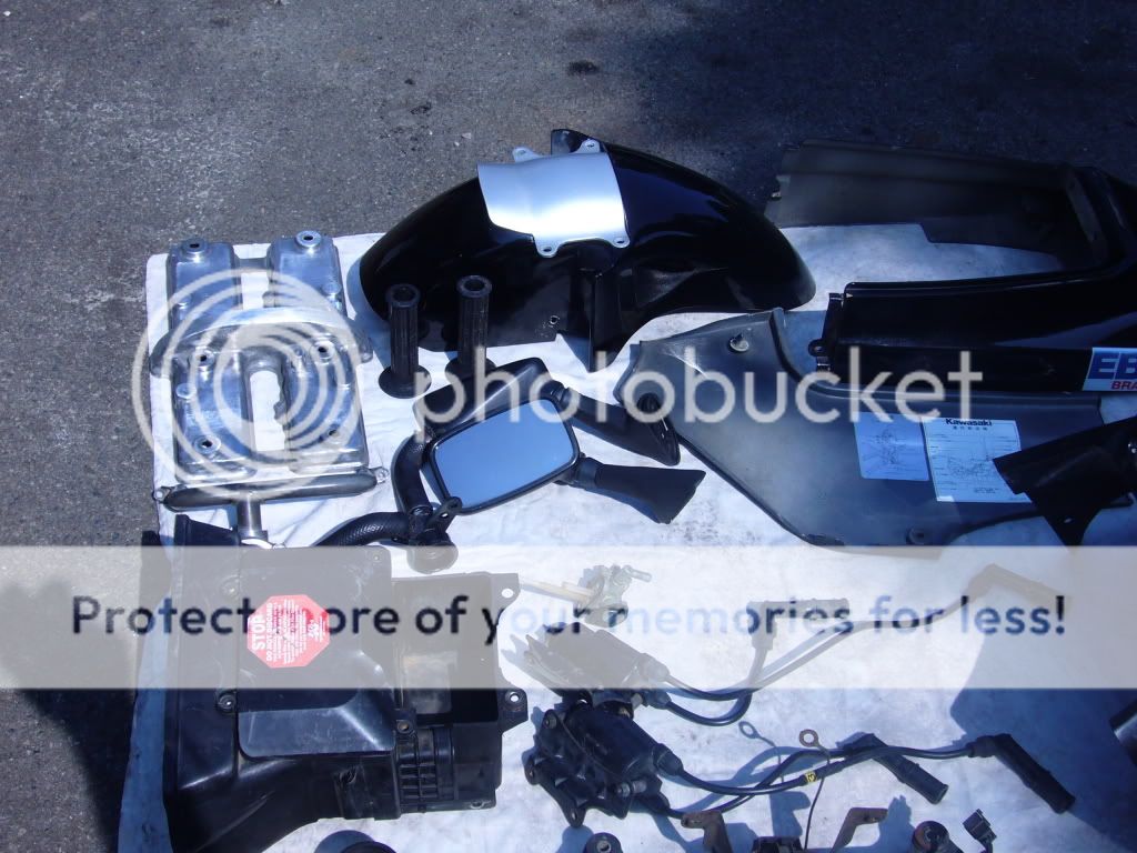

russeleoin
Joined: 10 Apr 2009
PostPosted: 20:57 - 30 Apr 2009    Post subject: Reply with quote
I am telling you these pipes are ally
https://i634.photobucket.com/albums/uu62/russeleoin/P1020532.jpg
If you have a look at the early pictures you will see how ugly this weld was. I ground it down and will finish it with wet&dry. It wont be perfect but will have to do.
https://i634.photobucket.com/albums/uu62/russeleoin/P1020533.jpg
This one you cant see when it is on the bike.
https://i634.photobucket.com/albums/uu62/russeleoin/P1020534.jpg
The offending stud was 2nd exhast port from the left in the picturtes. It will be completely cleaned then I will smear copper grease over all of them. That will prevent the carboning up in future and make future removal easy.

Hi Gazda and Alun, ja I have checked the switches, plugging my multimeter in, I can trace the circut from the keyswitch through the kill switch and start button down to the Junction box. All okay there, and the relay does work so I think it is in the junction box. I have the wiring diagram as well. What I dont understand is that the horn is so feeble as well. It is almost as if there is a short circut somewhere????? if it was just the horn or the starter I would think a single failure, but all the electrics seem iffy and they did all work when I started( that old adage of "if it aint broke, dont fix it" springs to mind) I was carful with the wiring and soldered all the joins so it should really be better than before. I will go and have a poke around after work this evening.
