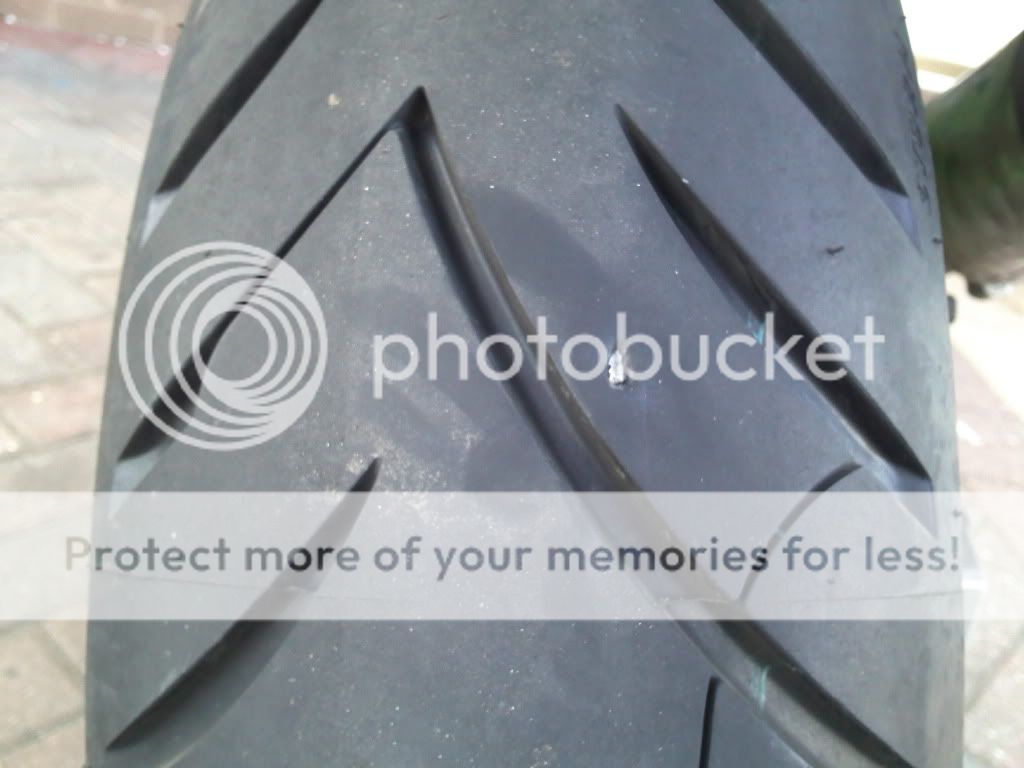

Went out for a blast on the bike this afternoon and came back to find a nasty puncture in my 315 mile old rear tyre Evil or Very Mad
It appears to have gone straight through and has been hissing like a mentalist snake Rolling Eyes
Can it be saved or is the tyre a write off?
Sorry can't upload a photo as my USB cable's gone walkies Neutral

How big is the hole? anything <4mm can be plugged, Hell if it is smaller your tyreman may shock you by drilling it out to 4mm.
While those home puncture repair kits can fix holes upto 3mm too.
if it is a gash then no, if it is in the side wall then no.

Whereabouts on the tyre is it? It will depend on which part of the tread it is on!

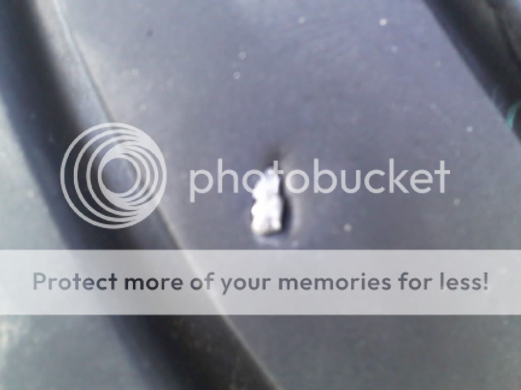

A couple of pics now added.
https://i226.photobucket.com/albums/dd47/nasty76/IMG019.jpg
https://i226.photobucket.com/albums/dd47/nasty76/IMG018.jpg

Plug it.

Definitely. That one looks straight forward

As I don't have any kind of stand (paddock, Abba) to remove the rear wheel, would it be safe to inflate to correct pressure and ride to the garage around 5 - 6 miles? Bearing in mind that air IS leaking.
Also, having the tyre repaired/plugged, does this restrict the speed at which i can ride on the tyre?

5 miles at 30mph is 10 minutes, so as long as it lasts that long pump it up and ride it.

As others have said, get it plugged ... as you can see, you can get pretty big ones - they do last and unlike the temporary ones that you can DIY, there are no speed restrictions if a proper 'mushroom plug' type one (that a garage should fit). Thumbs Up

Proper mushrom plugs are fitted from the inside. I've been over 200mph on a tyre with one of those.

Thing is is that I don't want to make the damage any worse, the tyre is an Avon Storm 2, I think it may be covered by the 1mm Road Hazard Warranty that Avon offer on these tyres (you get a puncture within the first 1mm of wear, if the tyre can't be repaired they give you a new one).
I may aswell see if what the craic is with that.
