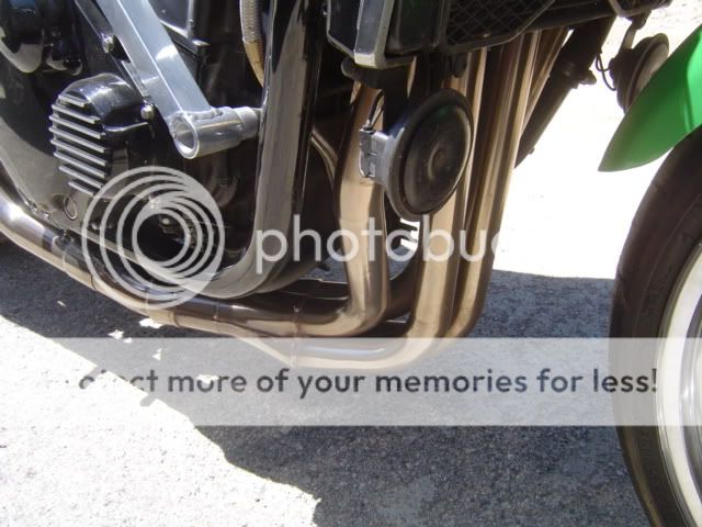

The Muzzy on my ZRX is 11 years/88,000 miles old & it looks like this:
https://img.photobucket.com/albums/v317/ZRX61/Vehicles/ZRX11003.jpg
