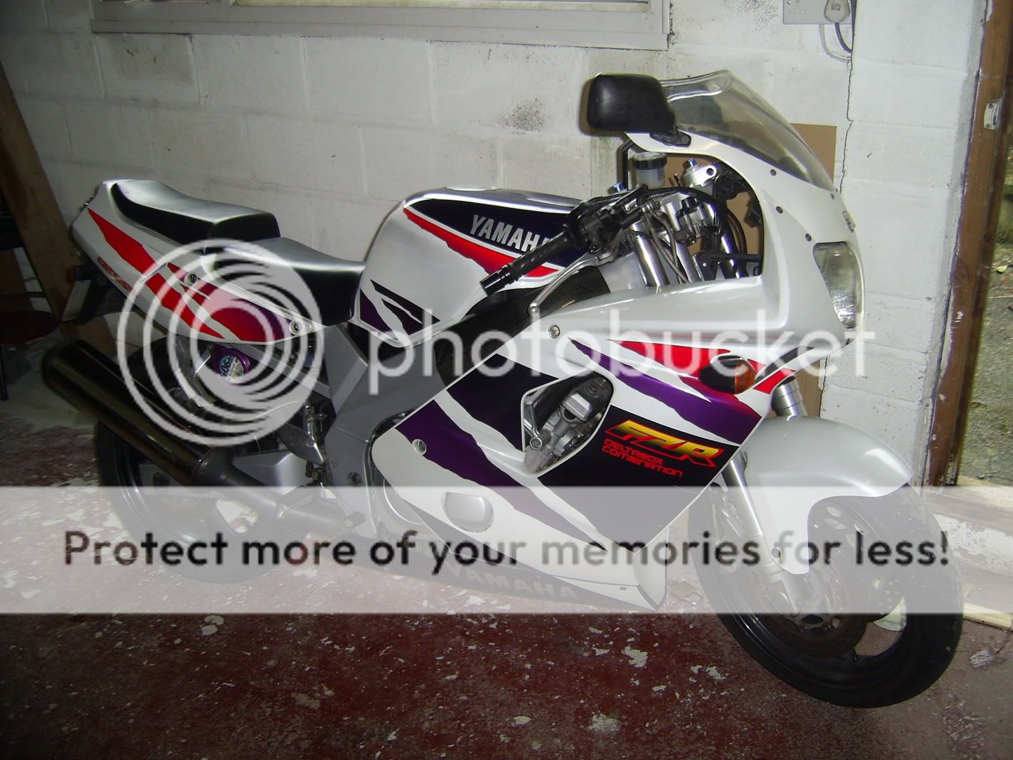

Year and a half ago she started off as this

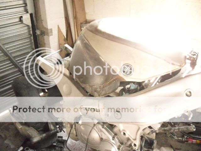

First off tank, seats and exhaust off
https://i43.tinypic.com/jjmkx1.jpg
https://i44.tinypic.com/v5b8jn.jpg

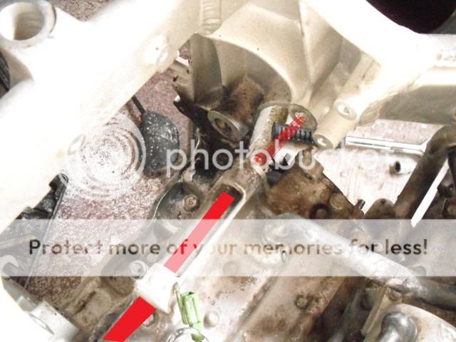

only two snapped studs
https://i43.tinypic.com/1253sz9.jpg

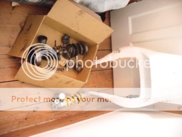

So, frame and engine are seperate entities. Then my girlfriend arrived and pointed out my head was bleeding (from standing into the CB frame) so I went for a shower

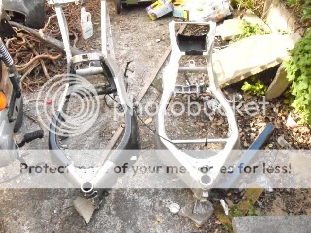

Next I popped the FZR400 frame on. Unfortunatly the bit thats missing is the mount thingy for one of the rear engine mounts. As you can see the frame hole aligns with the engine hole, but nothing else

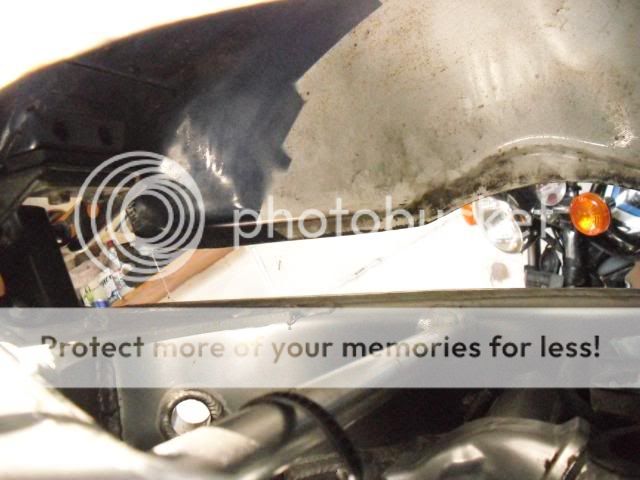

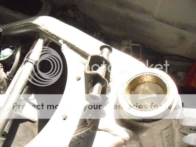

Anyway Next I had to modify the front tank mount, because of the closer spaced holes and the steeper angle
https://i35.photobucket.com/albums/d170/tristanthe/hats/SAM_0047.jpg
OK, thats boring as fuck, but it took twenty minutes soul destroying dremmeling and angle grinding, so I want to show it off Razz

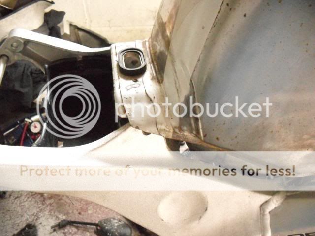

Now, choices with the tank. If I carry on trying to fit the 600R tank, I'll need to cut the back lip, so it drops down a bit, and make some kind of mount
https://i35.photobucket.com/albums/d170/tristanthe/hats/SAM_0048.jpg
if that flat bit was a bit narrower the whole back end of it would drop by about two inches, which I reckon would make it follow the lines of the frame quite well

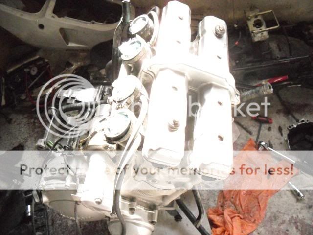

Unfortunatley, theres fuckall room under the tank
https://i35.photobucket.com/albums/d170/tristanthe/hats/SAM_0051.jpg
thats without carbs, with carbs theres maybe enough room for pod filters, but certainly not an airbox Thinking

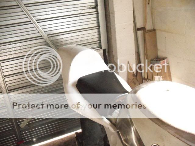

Anyway, with nothing much to do I did a little mock up for the R6 tail, kindly donated by mattspratt
https://i35.photobucket.com/albums/d170/tristanthe/hats/SAM_0052.jpg
https://i35.photobucket.com/albums/d170/tristanthe/hats/SAM_0053.jpg
yes, I know, it looks pretty horrible. When it all aligns right I'll recide whether to go with it or not, but since the tank needs deciding first, no point.

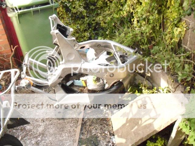

Anyway. Then I stripped the loom and ancilleries off the 600 frame, to get a bit of a comparison.
https://i35.photobucket.com/albums/d170/tristanthe/hats/SAM_0054.jpg
https://i35.photobucket.com/albums/d170/tristanthe/hats/SAM_0055.jpg
According to my scales, the 400 frame comes in at 10 kilos, the 600 at 20 Thumbs Up .

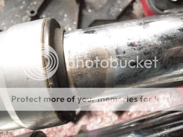

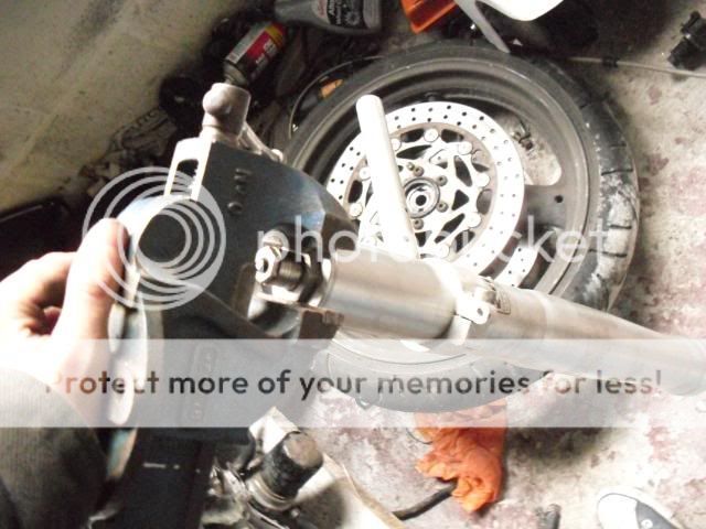

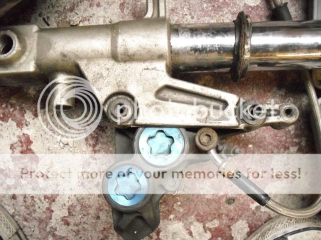

Though it isn't rough to the touch, so it should hopefully clean up ok. I decided to strip them down, then realised my 32mil socket was at Matts. No problem:
https://i35.photobucket.com/albums/d170/tristanthe/SAM_0059.jpg
clip on handily from an R1, from when I bought the brakes a while back. Anyway, then to get the allen bolt out the bottom
Evil or Very Mad
Ugh, I dont know if you've noticed from the backgrounds of the pictures, but I am by no means a tidy person. I know for a fact there are 5 10mm allen keys in my garage, two from socket sets, the T bar one I butchered the other day and two from sets. It took me over 2 hours tidying/searching till I found one. 20 seconds of lidl grindering took the bent end off, so I could pop it in a 10mill socket. Then the fucker rounded. Fortunatley the key rounded more than the bolt head, but I'm very wary about doing it by hand again, as fuck knows how I'll get it out if it properly rounds. Fortunatletey a TX55 fits in there beautifully now. So I need a big vice, and some leather jaws before I try again.
Anyway that, plus the condition of the stanchions fucked me right off so I packed it in for the day. I may go out later to modify the fork bottoms to take my bluespots:
