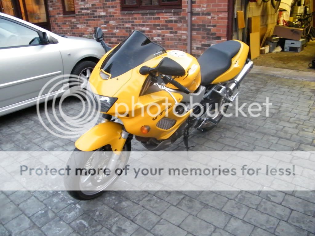

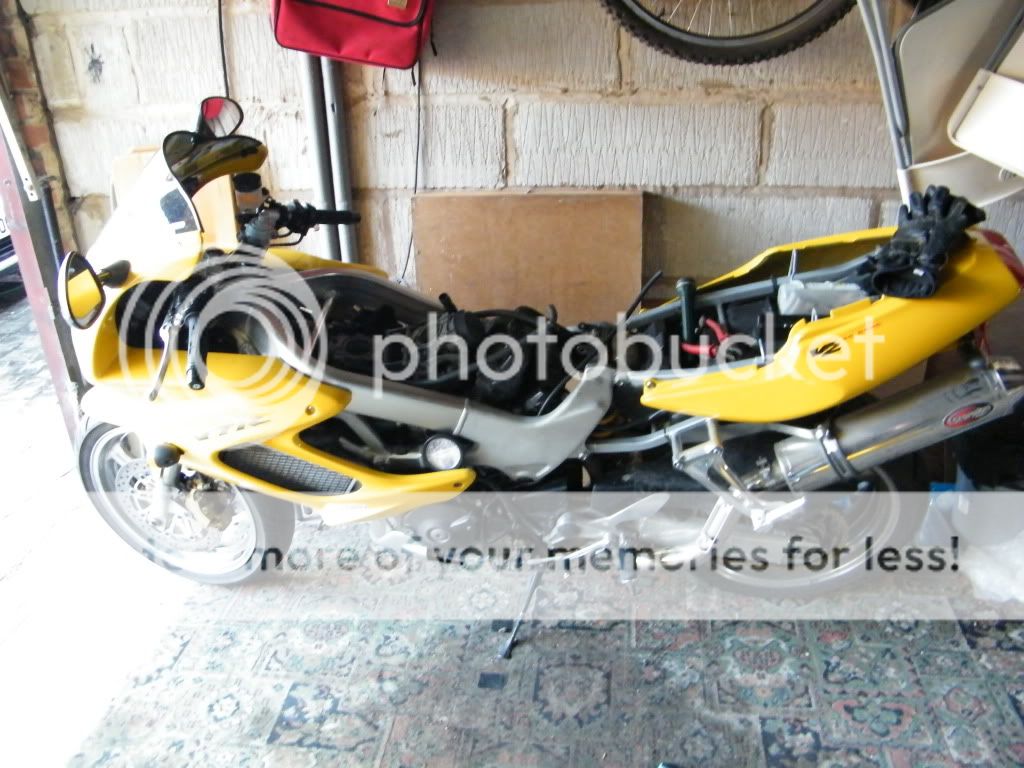

Hey thought i'd show a bit of progress of ownership and mods while i own this awesome bike, seriously, i love this thing!
Unfortunatly somewhere down the line it was crashed and fixed etc but has since been neglected.
I plan on keeping this bike to be honest and losts of things keep popping up on my mind to play with etc like a single sided swing arm, and a front fairing with ducati or endurance style headlight along with engine mods (bigger cc or turbo?).
Anyway, start in an open area!

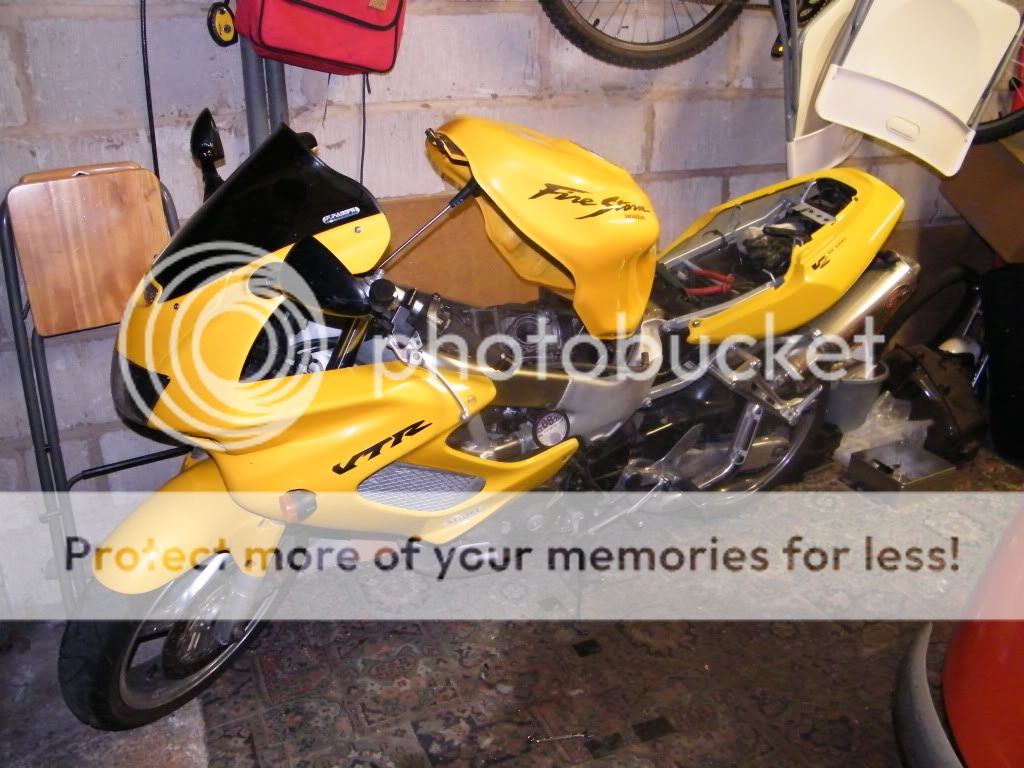

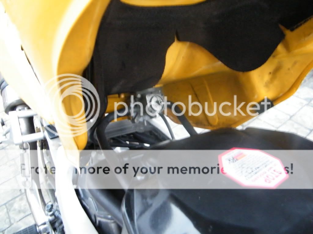

Tank up! This was to allow access to the carbs for removal and front and rear cylinder heads.
https://i907.photobucket.com/albums/ac278/IXITUGIXI/DSCF0083.jpg

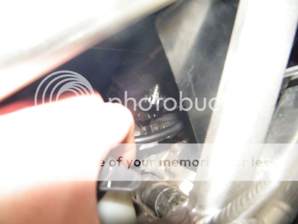

Don't forget to turn your fuel tap off when removing the tank! (I didn't get chance to remove mine yet)
https://i907.photobucket.com/albums/ac278/IXITUGIXI/DSCF0084.jpg

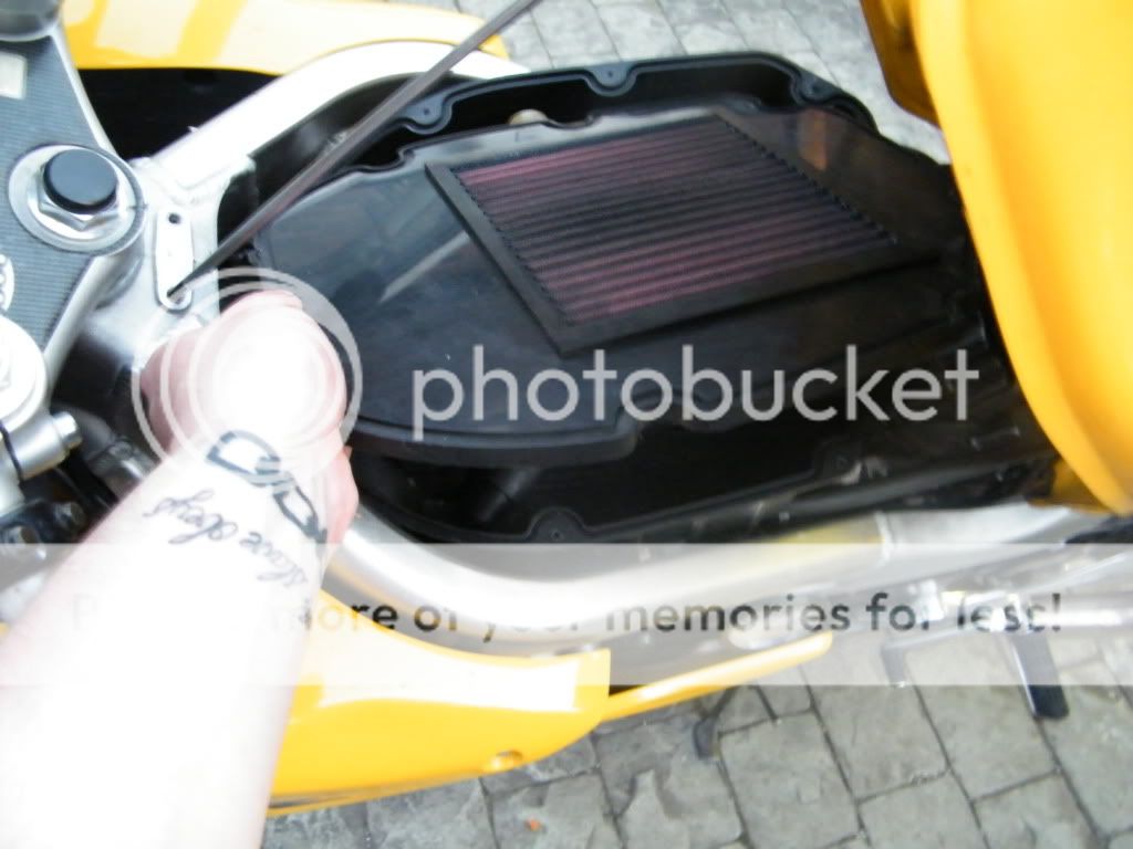

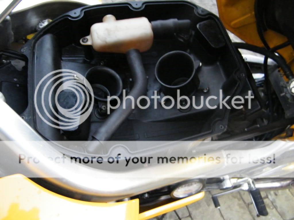

Remove your airbox lid to reveal your air filter.
https://i907.photobucket.com/albums/ac278/IXITUGIXI/DSCF0086.jpg

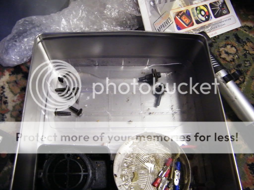

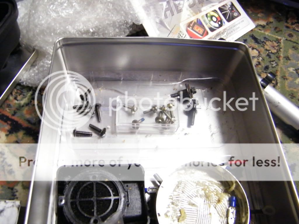

Store your screws like so, they will be safe and you will remember better where they belong.
https://i907.photobucket.com/albums/ac278/IXITUGIXI/DSCF0085.jpg

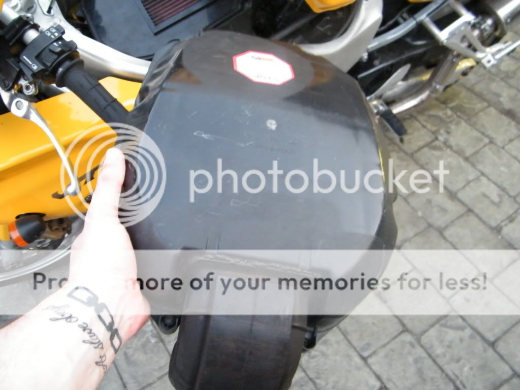

Remove your air filter, if its a K&N hold upto the light to see if its blocked or not, if its standard, it will be black-ish, you CAN blow it out with an air line, but its better to replace, trust me.
https://i907.photobucket.com/albums/ac278/IXITUGIXI/DSCF0088.jpg

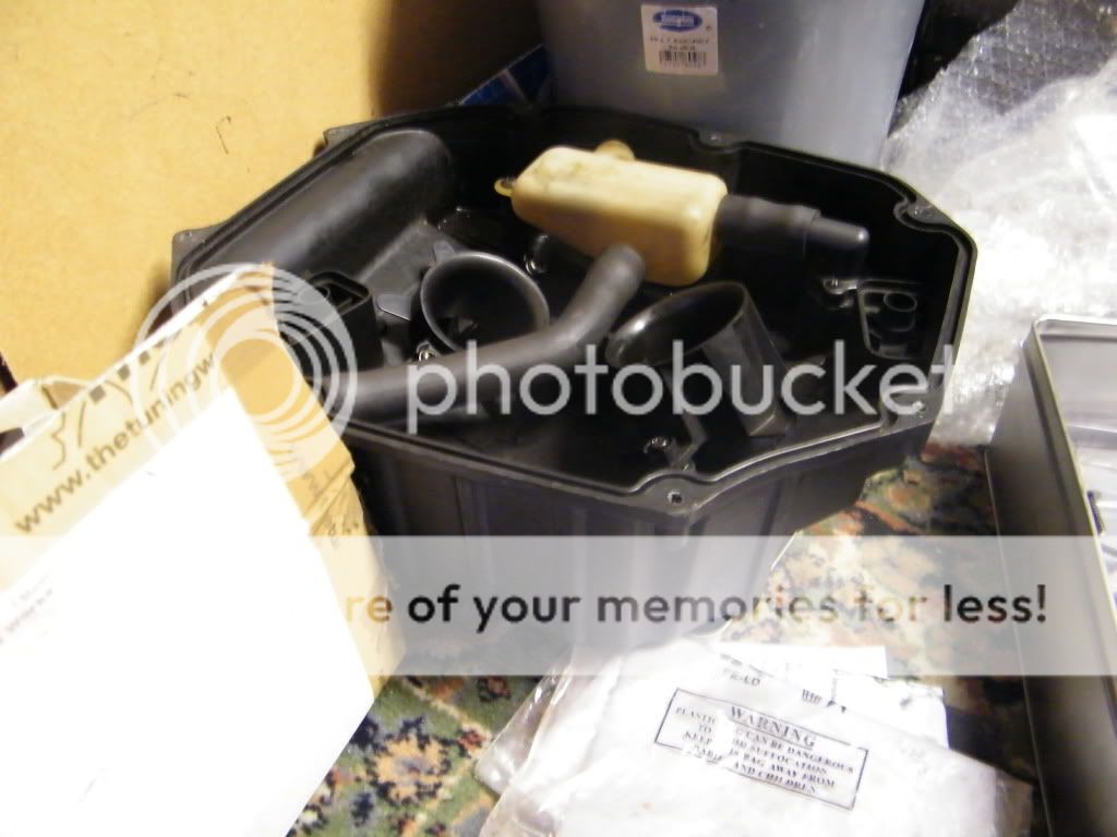

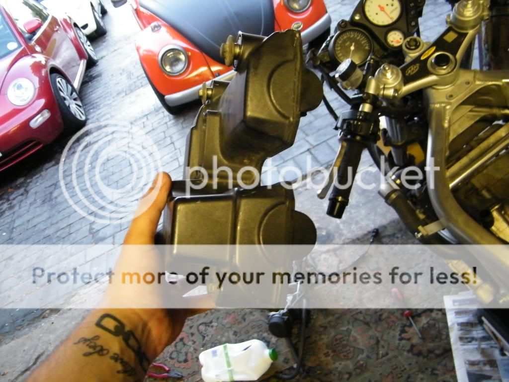

Then you will have the lower portion of the airbox.
https://i907.photobucket.com/albums/ac278/IXITUGIXI/DSCF0090.jpg

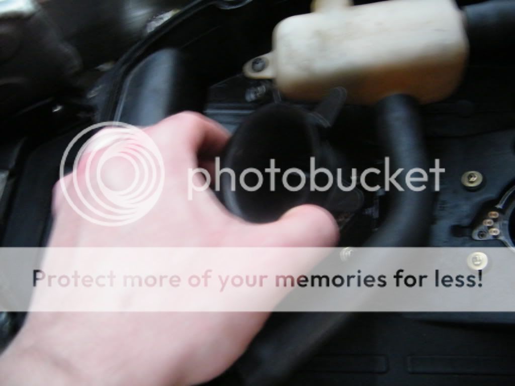

You need to remove these stacks on my bike to get to the screws holding the box onto the carbs.
https://i907.photobucket.com/albums/ac278/IXITUGIXI/DSCF0091.jpg
These arrows show the correct arrangement of said stacks.
https://i907.photobucket.com/albums/ac278/IXITUGIXI/DSCF0093.jpg
Remove the 2 screws and remove the stack.
https://i907.photobucket.com/albums/ac278/IXITUGIXI/DSCF0095.jpg

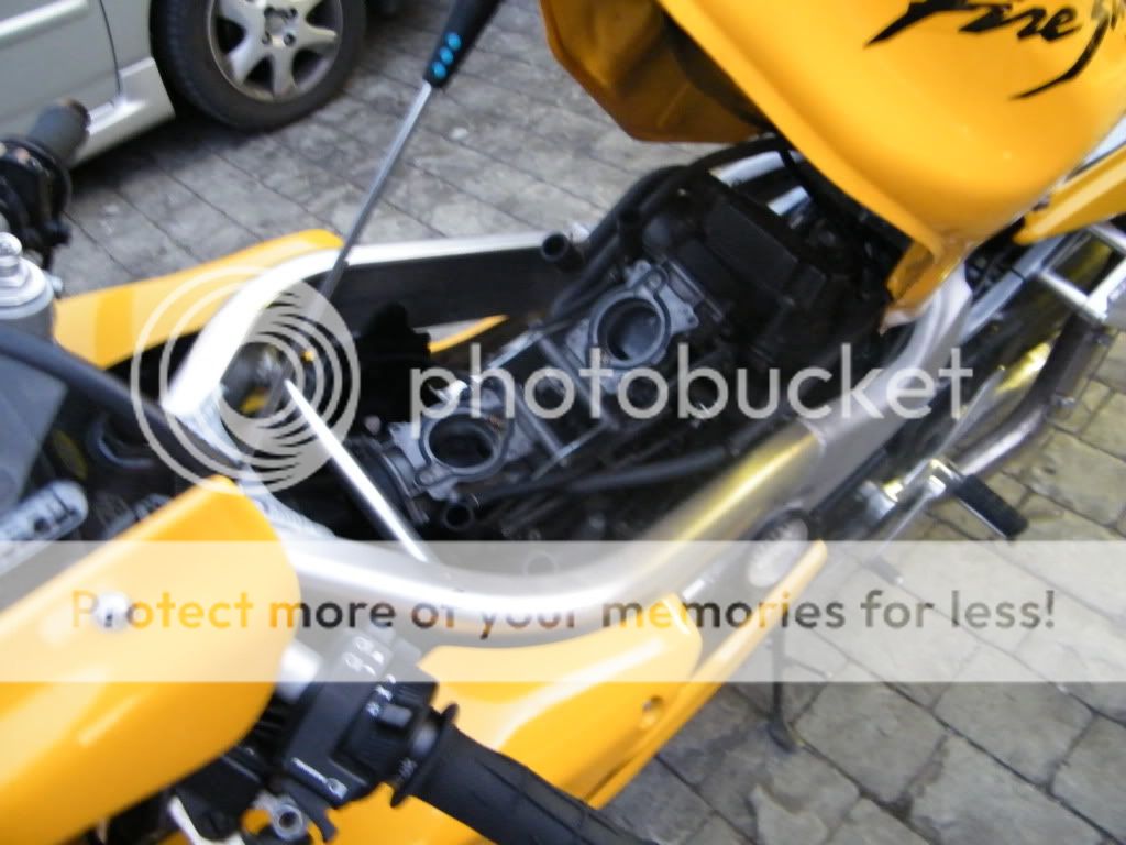

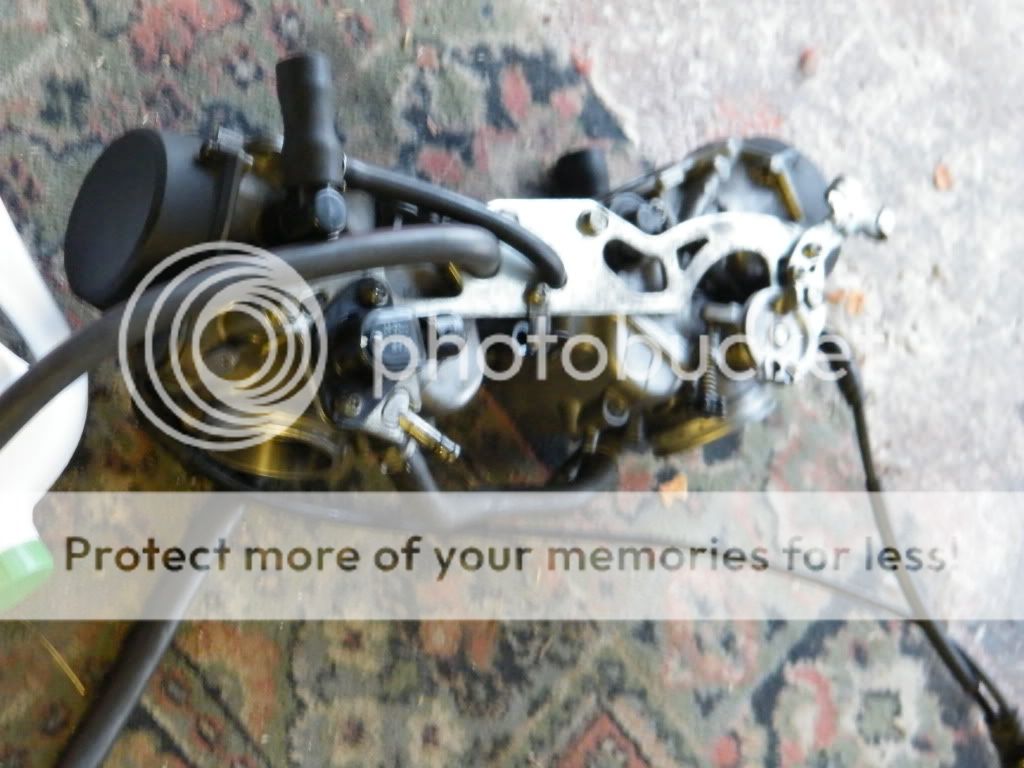

Heres the carbs, quite compared to what i'm used to.
https://i907.photobucket.com/albums/ac278/IXITUGIXI/DSCF0100.jpg

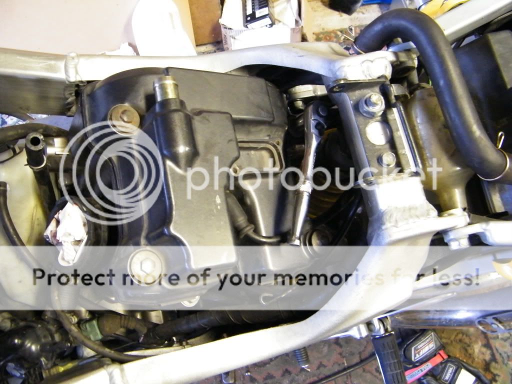

I undid the plastic cover, someone already cut holes into it to fit a screw driver it looks like.
https://s907.photobucket.com/albums/ac278/IXITUGIXI/?action=view¤t=DSCF0102.jpg
https://i907.photobucket.com/albums/ac278/IXITUGIXI/DSCF0106.jpg

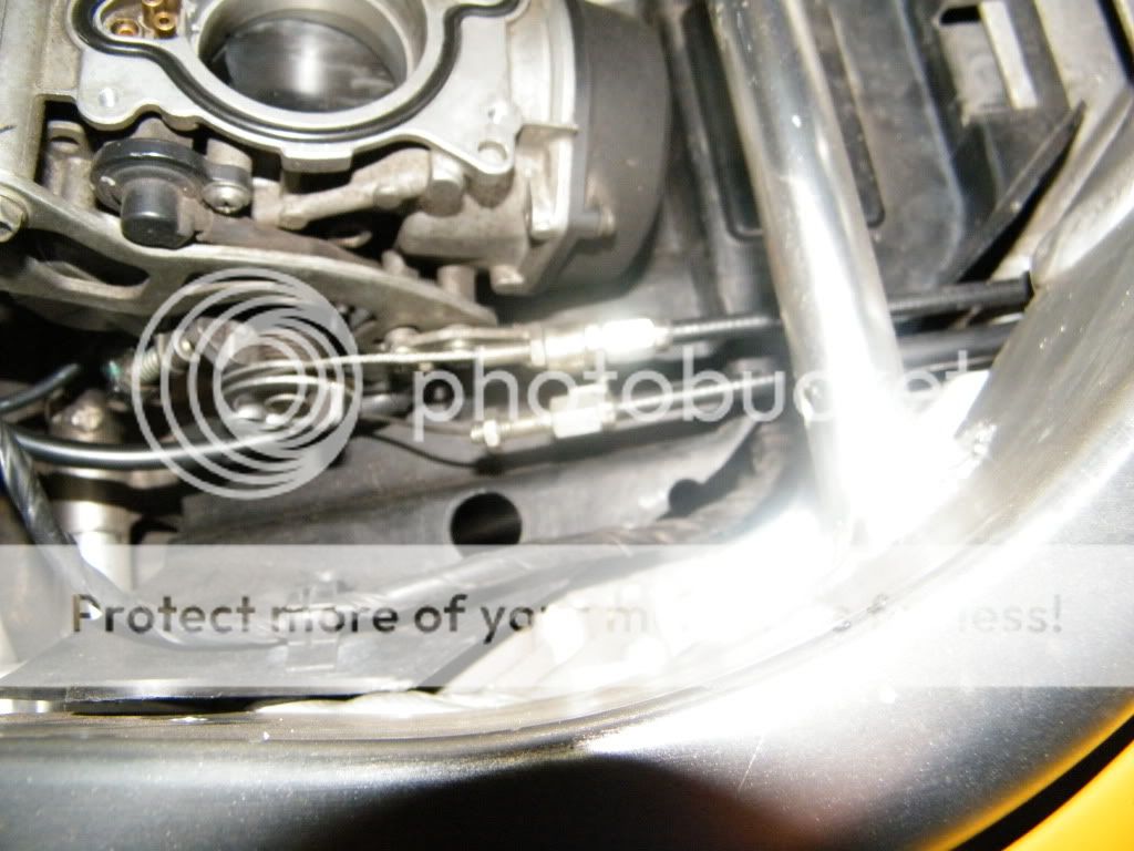

Whilst out with Jay Recoil aka The Gentleman Coder, my throttle came loose, in panic we set off home due to fear of cable snapping, turns out it was this.
https://i907.photobucket.com/albums/ac278/IXITUGIXI/DSCF0108.jpg
https://i907.photobucket.com/albums/ac278/IXITUGIXI/DSCF0111.jpg
Well due to lack of light and tools pissing me off i left the carbs loose, this will help me when i come to remove them fully, but i need to drain my coolant before i venture further.

Well when i retired the bike was bearly stripped so i started to remove the tank as it was genuinly pissing me off being in the way.
I undid the centre pin/hinge and removed the fuel pipes etc, as i'd previously turned the fuel off all was fine no spills.

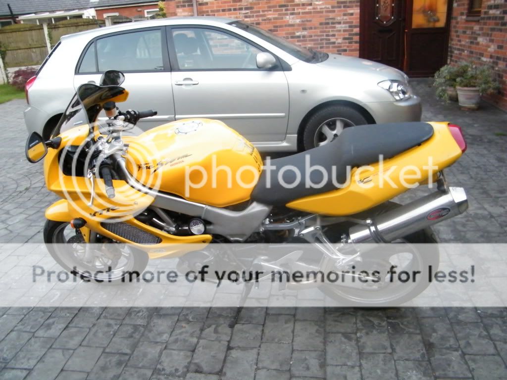

https://i907.photobucket.com/albums/ac278/IXITUGIXI/DSCF0114.jpg
I just thought i'd show the beetle for anyone who's into them, not mine though.

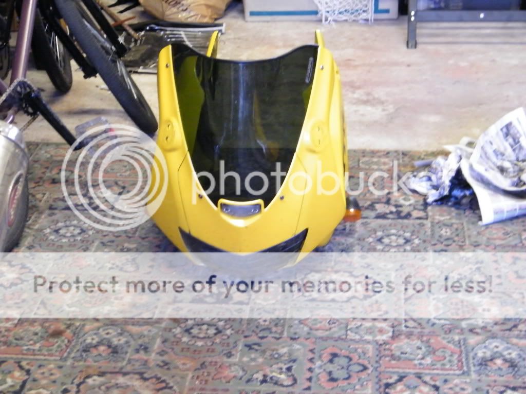

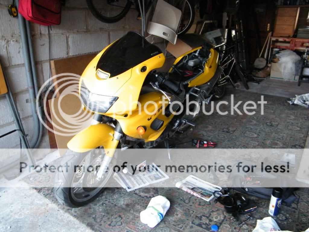

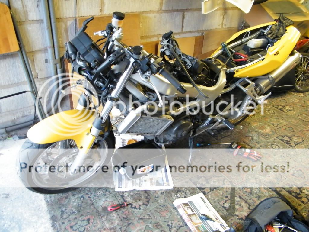

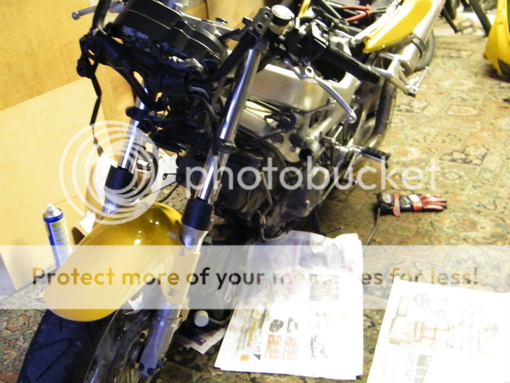

Now to Remove all the front fairing, its simple to do, remove the mirrors, then remove the 4 fairing screws and then under the Rads there will be 2 plastic clips, remove them too.
https://i907.photobucket.com/albums/ac278/IXITUGIXI/DSCF0116.jpg
Then remove, the headlight assy will come with it, be careful not to flex it too much or you'll snap it, but trust me, theres 2 screws under the front section you can remove for move room.
https://i907.photobucket.com/albums/ac278/IXITUGIXI/DSCF0118.jpg
You should be left with this now.
https://i907.photobucket.com/albums/ac278/IXITUGIXI/DSCF0117.jpg

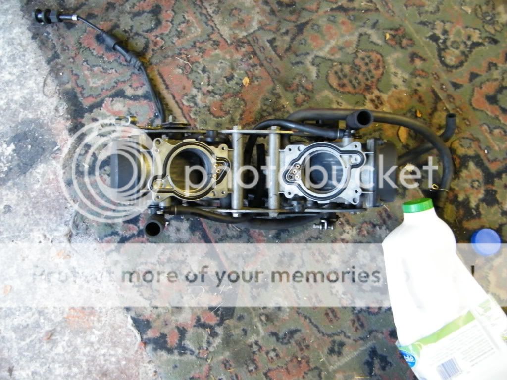

Now for the carbs to be removed. The carbs are heated, so full of coolant, i undid the bolt at the front of the bike under the front cylinders exhaust, you'll see it. It very stupidly placed imo.
Remove the bolt, it will drip once or twice before air lock. Put a nice big catch tray under the front, the spread of the coolant is stupid, it will hit your front wheel when you remove the radiator cap. Once all done you can remove the carbs without fear.
https://i907.photobucket.com/albums/ac278/IXITUGIXI/DSCF0119.jpg
Heres the carbs.
https://i907.photobucket.com/albums/ac278/IXITUGIXI/DSCF0120.jpg

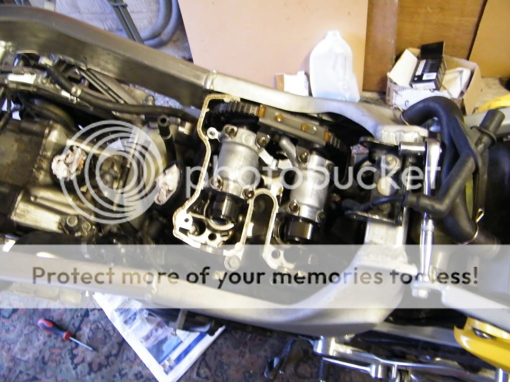

Remove the 4 10mm bolts and carefully remove the cam cover.
https://i907.photobucket.com/albums/ac278/IXITUGIXI/DSCF0125.jpg
You dont need to replace the gasket unless its broken or cracking or severly damaged, smear some silicone (a thin thin layer) on it to reseal should you be scared. Make sure the sealing lips are clean on re-installation.

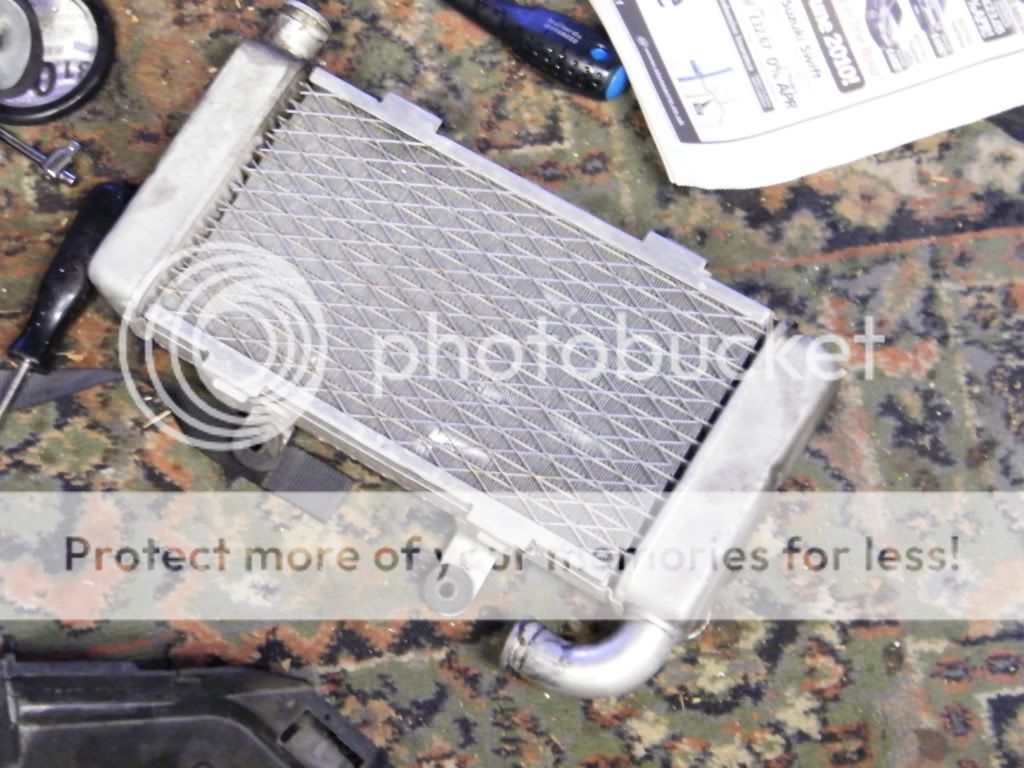

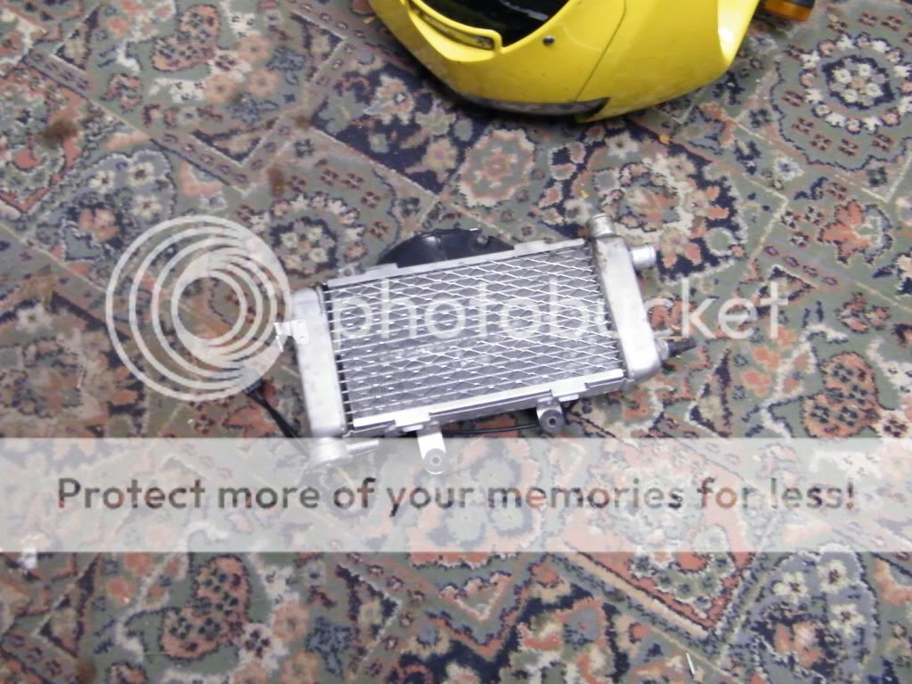

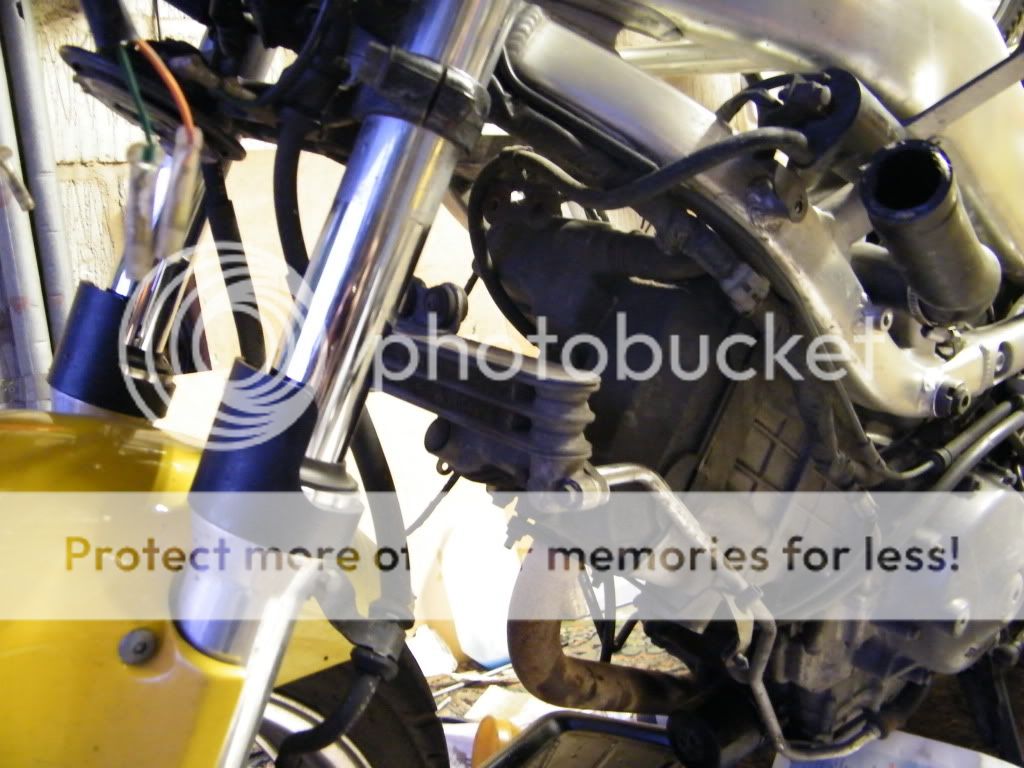

To get the front off is a bit more tricky, First you need to remove the radiators, and the pipes. I was going to do this anyway as i wanted to spray them and the HT lead holder with the fairing brackets as they were getting all brown and furry.
So left one first.
https://i907.photobucket.com/albums/ac278/IXITUGIXI/DSCF0128.jpg
For the right hand one you just need to remove some wires and it will pull right off. TOP TIP: hoses get tight on Rads, to get them off easy, get the hose off slightly using a screw driver, and spray some wd-40 in and move it around slightly, the more care you employ the less damage you will do to the pipe and 'Rad spout.
https://i907.photobucket.com/albums/ac278/IXITUGIXI/DSCF0129.jpg
So here you go, this is what it should look like now.
https://i907.photobucket.com/albums/ac278/IXITUGIXI/DSCF0130.jpg
You need to undo the Oil cooler and lower it down, i put a glove between my mudguard and the cooler to stop it scuffing. I had to remove the brackets to lower it further, if you look closer wou can see it resting on them.

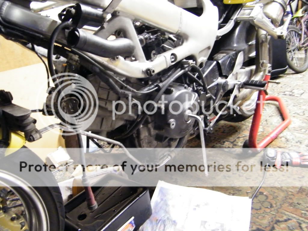

To remove the front cam cover without damage you need to remove the HT lead holder like i mentioned, you can see it in this pic, theres 2 8mm heads with heavy corrosion that you'll see, i plan to swap these for some high tens s/s ones at some point.
When the cam cover is off, its time to get to your crank to turn the bike over via inspection covers like the one with my allen key hanging out off. TOP TIP: If you feel its not budging and scared you might round it off, stop, you need to shock it, keep your allen key in and hit it with a hammer with it centered. This will now make the cover come loose with ease.
https://i907.photobucket.com/albums/ac278/IXITUGIXI/DSCF0132.jpg
More to come, i've gotta get out my room its too hot to keep typing this out. I took the front cams out and such so watch this space.
