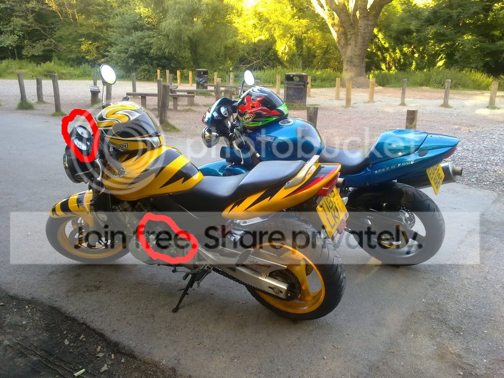

PostPosted: 23:03 - 11 May 2010    Post subject: Reply with quote
Paxovasa wrote:
Is it an electronic speedo? As it will not read correct if you do put front sprocket with one less tooth on it.
Crap the fact it is electric has nothing to do with it.
The Speed Four is electric and that reads off the front wheel, my mates Hornet is analogue and I believe that runs off of the front sprocket.
It depends on where the speedo sensor is, if you see a cable that isn't a brake line going to the front wheel then it is probably read from the front wheel and down gearing will not matter, if not the easiest way to tell (working it out) is to get the rear wheel off of the ground start the bike and put it in gear get the rear spinning. If the speedo changes then your speedo will read off rear sprocket and it will under read if you downgear.
Edit
Analogue Hornet with cable to the Rear Sprocket,
https://img.photobucket.com/albums/v295/chris-red/03072009012-1.jpg
Speed Four with front mounted speed Sensor
https://img.photobucket.com/albums/v295/chris-red/2582_60021258475_512803475_1488255_.jpg
https://img.photobucket.com/albums/v295/chris-red/2582_59534148475_512803475_1482239_.jpg
