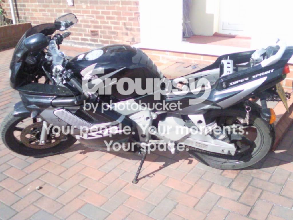

Right I have an NSR125 it's a fox eye model and a Y reg. It's a gray import from France.
Heres a pic of how it sort of is now.
https://i698.photobucket.com/albums/vv345/carl_steveo/Bike.jpg

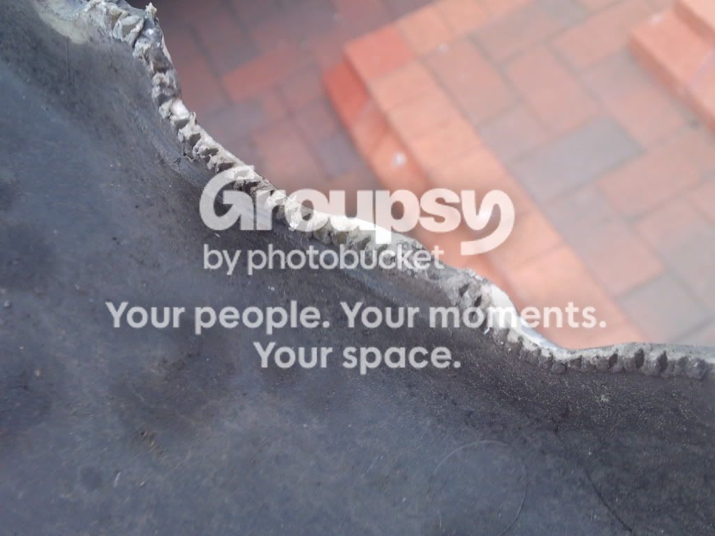

The front mudguard was reversed into and has smashed at the end. I'm a little bit worried that this might make it fail the MOT. So my original thought was to just sand/saw the end down so it was smooth and they wouldn't notice.
The front that is broke.

I took the guard off and noticed that at the bit where it screws to the forks on one side is smashed and looks like its already been bodged. It looks like somebody has heated it up and stabbed it with a screw driver on to create something to melt a cable tie to.

If you just want to bodge the mudguard up then get a some fibreglass and resin and use that (Halfords sell it). Cut off the jagged bits at the front of it and clean the edge up.

The mudguard thing, if I was to sand it smooth and it looked normal would that pass the MOT even though its missing like 2CM's.
Should be fine. It is required to brace the forks, but beyond that it should be fine. Just that it broken the tester might fail it for being sharp (ie, could cut pedestrians).

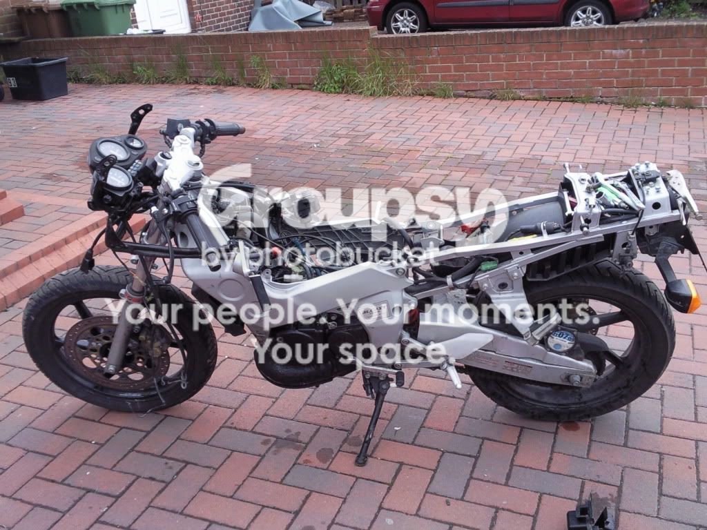

Todays plan was to make the bike look like this.
https://i698.photobucket.com/albums/vv345/carl_steveo/Naked.jpg
I did it. Anyway.
I took my first petrol tank off today without any help. Yey go me.

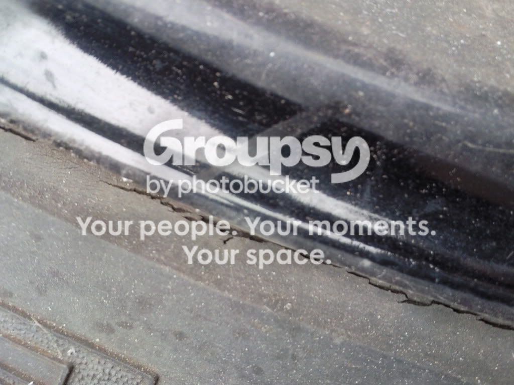

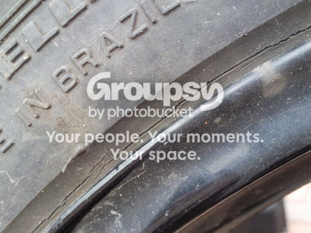

I tried the bodged clutch cable and it works great. So i'm happy with that. Couldn't find anything too bad. Until I found this.
https://i698.photobucket.com/albums/vv345/carl_steveo/Tyrecrack.jpg
https://i698.photobucket.com/albums/vv345/carl_steveo/Tyrecrack2.jpg
They are going to have to go. Sad

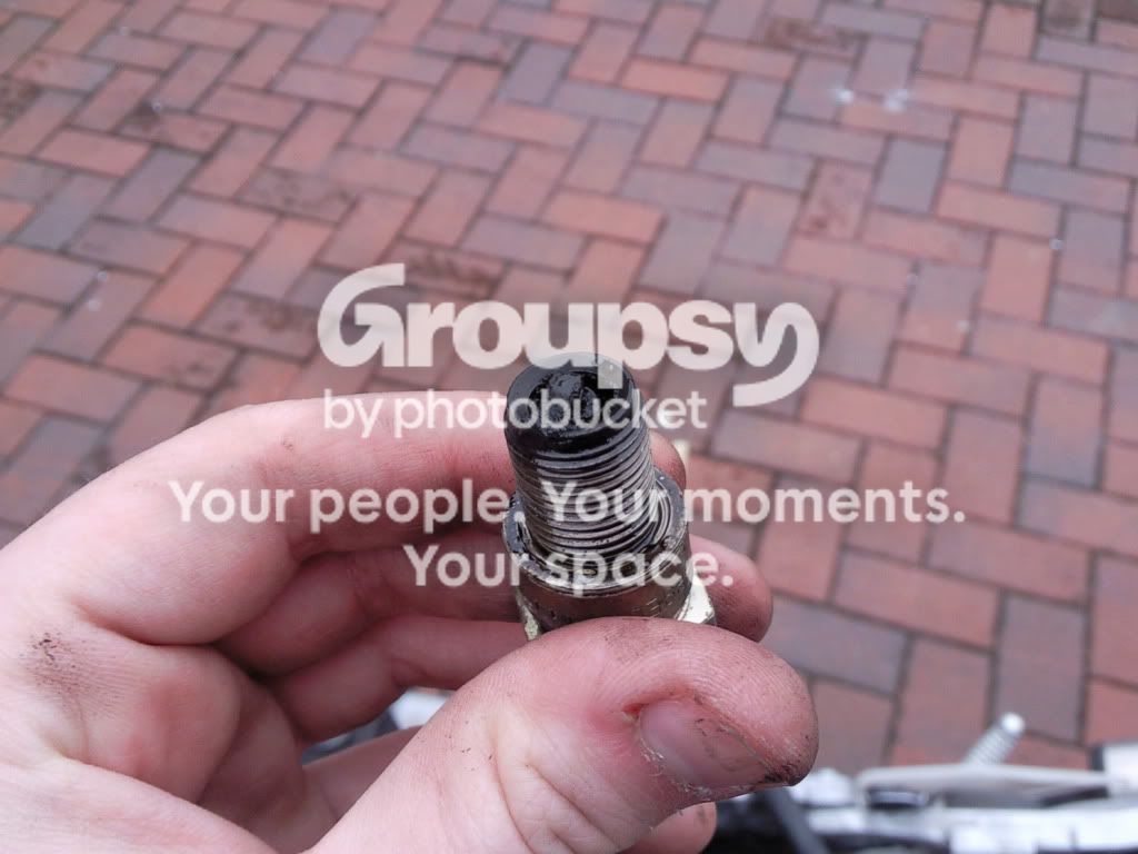

This doesn't look good either.
https://i698.photobucket.com/albums/vv345/carl_steveo/Sparkplug.jpg

Right me and Hadies off here had a craic at it tonight.
I found that the radiator had a load of play on it and twisted side to side. I had a look behind it and the bottom mountings for it had come off the rubbers, one was sitting on the mounting peg and one was off it completely. We sorted that and it's now as solid as a rock.
Got the bike back together and filled with petrol and jumped it. Even with a dead battery it started first time with a jump and I took off. It feels awesome. Theres no vibrating any more so thats fixed. Also Hadies has sold me (well haven't paid yet) some newish tyres that look to be in awesome nick. So just gotta get them onto it and it's ready for an MOT.
Well happy.

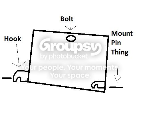

I think it was the radiator yeah. I've done a quick blast on it (on private roads officer) and there's no vibration at all and it's feeling great. You can see on the frame where the radiator has been hitting it over and over again.
The radiator is attached to the bike by three points. A bolt at the top in the middle and then two hook type things.
https://i698.photobucket.com/albums/vv345/carl_steveo/Radiator.jpg
Excuse the crap paint diagram. The hooks at the bottom on either side have circular rubbers in them that slide onto the mount pin things. The hooks then sit ontop of the circular rubbers. It's a tight fit though. I think when the bike went over its knocked the radiator off the mounts meaning to was all over the place.
I won't know properly untill I get a full run out through all the gears and speed etc etc.

So could I do the MOT without mirrors or a front mudguard. Does the NSR mudguard brace the forks.

It's not a bracket it's just 2 holes in the side of the mudguard. But where the holes are has snapped off.
Either buy a new mudguard, or smooth it down and add massive washers to keep it in place for the MOT..
My CLR125 failed the mot for no mudguard.

The front is cracked but I can sand that down to a smooth curve. It's the side part where it mounts that I'm a little bit worried about. I could bodge it and probablys will. It's not noticeable from the side, I didn't even know it was there until I took it off. The mudguard was solid aswell because it only just fits in. Might have to do some plastic bodge today.
