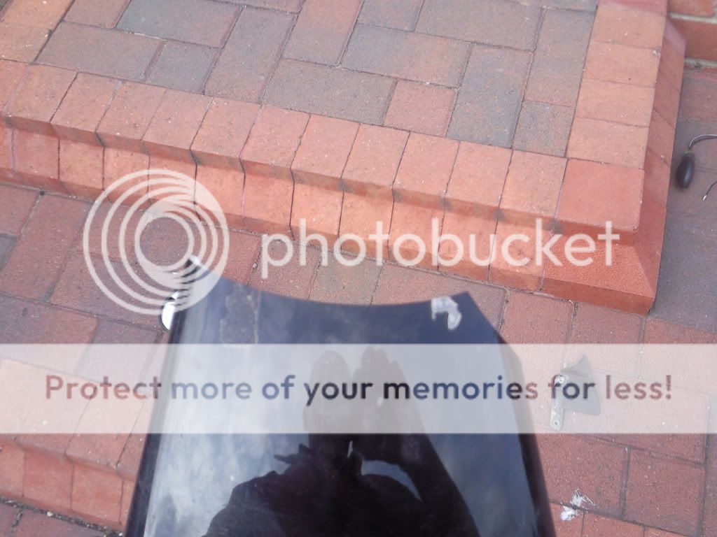

I've done the front today actually. Heres some pics to explain.
https://i698.photobucket.com/albums/vv345/carl_steveo/Frontofguard.jpg
Thats the front. I've now sanded that down to a rounded edge that isn't sharp. It isn't perfect but it's a huge improvement.
https://i698.photobucket.com/albums/vv345/carl_steveo/normalside.jpg
Thats how the side should look.
https://i698.photobucket.com/albums/vv345/carl_steveo/Brokeside.jpg
This is how the side looks.
When you put it on the bike though it goes back together because of the clip thing. I just don't want to fail over something daft. If you look at the first picture you can see the portion missing on the floor in the background.

JacPowell
Joined: 04 May 2010
PostPosted: 00:26 - 15 May 2010    Post subject: Reply with quote
What id do is just sand down all the rough edges so there smooth, then with the broken bracket id use a large flat washer so it spreads the tension better through the mudguard therefore making it more stable. With it been a 125 the most he's likely to do is just wobble it a bit like they do with your exhausts just to make sure its stable. You should be fine mate.
