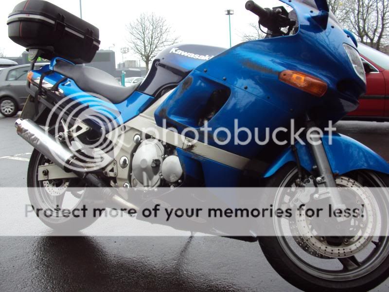

Hi.
I was wondering if anyone can give me some tips or just plain tell me not to bother if it will look shit.
I am wanting to get into painting plastics to sort out the damage that I have done to my bike. I guess for the 200 quid I would rather spend that money on equipment and practice rather than getting it resprayed by someone else.
Would I be able to improve things a lot quite cheaply?
This is what I have to work with. I have already bought another fairing midsection in red for 6 quid. That means if it looks worse than the panel on there then I always have the fucked panel if it looks any better.
I just want the three panels to be the same blue and try and get some stickers to put back on.
Thanks a lot for any tips.
https://i14.photobucket.com/albums/a324/david_m213/DSC00406.jpg?t=1279548644
https://i14.photobucket.com/albums/a324/david_m213/DSC00405.jpg?t=1279548666
Should I take all the red paint off of that cheap panel I have before it gets painted?
Also, do I need a really expensive compressor to do a decent job? I'm just wanting to paint it the one blue colour.
How would I go about getting the right colour?
Thanks guys! it's greatly appreciated.

I've painted quite a few plastic panels with spray cans and its quite easy to get a good finish. The biggest problem I think you'll have is finding an exact paint match, so you might have to visit Mr Halfords and have a wonder round the paint on the shelf. Alternatively they can mix if you get the paint code. Take a look at VW Techno Blue as that looks to be quite close.
Firstly, repairing the damaged farings. Sand down with coarse (80 grit) wet and dry to take the ridges off. Leave to dry and apply body filler (Go for smooth finish if available) and sand with progressively finer wet and dry, finishing off with 1200 grit. The surface should feel perfectly smooth before you paint. Spray 2 light coats of grey primer, leaving 10 mins between coats and then leave for 4 hrs to harden. Inspect the finish, it should be perfectly smooth. If not, you might need to sand and fill again. When your happy with primer coat, sand lightly with 1200 grit wet and dry and apply about 5 layers of top coat to fully cover all the grey, lightly to build the colour up. Leave 10 mins between coats and 24 hrs to harden. When your done the finish will feel rough to the touch so now for the secret bit... Take some 1200 grit wet and dry and rub soap into it. Very lightly rub over the paint just a few times to flatten the surface. Wash the paint and leave to dry, it should now feel smooth. T-Cut lightly and then apply a good coat of auto-glym polish or similar
Follow the same procedure for the new red faring but you might need to apply several more coats of primer to cover the red. Dont spray the blue until all the red has been covered.

I'd personally avoid halfords paints, the finish is not as good as other paint suppliers and the aerosol heads do not spray particularly well, often spitting out blobs. I get my paint from Auto Paint St Helens, it's cheap and they can do absolutely any colour from codes or Pantone/RGB numbers and the spray from the nozzles is fine and consistent.
You will definitely have to spend some time filling those flat sections as it looks like you've lost a fair bit of plastic and it probably won't look right after just 1 fill, it'll become obvious when you prime it after the first filler layer. Personally I also add lacquer after painting, aerosol paint is not that hard unlike proper paint and scratches and marks more easily so the lacquer adds some more depth to polish out any marks you get in it over time.

1200 grit is too smooth. If you completely flat the primer the paint has nothing to bond to and the colour will come off too easily.
T cut is like using 4000 grit, again too fine and it leaves behind a residue that must be washed off, and water is a major major pain in the ass when spraying.
I second this. Sanding down that plastic will just make it furr up, using body filler is the best way to do. You can use coarse grit (80-120) to shape the filler before you start to prep it for primer. It will look perfect, you will give it a coat of primer and it will look bollocks, so keep going till its okay. Remember paint doesn't hide problems, it exaggerates them.

Rubbing compound shouldn't be used between sprayings of primer.
The goal is to get the right shape with filler, spraying primer on makes the colour more uniform allowing you to see imperfections more easily.
Next you want primer covering everything with a completely even surface. Sanding at the primer can get rid of tiny imperfections, but won't cover up a shitty job with the filler.
You want to spray the colour onto an even and slightly rough surface, probably something done with about 600-800 grit, any lower and scratches will be visible, and higher and the paint won't stick. Using T-cut, or rubbing compound at this stage leave the primer too smooth for the paint to stick. Anything that leave behind a residue such as water will also fuck up the paint.
Once it's coloured (doesn't need much colour) you can fix any tiny tiny imperfections before lacquering. Dribbles and runs in the lacquer should be avoided, and left well alone if they occur. Once the lacquer has fully hardened they can be sanded out and then the lacquer polished.
