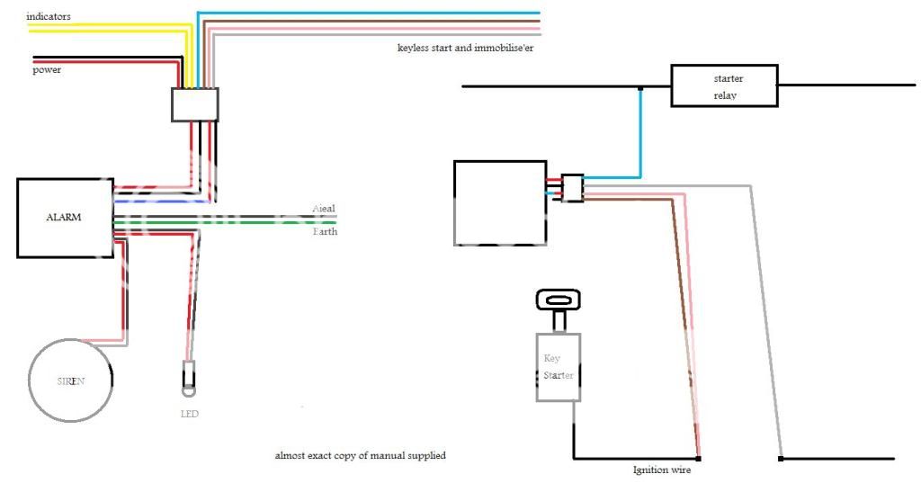

i got my cyclone V2 yesterday and spent a nice 3 houres fitting it just to the power and indicators what i was wondering was if i wire in the imobiliser/keyless start part of it, Say the alarm messes up and i have to disconnect the power to it will i still be able to start the bike?
look at my lovelly diagram

you can wire in the keyless start and the bike will still start if the alarm dies, but if you wire in the immobiliser and the unit fails you will have to reconnect the wires you cut for the immobiliser..... if that makes sense :s

i have no idea wich cabel is the immobilser the manual sent with it is basiclly a paint diagram with some words just tellimg me to wire it like in the picture but the webbie did say the immobiliser was optional

yes the immobiliser is optional as is the keyless start, i think its the grey and pink wires from the unit that do the immobilising bit.
the base functions will just be motion sensor and indicator flashes so for that you just connect the power from the battery and the appropriate wires to the indicators. Or if you dont want to tap into any wires at all and just have it as motion sensor then just connect the power supply.

If the alarm messes up disconnect the battery. It resets the alarm.
And yes, it does mess up sometimes. (happened to me twice)
I wouldn't cut bike's wires for a useless immobiliser. Just hook up the indicators and power.
