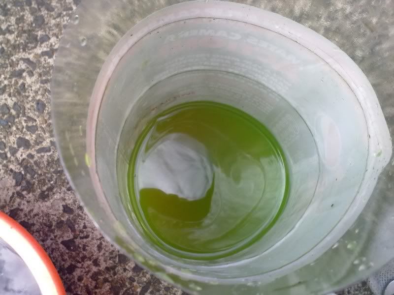

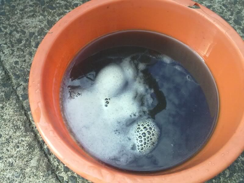

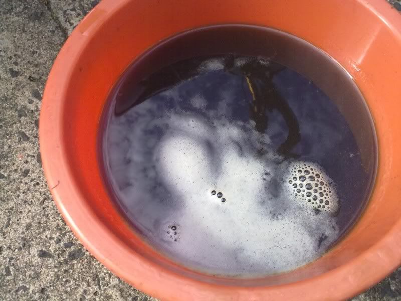

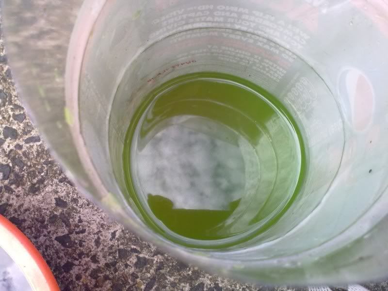

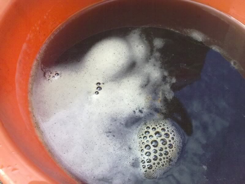

Just phoned yamaha and they want £17 just for the RHS seal Laughing but he say's if that was broke the bike wouldn't be idling properly aswell as being really smokey yet it's neither! (just passed it's mot aswell Very Happy )
The coolant looks a little bit dark and there is a tiny bit of white creamyness in the oil, but certainly not enough to explain .75 litre of oil going missing within 5 miles!

No, that's not jizz in the oil Wink
There's definately no external leaks anywhere (cleaned and checked sprocket shaft e.t.c.) so where the hell is my oil going ?

You should never get oil in the water. The oil is not pressurised so it can not get in there. The water is in a pressurised system so you could get water in the oil.
If you do get an oily film in the water it could be from the head or base gasket and the oil/fuel from the intake pressure. If water was getting into the crankcase the motor would probably stop due to a wet plug.
Is that bowl graduated?? How much oil came out??
Id pay little, no make the zero, attention to what the sight glass says. Its tucked away in there in that stupid spot with that spring hook on the back of the lever just begging to poke a bloomin hole in it. What a dumbarse idea.
Go buy a 4L bottle of Dextron II Automatic Transmission fluid and use that. (you know not to ue regualr car oil right?? ATF or propper 2T gearbox oil only) Measure it out and tip it in the bike. Ride the bike for say a day or a week. Drain into a container and measure. I thought my 200 was doing the same so i did that, it was all good. Got out what i put in, did it twice to be sure.
Doesnt sound like the problem anymore but still could be. Dont buy genuine Yamaha. get the Pro-X seals. Im sure they fit the blaster and they have the Viton tips on the seals because they got hot in the air cooled quad.
Yes you will need to split the cases to do the bearings, both of them.
It would probably idle bad if the crank seals were leaking. Thats right, but if its had the jetting altered to suit then it would not be so noticable. The seal could also be leaking only one way, sucking into the crankcase. Might be due to the wrong seal, or blocked breather.
You say about smoke, if your bike is jetted rich it might not smoke real bad, just dump all the oil into the exhaust. The temps are not high enough for things to be hot enough to make the oil smoke.
Go buy yourself a big plastic tub with a lid. Something big enough to put a spare air filter, filter oil etc, a couple of 4L oil containers and a few bits and bobs in. That will keep all your stuff together. The tub is mainly for the next bit, go buy a graduated measuring jug and a small funnel. (or pinch one from the kitchen, could get you in strife) Use it. Keep it in the tub and dust will not be alble to stick to the oil film. I usually wipe mine with a rag then stuff the rag in it then into the tub. Measure your 750ml in the jug, then with a funnel into the motor. Best thing is, all your stuff for you bike is in that tub and you know where it is all the time. If your running low on something you wil know.

When i first filled it up it took about 500mls but i then topped it up after a ride round the block and it took another 200mls. Then after another ride it took another 100mls (give or take X mls that i dropped on the floor through not catching it in time)
When i emptied it into the above bowl i then filled it back into the empty oil bottle (75/90 i think 2t box oil) it showed around 700mls.
It's still showing nothing in the sight glass but emptying it back into the bottle shows it at roughly 700mls, which is exactly how much the owners manual say's it needs...
So maybe it's not burning it at all! Something is not right though...
