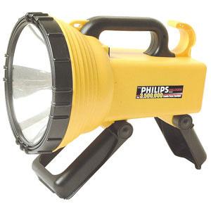

PostPosted: 14:28 - 07 Jul 2010    Post subject: Reply with quote
https://www.slips.co.uk/images/super/NightTracker.jpg
https://www.connevans.co.uk/store/images/853501ecb.gif

Must say I'm liking the carrots & high powered torch ideas Laughing probably got a wind-up LED job somewhere that would do the trick. Could mount it right on top of the front wheel and have it wound up that way like an old dynamo.
