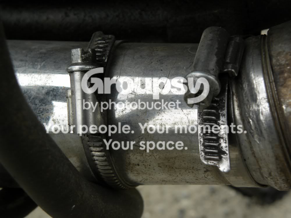

Gun Gum & jubilee clip(s) is the way to go. Clean round the hole, apply Gun Gun, wait till it's almost hard then add jubilee clip and tighten (but not fully). The almost set Gun Gum is squeezed into the hole and sets there, giving a good seal. Tighten fully (but don't overdo it, as that may enlarge the hole) once the GG is fully hardened. Use stainless clips as the standard steel one tend to rust and seize up, as they're exposed to all the crap and weather down there.
My pipe has been fixed using this method for a while and passed three MOTs like it:
https://i219.photobucket.com/albums/cc223/Funkdooby_album/Dscn0587.jpg
There's a fairly large hole either side of the notorious bracket that bolts to the frame. Never yet had a downpipe rust through though, oddly.
