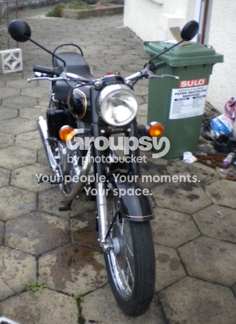

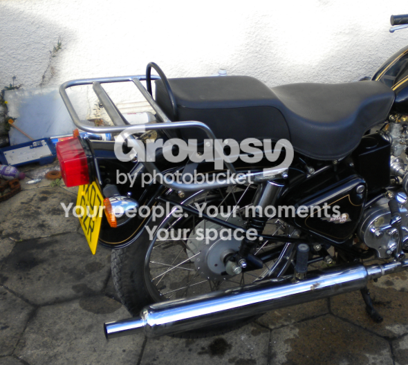

I'm going to take a sabbatical next summer with the intention of doing the complete Round Britain Rally in a oner. This being a good way to see all of the UK.
I decided that if I used my VFR, it would be too tempting to blast along the motorways so I decided to look out for a Brit bike so I'll take my time and go the long way.
I considered getting a proper old brit but decided it would be too difficult to source parts in case of the inevitable breakdowns/bits falling off etc.
Next best thing seemed to be a Royal Enfield. Essentially an old brit bike still being made in India. Still likely to break down and have bits fall off but there is an extensive dealer network and the parts you get are new, not someone elses worn out castoffs or shonky reproductions for show bikes.
Went to look at some. The current model is a 500 Electra EFI. It is still in an older style but has fuel injection, electric start and a unit construction engine.
Last year was the last time they imported the 350 bullet. It's considerably slower and had a 4-speed pre-unit gearbox, right hand gearshift, carburettor, points ignition and kick start. Altogether more authentic to my mind.
In one dealers I saw a second hand bullet. 3,000 miles on it, 07 plate going for £1700. I decided to buy it now because the price is right, I had been looking at new, old stock going for £3,500.
Had my first go on it today. Starting is a piece of piss, up to compression, knock it over compression on the valve lifter, swing it over once and away it goes. Less effort to start than my Jawa 2-stroke.
Riding position is bolt upright, thighs and forearms paralell to the ground. An extremely comfortable way to sit over long distances.
It pulls away cleanly but in an unhurried manner, you don't really feel like thrashing it, it's too civilised for that. Gear shifting will take a bit of getting used to. It's on the right hand side, one up and three down with the handy addition of a seperate "neutral finder" lever. If you're in 2nd, 3rd or 4th, press this lever and you're back in neutral.
The gearbox is very basic and clunky, you have to get the revs right to shift cleanly and you have to pull the clutch in all the way. No snicking up through the box, every change has to be done as a seperate action with decisiveness or you hit one of the many false neutrals.
Handling is actually pretty good, especially considering it is on avon Speedmaster tyres, the rear of which has a totally square cross section. Certainly adequate for the speeds the bike will do.
The brakes are drums. Twin leading on the front. Again, nothing like you'd get on a modern bike but better than I'd been expecting. They do actually slow you down somewhat when applied.
Overall a satisfying ride. It tops out in the region of 60-65mph but pulls well up hills. You're sat up, enjoying the world go sedately by and paying attention to all the little noises of the bike, making small throttle adjustments so it sounds like it's running well.
People wave to you as you go past, it's a bit like being in a time-warp, or the intro sequence to Heartbeat.
I had a wee tinker with it as well. It is fitted with an emissions control system which lets air into the exhaust on the induction stroke, diluting the pollutants. Pointless, extra pipework and a big valve taking up half the toolbox. Simple to disconnect then fit a blanking screw on the exhaust and carb manifold .
I also changed the oil. Something of a fiddle because it has a dry sump (oil is pumped round the engine from a seperate tank). You remove three drain screws from the crankcase, timeing case and oil tank. The first two have a gauze filter that you clean. You remove another cover and winkle the oil filter out (a cloth "sock" in a metal cage). Soak the new filter in oil, refit it (with new cereal packet gasket under the cover), pour 200ml of oil down into the crankcase via the tappet cover then top up the oil tank.
That's not all, the primary drive is also a seperate compartment. You drain this by removing the cover, which forcibly reminded me I need to get a bigger tray to catch the oil in. I removed this (one bolt) to tension the primary drive chain.
The gearbox is packed with grease but you top it up with oil if necessary (strange but true).
Very easy to work on for all the carry on, all parts of the engine are readily accessable although there is a very odd assortment of bolt sizes (mix of metric and imperial). I'll need to carry a lot of different spanners in the toolkit.
Overall, I'm happy with my purchase. I'm resisting the temptation to tune it up (it is in a VERY low state of tune as standard) in order to maintain reliability.

I've got a big chrome rack off one of my old bikes that just needs a couple of brackets making (tomorrows job) couple of slices off an old set of chromed handlebars ought to do the trick nicely.
You can buy reproduction army issue metal panniers for them brand new for around £50, including the racks. I'll probably get some of these and paint them black to match the bike.

Today I have been mostly making brackets for fitting a luggage rack.
https://i48.photobucket.com/albums/f216/stinkwheel/DSCN0324.png
Any tips on what spares to carry for doing an extended tour?
I'm thinking clutch cable, points, sparkplug, spare inner tube, some hylomar, a handful of nuts and bolts and of course, a bottle of oil.
