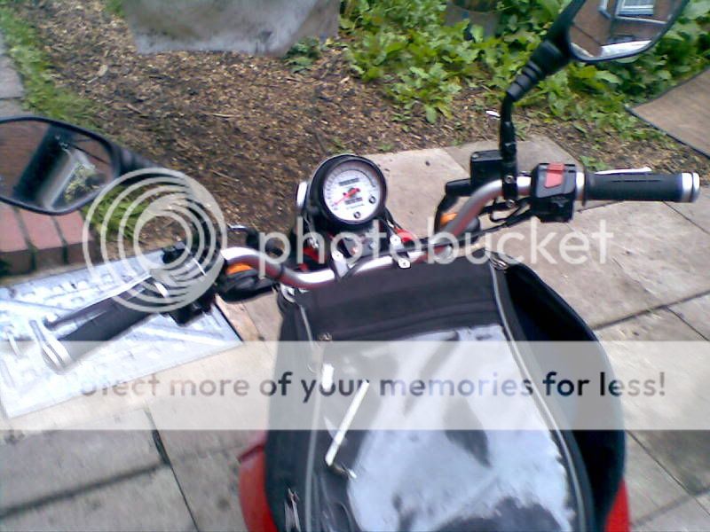

Molegrips? Pliers?
Frost
Joined: 26 May 2004
PostPosted: 16:06 - 07 Sep 2010    Post subject: Reply with quote
Reverse drill bit known as an 'easy out'. The drill bites into the metal turning it undone.
Cheapo option: cut a slot in it with a hack saw and undo with a screw driver.
Last resort: get a drill bit the width of the head and bit by bit drill the head off. Remove what it was holding on to reveal a bit of the thread that will then easily come undone as there will be no pressure on the threads caused by the head pressing on something.

Sounds like the problem i had after fitting new bars. I placed some electrical tape under the housing which stopped the movement. But then again i still had use of the bolts so could tighten it up. If you don't then you could use some cable ties along with the tape until you get something permanent?
ZRX61
Victor Meldrew
Joined: 05 Nov 2003
PostPosted: 22:39 - 10 Sep 2010    Post subject: Reply with quote
Couple of wraps of tape will take care of it.
