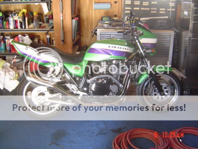

80,000+ miles & 11 years on this stainless Muzzy system...

80,000 miles without even a rusty horn!
Do you have shares in ACF50 Mr. Green ? Bike parts I can see look very tidy Thumbs Up .
LOL! One advatage of living where they don't coat the roads in salt...
https://img.photobucket.com/albums/v317/ZRX61/Vehicles/NASAWillow6-5001.jpg
