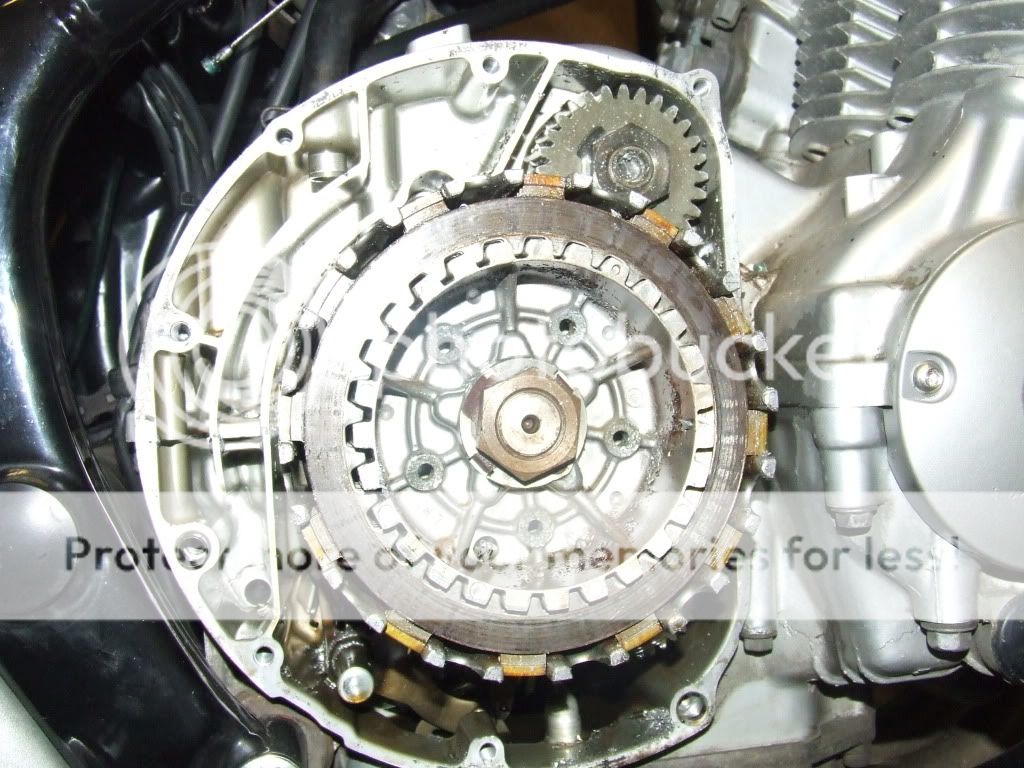

it's not looking promising...
https://i980.photobucket.com/albums/ae290/F1ymo/svr-re-run/fdbcb659.jpg
off with the cover...

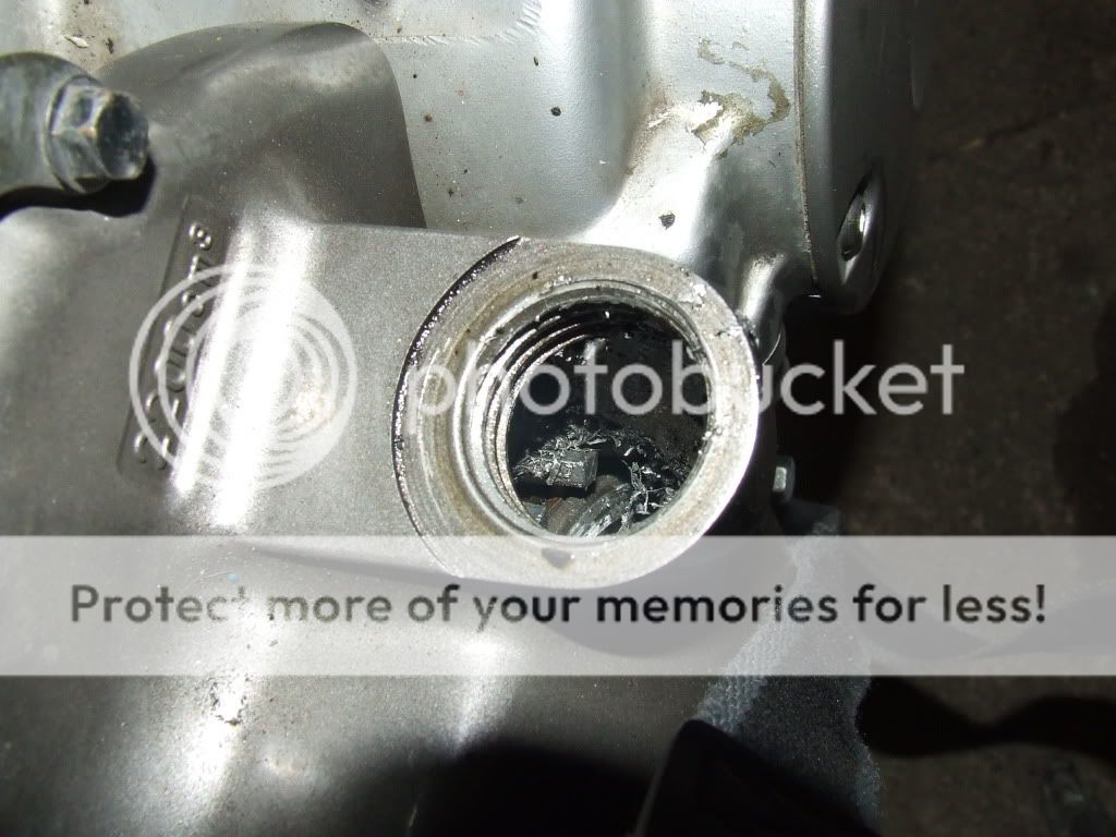

Thats not supposed to happen...
https://i980.photobucket.com/albums/ae290/F1ymo/svr-re-run/859bd397.jpg

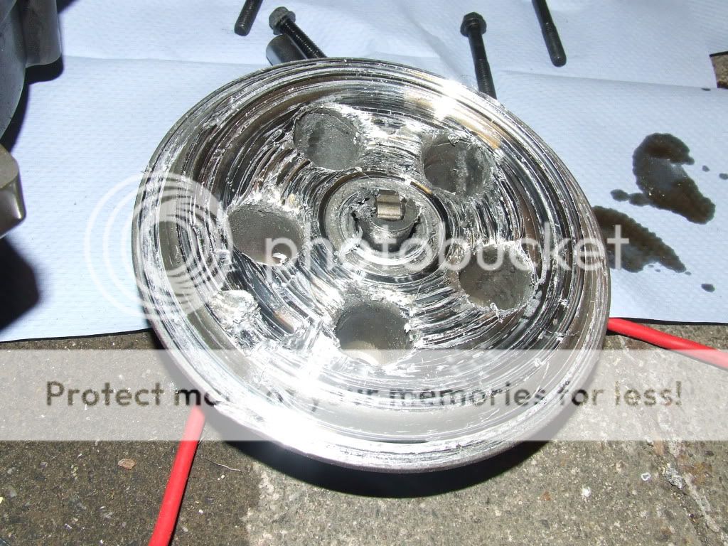

Jeez i'm quite shocked...
https://i980.photobucket.com/albums/ae290/F1ymo/svr-re-run/25b9e483.jpg

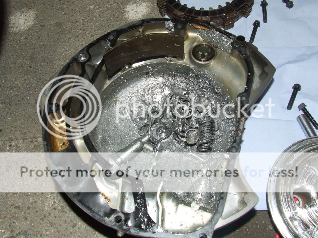

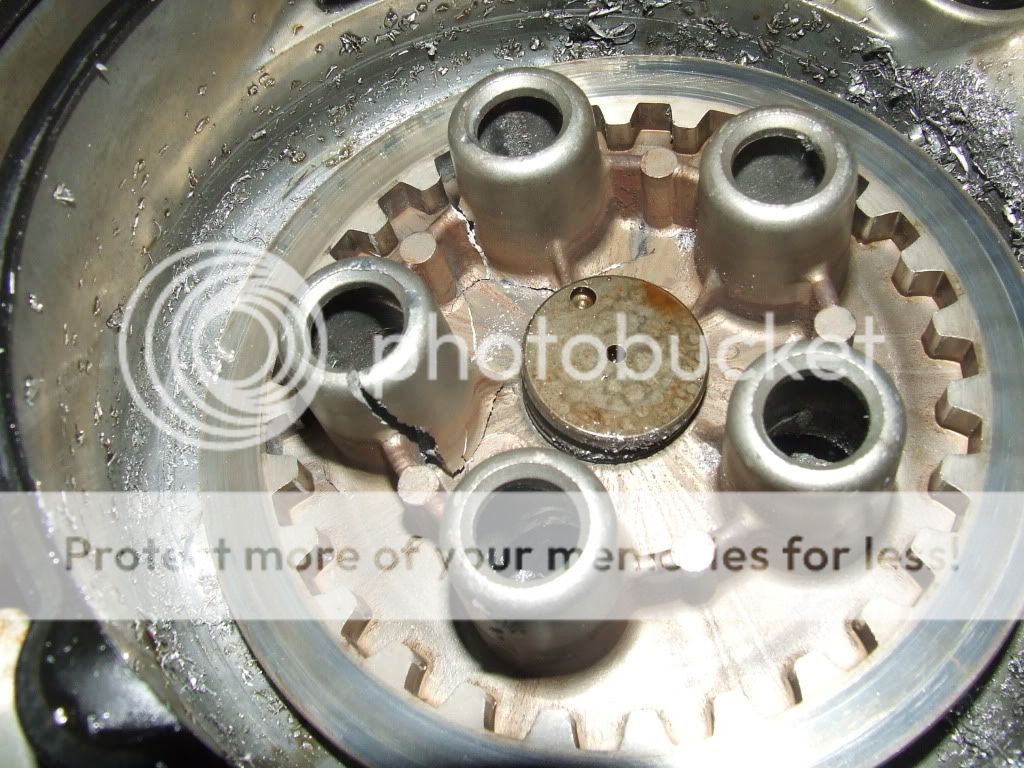

and...
https://i980.photobucket.com/albums/ae290/F1ymo/svr-re-run/82e648a3.jpg
well that put a spanner in the works... Evil or Very Mad

Absolutly no idea... first i knew about it was when i changed down a couple of gears approaching an island and gassed it as i gassed it it did a funny lurch and i carried on (i suspect the lurch was something breaking) come up to next island no clutch could not pull the lever it was probably ratytling like a good un but i had my music pretty loud Confused
so i try to downshift with out the clutch (which i'm crap at) as i slow down it lurches a bit and then locks up the rear wheel and engine dies...
i had to rock bike to get it into nuetral to push it off the road.
i imagine been alloy it only take one of the bolts to come loose to start wreaking havoc and if you don;t notice till it's too late...
maybe a spring broke releasing the pressure on a bolt and it came out ?
the 5 posts where the pressure plate bolts go are all sheered off !
oh yeah... the thrust bearing was fine Very Happy

Take the sump off and get the rest of the rubbish out.
yandy_yay
Joined: 01 Aug 2008
PostPosted: 21:10 - 27 Sep 2010    Post subject: Reply with quote
It's already off..was a fair bit of crap in there including the rest of the bigger bits i couldn't account for, the whole clutch it off at the moment, had the oil pump out and cleaned, cleaned the pickup strainer and cleaned out where the clutch should go...
