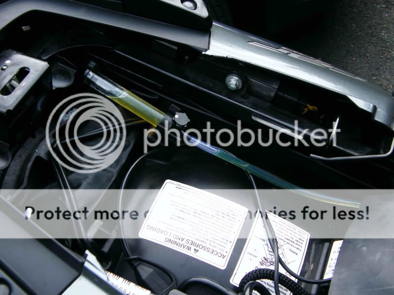

Locate oil reservoir under pillion seat panel and clip oil reservoir into one of the Honda 15mm 'D lock' retaining clips
https://i28.photobucket.com/albums/c210/Hockeystorm65/Oiler/Oiler12.jpg

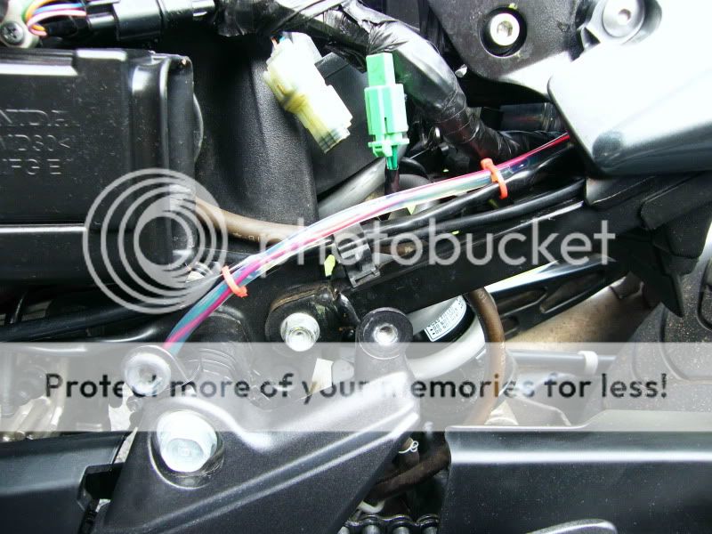

Feed tubing through under main seat
https://i28.photobucket.com/albums/c210/Hockeystorm65/Oiler/Oiler3.jpg

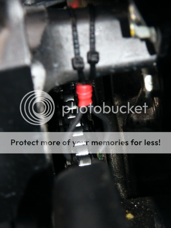

Position twin feed nozzles above chain just to the rear of the drive sprocket. These need to be adjusted first and the ends of the nozzles cut to match the width of chain and whether it is an o'ring or not. Then the nozzle feed can be attached to chassis mount using ripchord fasteners
https://i28.photobucket.com/albums/c210/Hockeystorm65/Oiler/Oiler5.jpg
The final installation needs to be callibrated for the type of oil you want to use. I used Halfords SA80/90 gear oil
https://i28.photobucket.com/albums/c210/Hockeystorm65/Oiler/Oiler7.jpg

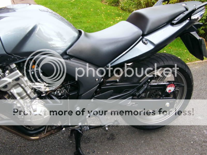

Then re-assemble, turn on the oiler and go for a blast to oil your chain! Laughing Laughing Laughing
https://i28.photobucket.com/albums/c210/Hockeystorm65/Oiler/Oiler1.jpg
Total time for installation around 45mins (including taking the pics. Not a bad Sunday afternoon project though I say so myself. Laughing
