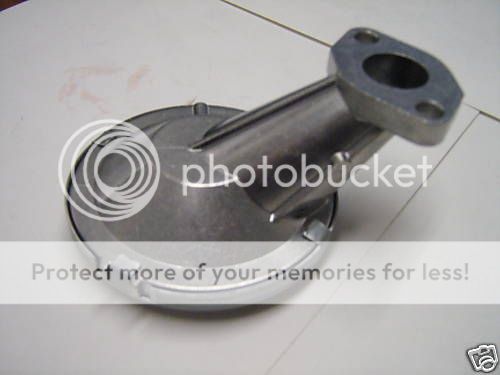

I'll show you why, this is a GPz305 oil pickup:
https://i48.photobucket.com/albums/f216/stinkwheel/305/Image025.jpg
This is a Superdream oil pickup:
https://i48.photobucket.com/albums/f216/stinkwheel/BizwjZgCGkKGrHqUOKiEEsmg93JLBLQ2YBN4_12.jpg
This is a GPZ500 oil pickup:
https://i48.photobucket.com/albums/f216/stinkwheel/900a_12.jpg

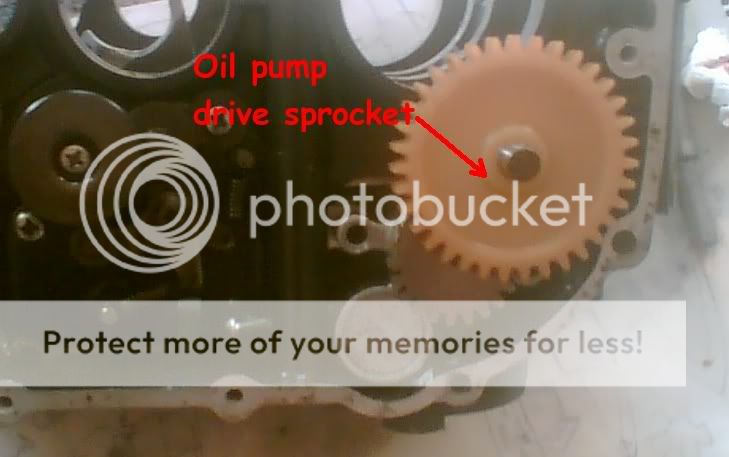

This is a GPz305 oil pump drive sprocket. It's made of plastic. Excessive load on the pump (like by having a slightly blocked or very narrow pickup at higher revs) will make the teeth break off it:
https://i48.photobucket.com/albums/f216/stinkwheel/305/Image091.jpg
Once the teeth have broken off it, in a matter of seconds, your cam will look like this:

Cheers stinkwheel, pics show the problem and shortcomings very nicely! Thumbs Up
So unless there was a way of getting steel oil pump drive gears made, and a much larger oil pick up fitted, and or uprated oil pump if the capacity is a bit small, then you could never make a 305 engine as strong as a healthy Superdream engine, and capable of the same amount of thrashing?
It is a shame as 36bhp for a 300cc air cooled twin is very good. The superdream 400's were about the same wern't they?
