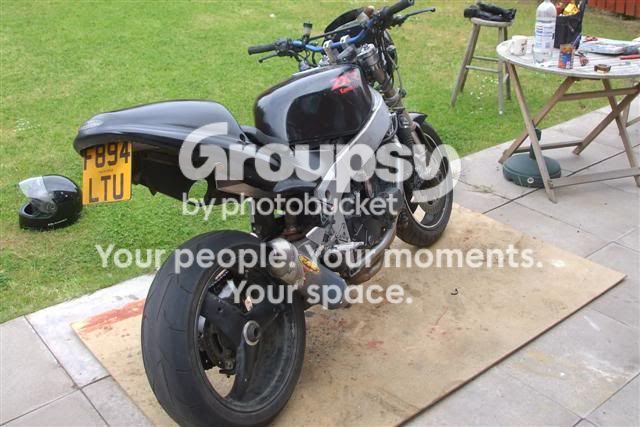

someone told me there was no way i could get a speed triple swing arm to fit a zxr750 frame, that was all the motivation i needed,
the way i see it is, you have an engine, you have a frame,
why not give it ago, you'll be no worse off than iff you never tryed,
i'd definitly give it a go,
some one put a 750 engine in a vespa, surely this'll be considerably easier Very Happy

PostPosted: 10:45 - 18 Oct 2010    Post subject: Reply with quote
Pics Thumbs Up .

PostPosted: 12:34 - 18 Oct 2010    Post subject: Reply with quote
DonnyBrago wrote:
Pics Thumbs Up .
https://i58.photobucket.com/albums/g257/hmmmnz/zxr/DSCF1025Small.jpg
https://i58.photobucket.com/albums/g257/hmmmnz/zxr/DSCF1027Small.jpg
