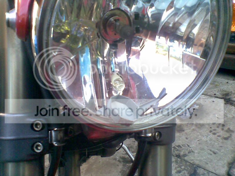

Main light intruson/broken ..
Fisty
Joined: 11 Apr 2007
PostPosted: 12:51 - 24 Oct 2010    Post subject: Reply with quote
It's the diesel filter.
Fatter and faster than Fret
iooi
Joined: 14 Jan 2007
PostPosted: 13:34 - 24 Oct 2010    Post subject: Reply with quote
Supposed to sit in front of bulb to reflect the light back to the reflector..
To get it out you need to take the whole unit off, remove the bulb and hope it will fit through the hole.
How it will effect your light is another matter. May well end up as a MOT fail on the beam pattern. Or dazzle oncoming drivers.
