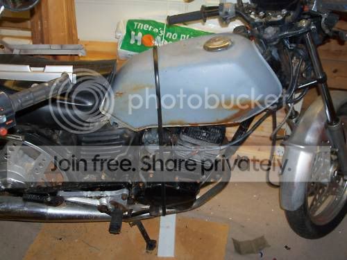

That is a Honda CB125 we bought as a project for Snowie.
Couldn't ride it when we went to get it, had no battery & flat tyres, but started up on a jump & went through gears & reved out on the centre stand. BUT got it home, the frame had been atacked with drill and angle grinder, and the carburettor was a complete mess. Tank was full of filler with holes underneath! It REALLY was fit for no more than parts, & I scrapped it & had to get her another.
https://i178.photobucket.com/albums/w269/teflons-torque/Little%20Dreams/pi678801.jpg
This is the one she's 'doing'. Sold as a runner, by bloke on behalf of his wife who'd moved onto another bike, hence neither of them had inclination to fix the fork seal it needed for an MOT.....
Knew from the photo's it needed more than just a fork seal, entire suspension needed over-hauling, & when I rode it, knew it needed at least head-stock bearings on top of that....... but complete and working, for Snowie who wanted to do a 'full' rebuild, knew we could iron out any other faults as we went along.
https://i178.photobucket.com/albums/w269/teflons-torque/Little%20Dreams/imag0768.jpg
this one, I got to do up alongside Snowie, and try and recoup something from the one we scrapped.
Seller had dug it out of some-ones shed and tried to fix it up as a daily commuter. Spent money on new battery & Ignition, seat-cover and some other odds and sods to get it through an MOT, then 1000miles later...... siezed it up!
Obviouse when I collected it, those 1000miles had stressed aged parts that had never had to work for a living, and it needed a complete tear-down as well as a new engine..... fine for me to sort, but too much for the seller who had already blown his wad on it & needed to get to and from work.....
Moral is even with a genuine seller, theres normally an AWFUL lot more in there than they know about or admit to.
Doing fixer-uppers, the chances of lucking in on a bike thats a quick and simple fix are NOT great...... do happen..... but not often.
https://i178.photobucket.com/albums/w269/teflons-torque/Little%20Dreams/XLD05_01.jpg
This one came as a 'donor' for spares only with one of the other bikes.... looked completely beyond hope, and was aparently stolen recovered, & wouldn't run.
Just for the sake, before I pulled it to bits, I put an ignition switch on it, fitted a battery, and as I couldn't be bothered to mess filling its petrol tank, swapped its tank with one off another bike......
started about third prod! Turned out that only real fault was a clogged fuel-tap, and unsuccessfuly hot-wired ignition!
Still a lot of work to make it streetable, but made me grin like a cheshire cat.....
