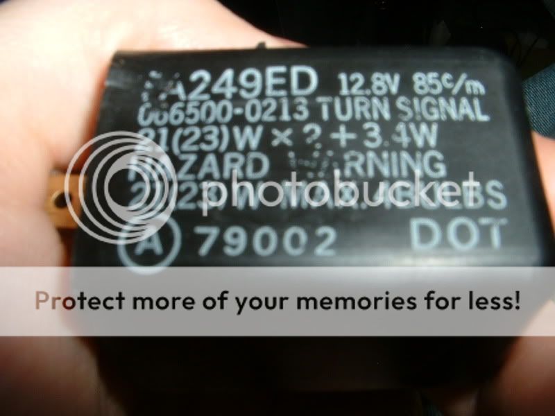

My loom has all 3 pins and the relay is a 2 pin...(not that it should make any difference unless the 3 pinners are electronic rather than hotwire...meaning it should be less fussy about the loads?)
Have seen on EX500.com a picture of an "American relay" and it does say 4x 21 (23W)
Will see if it will link OK...
https://i205.photobucket.com/albums/bb210/Triple88A/EX500/Lighting/DSCF0003.jpg
Looks like I need a less "fussy" relay then??
