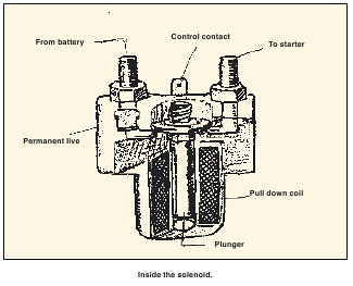

the smartest thing to do is put it back to the normal push button start, if the monkey who originally did the wiring had a clue then he wouldnt have disabled the normal start button, he would have just wired the remote start in parallel to it,
i don't know how far to go into this, first the starter solenoid /relay
it is essentially one big switch operated from somewhere else (start button, remote starter etc) and has a feed directly from the battery and one large cable going to the starter motor, to control the relay you need to "energise the coil" which in effect closes the switch
https://static.flickr.com/2262/2098020147_aa3b641136.jpg
to me it sounds like your starter relay solenoid is fucked, and the internal contacts have corroded and are no longer letting the electricity through
i would buy a new starter relay, by putting a screw driver across the contacts you are essentially bypassing the the relay,
buy one from ebay, it doesnt have to be specific to your bike it can be from anything, even a car
here or just search your self here or go to halfords and buy one (i think they stock them??)
