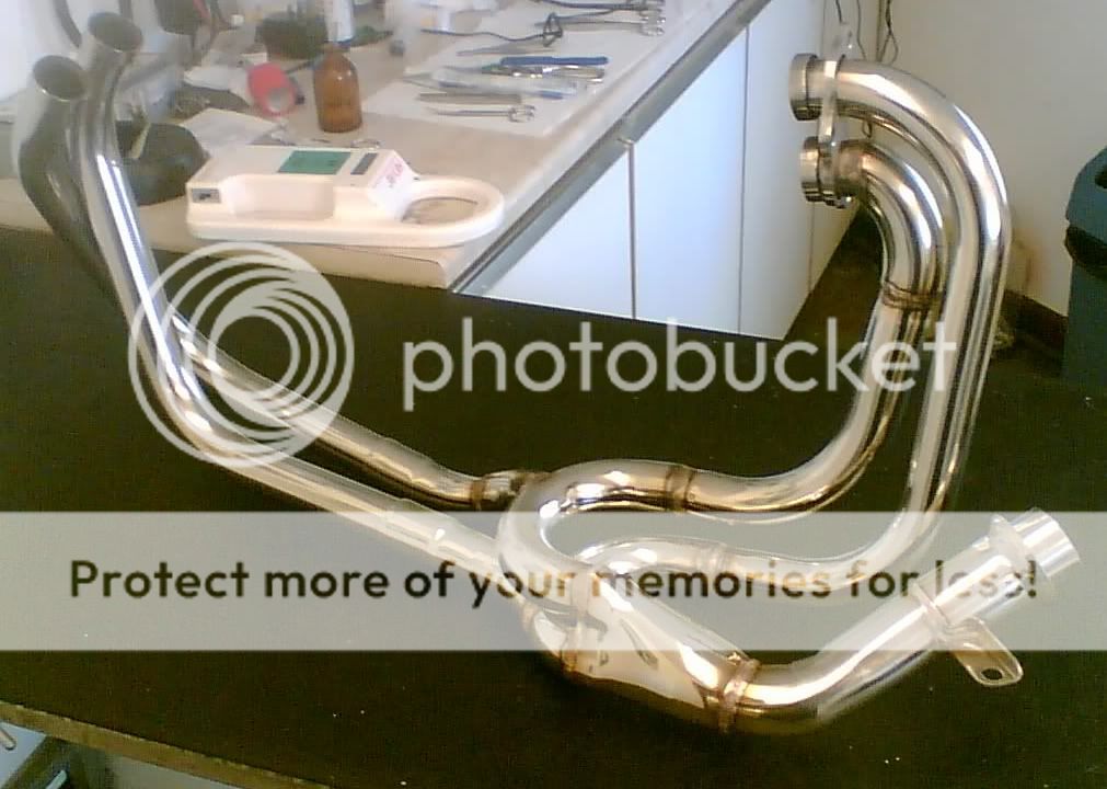

PostPosted: 16:56 - 11 Nov 2010    Post subject: Reply with quote
White ones are inexplicably popular with the VFR owners. I suspect they are all closet police bikers or something.
I'll see if I can find my workshop manual when i get home, ought to tell me if you need to drop the engine, I seriously doubt it though.
They would usually rot through at the splitter box, which as as complex a bit of pipebending as you could hope to see on a motorbike. This is my pattern one from sandy bike spares.
https://i48.photobucket.com/albums/f216/stinkwheel/sexyzorst.jpg
I bet you'd get a SS swingarm one for £1500 these days. That said. The only real advantage of the SS swingarm is the ability to quickly and easily change the rear wheel and removal of the need to meticulously set the wheel alignment. Something they totally screwed up by then fitting the silencer across the side of it meaning you have to move the exhaust to get it out. The standard swingarm is lighter, more rigid and easier to service if it goes wrong.
Mine has a high level pipe and I'm going to the bike shop to have a new tyre fitted tomorrow. I'll have the wheel off the bike before he has the plastic wrapping off the new tyre.

I've looked on ebay at the older style exhausts, they are pretty much the same as my old standard one, just have a pressed-steel collector box like you'd get on a car instead of the pipes being welded together into a splitter. The important thing is they have the same manifold arrangement on the rear cylinders and have seperate front headers. All of which means I can see no reason why the engine would have to come out to fit it, nor the radiator removed.
It is almost certainly the collector box that's rotted.
You can actually remove the front headers with the plastics on. I know because I have done so in the past.
