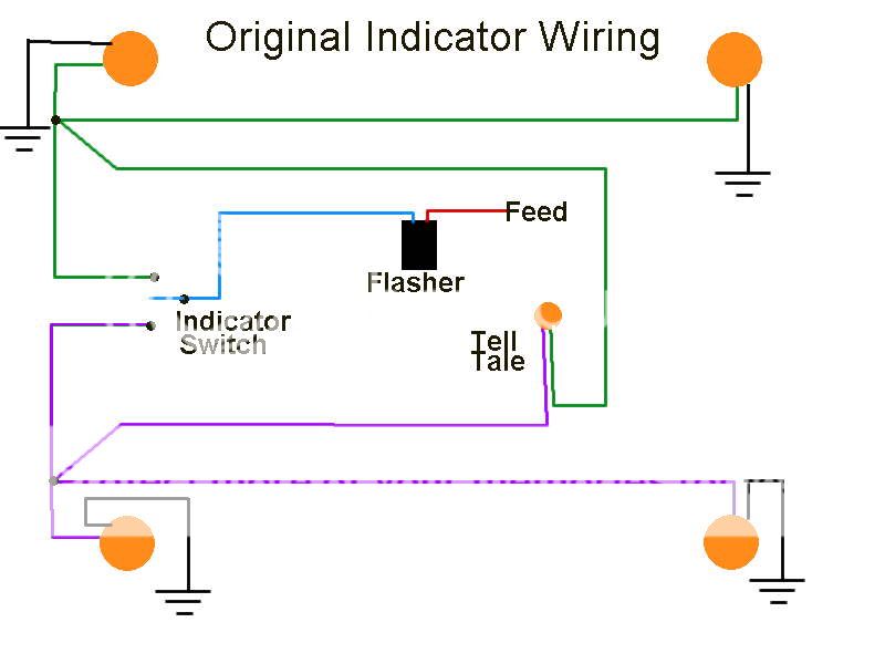

Tracing the tell-tale wiring revealed the problem.
The Tell-Tale has NO earth!
It has two wires, one to each terminal of the tell-tale bulb. One is connected to the left indicators in parallel, one to the right, also in parallel.
With tungsten filliment bulbs, when you indicate left, puts volts on the left hand terminal, current flow through the bulb, and earth through the right hand indicator bulbs.... when you indicate right, puts volts on the right hand terminal, current flows from right to left and earths through the left hand indicators.
Current draw is small, and the voltage drop accross the bulb large enough that the 'off' side indicators that the bulb is earthing through, dont light up.
Until you fit LED bulbs!
And two things happen. First, the LED is directional, so only allows current to flow in one direction, so the tell-tale only lights up when you indicate left or right, but not both.
Second, the voltage drop is negligible, so theres still enough volts to light the LED bulbs on the 'off' side, and you get hazard warning lamps, instead of indicators!
Removing the tell-tale from the circuit got the indicators working as they should.
But no tell-tale. So I had the ingeniouse idea of wiring them into the common feed from the flasher unit. Unfortunately..... result continiousely flashing tell-tale! BACK to the drawing board.
I have come to the conclusion that I need a couple of diodes. One on each tap into the left and right indicator cicuits, pointing at one end of the indicator tell-tale, the other end redirected to a common earth, in order that current can flow from either indicator circuit to the tell-tale, but NOT through the other indicator circuit.
As schematics:-
Original Indicator Wiring
https://i178.photobucket.com/albums/w269/teflons-torque/Little%20Dreams/inds_1.jpg~original
LED Indicator Wiring
https://i178.photobucket.com/albums/w269/teflons-torque/Little%20Dreams/inds_2.jpg~original
A Trip to Maplin beckons!

Yup, you're correct about the diodes. I had to do the same trick when I replaced dual tell tales with a single one. Thumbs Up

However, one of them came up with a simple and elegant solution. You need two LEDs for the tell-tale, one wired in each direction.
You can buy loose LEDs off ebay, ready wired up with a resistor and flying leads to run on 12V for very little money.
Either solder them directly into the wiring loom or, if you're feeling fancy, break the glass off an old bulb, solder the LEDs to the terminals therein and fill it with epoxy.
