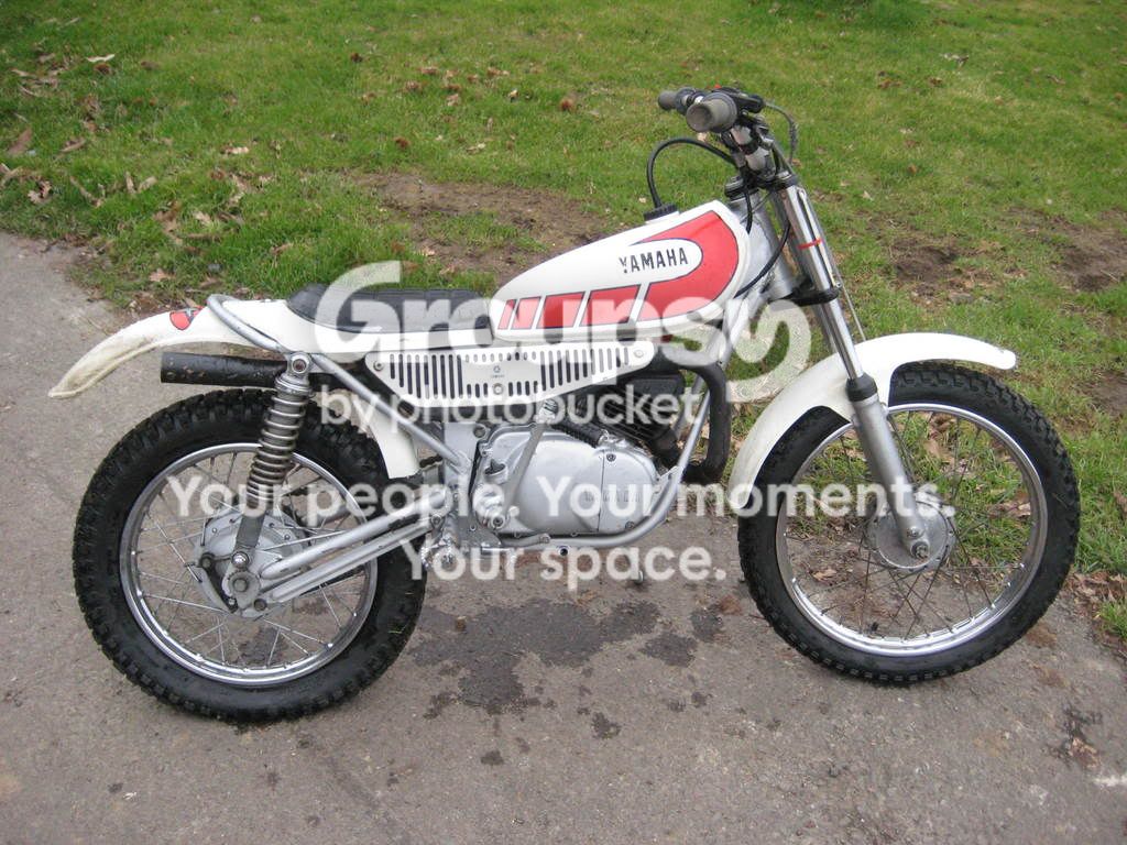

Just wondering if it is possible.
I'm possibly going to be getting an old XL125 or a TY80 for pottering about on over winter (seen both locally for very very cheap) but neither have lights and currently arent road legal due to lack of number plates (were never road registered but have V5 and numbers on frame/engine match).
The journey is only around 6miles so thats why I'm just looking at a smaller CC, nothing more is needed (could probably get by on 50cc haha!) and lack of weight is a bonus as it will be used in snow.
The TY80 is the exact same as the one in this pic:
https://i495.photobucket.com/albums/rr315/matty285/008.jpg
The XL125 is similar to this, however it is not in showroom condition like the one in the picture:
https://2.bp.blogspot.com/_LhgaBAcTB6w/S9nEo1Cv9jI/AAAAAAAAAg8/qKuvgjhwfiM/s1600/TL125+1974-2.JPG
*pics are for illustrative purposes only*

You don't need lights to make a trials bike road legal. Just a horn and a numberplate and it'll go through an MOT (providing everything else works).
Teflon-Mike
tl;dr
PostPosted: 13:39 - 25 Nov 2010    Post subject: Reply with quote
TY80, is small wheeler, its the 7-13 year olds bike for School-boy Trials. Basically the old DT50E engine, with a big-bore.
They are quite err, spritely for a moped!
On the road, you'll find its a bit cramped for a full size grown up, and a little shall we say 'precariouse'.
If it doesn't have licghting coils in the mag, then the back-plate and rotor from a DT50, or RD50/80 will go in the cases. Or you can go 'total-loss' and run lighting kit of a re-chargeable battery. If you want 12v lights, might be the best way to go!
Other bike isn't an XL its a TL.
Again, not sure if the TL motor had lighting coils in its generator, if not XL back-plate and rotor will probably fit.
TL's are over-priced Classic-Trials icons these days.
Research it VERY bludy carefuly before you pay money.
It may be a 'replica' built from an old XL engine and chopped frame with TL body-work on it. (might still be alright for what you want)
eitehr way, pure trials bikes dont tend to make great road-bikes.
High pegs, low, token seat, they aren't very comfy, and low gearing makes them rather slow.
But the old T-shocks aren't AS bad a proposition as some of the modern stuff, and for local use and a bit of green-laning they can be 'fun', though I'd not really go for the TY80... I mean we're looking for a TY175 for Snowie becouse she's short of leg and cant get her feet flat on a DT..... showing her a TY80 small-wheeler would be seriousely taking the piss!
(They did do a 'White-Hawk' big-wheel conversion, that mounted regulation 18/21 wheels, to kift it a bit for older youths, though, which was quite useful.)
Other big thing with comp-trail bikes on road, is sustained running at speed under load, carburation often quite drastically optimised around low speed running and for throttle response, so they can go well over rtch, or worse, well lean when run wide open for any length of time, leading to pinking, overheats and the usual sort of damage. Two-strokes often nip-up, but that's a bit easier to sort than a 4t with holes slug!
If they have V5's then they were road-registered and should have a number-plate, or at least the index you can put on a number-plate.
That would be 'strange' on a TY80, as they were sold as a pure competition bike, for kids, so no need for them to be road-registered, and would have put the price up paying road-vehicle duty and all that crap....... though there was a vogue a few years back to retro-road register trials-bikes as a precaution against theft, until the SORN laws came in.
In iether case, its anomolouse and I would be checking it out thoroughly.
If you want to use either on the road, then they have to be registered, and if you dont have a log-book for them, then it means vehicle ident checks as well as MOT, and if they are 'nicked', you coule be the one left holding the baby, if you put them in for inspection!
Back to the matter of lamps though, neither actually NEED lights to be road-legal. Both are old enough, and as off-road bikes have cirtain exemptions that allow them to be 'Day-light' MOT'd.
You just cant use them in the dark!
My 1981 Montesa Cota Comp-Trials, actually came from the dealer, without lights. Just a number-plate, tax disc a token speedo down on the fork-leg, and a clowns tooty-horn on the handl-bars!
But as the limitations on a Daylight MOT say 'Not used in reduced visibility conditions, or after dark' or something like that, not much use in the winter, I guess!
