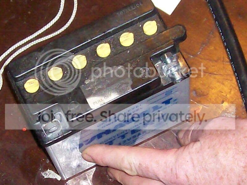

Lots of posts about at the moment with people messing with batteries. Must be the cold weather. Anyway, was re-fitting the battery to Snowie's Super-Dream, and thought a few of you may be interested in this little tip, that makes fiddling with batteries that bit easier.
Common problem is the 'semi' captive nut for the terminal screw. It likes its freedom, and usually makes a bid for it somwhere into the bowls of the bodywork when you takle the wires off!
Then it vexes you for ages, refusing to sit straight or stay still, while you try and put the screw back in, when putting the battery back on.
They like to tease, too, and the battery makers make the scres just that tad too short, so that when teh nut has tipped backwards, its not 'quite' long enough to reach the nut and get it back on its seat.
But, quick trick, helps aleviate all them fun and games.
https://i178.photobucket.com/albums/w269/teflons-torque/Little%20Dreams/BatTerm1.jpg
Cut a small section of rubber pipe, the thickness of the gap behind the battery terminal. Here I'm using some fuel hose I had lying about, but a short section of the plastic over-flow pipe that comes with a new battery, or off the old one works just as well.

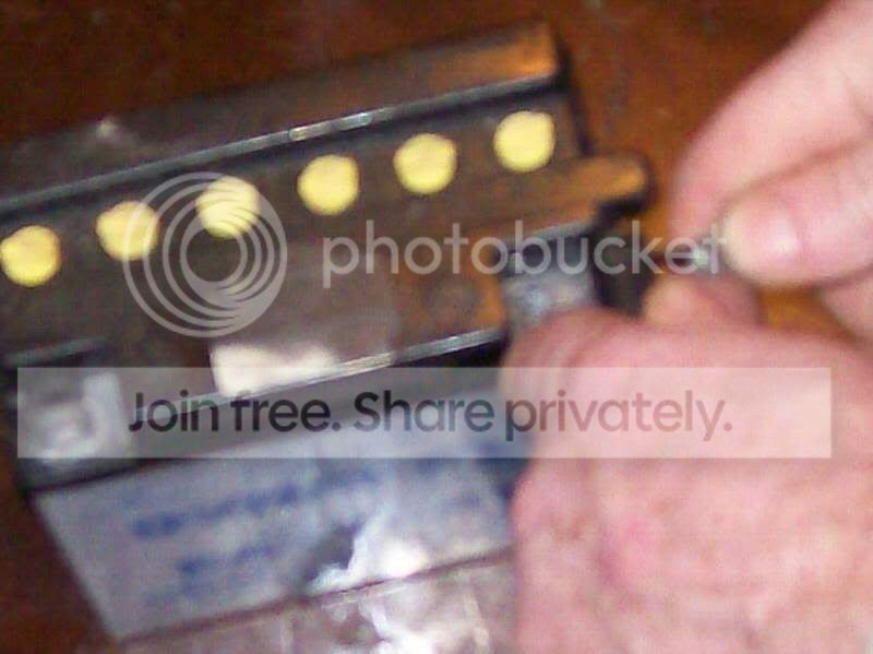

https://i178.photobucket.com/albums/w269/teflons-torque/Little%20Dreams/BatTerm2.jpg
Use it to wedge the nut against the terminal post.

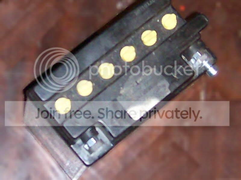

https://i178.photobucket.com/albums/w269/teflons-torque/Little%20Dreams/BatTerm3.jpg
Job Jobbed.
Provided your not too ham fisted, normally holds the nut in place well enough for you to get the screw in and tightened up, and its then held in place for next time, by the end of the screw poking through.
On the vertical screw terminals on some older bikes, the over-flow pipe is often perfect to lift the captive in them up to where the screw starts.
Teaching old hands to suck eggs, its an old trick, and its so simple and obviouse, it probably seems hardly worth a mention.... but how many people have been cursing the wobbly nut lately! So if it helps.....
