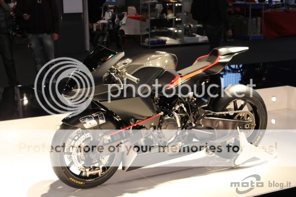

Completely different from the norm Shocked

It certainly is a break from the norm with the hub steering, apparently on paper they perform better then conventional forks.

Looks like the Bimota Tesi system still.
Problem seemed to be that it was incredibly easy to change just about every bit of suspension setup, so very easy to really screw things up. Added to which when new all the rose joints had a load of stiction (screwing up the handling) and then wore out (screwing up the handling) with a limited time in the middle where it all worked.
Hub centre steering does have advantages over forks, but forks have had about 3/4 of a century of development money thrown at them by various big companies and that is a hell of a head start to make up for. Especially when you land up having to use tyres that were designed for normal forked bikes and riders who have grown up with forks.
Next to no dive on the brakes (can dial a bit in) so the front suspension still works when braking hard and allows the rider to brake later while cornering. Trouble is that people have got used to suspension diving on the brakes which makes the steering angle steeper and so easier to tip in.
Also with the Tesi and Elf systems there are limits to cornering clearance with the front swinging arm needing to be wide enough to allow the front wheel to steer.
Without the front spring / damper having to take the braking force you can remove most of the stiction in the front suspension.

There is no doubt in my mind that the hub centre steering is a better system. However it's going to take a lot of time and money to get it working well. If they have issues with the steering they will try to compensate in other areas and handling tweeks will become a complicated mess. I think no major manufacturers have adopted it as none of the others have, that and they don't need it as a unique selling point. No doubt if the Vyrus does well you'll see half the grid with a similar system next year, but i doubt thats going to happen Razz

Yamaha have tried it, but on a heavy bike. Still did OK at the TT when heavily stripped down.

how does the weight compare to forks? looks sort of hefty

hub steering is a brilliant tech but needs more time to develope its like hubless wheels Smile haveing almost no weight to them but still need more developement to be safe really

Phil read's been racing their road bike for a few years now.
https://www.altoracing.co.uk/Racing/vyrus_bikes.html
Not actually that much faster than "normal" bikes at would seem.
