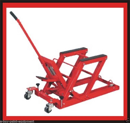

Got one like this, this summer off e-bay for £50.
https://cgi.ebay.co.uk/Motorcycle-Motorbike-Lift-ATV-Jack-1500lb-Capacity-/290501795789?pt=UK_Motorcycle_Parts&hash=item43a3419fcd#ht_1497wt_698
https://i15.ebayimg.com/02/i/001/0b/ba/91ee_12.JPG
Got it off the same people, but off an auction rather than BIN.
Not put it to 'proppa' use yet. Goes under the cradle of a twin-hoop frame. Dont do too well on a road-bike with an exhaust in the way, or a bike with a stressed engine and no pipes under the sump!
Used it to lift the motors in and out of the super-Dreams though, fairly successfully.
PostPosted: 23:29 - 25 Jan 2011    Post subject: Re: DR250 - workshop stand for maintenance Reply with quote
