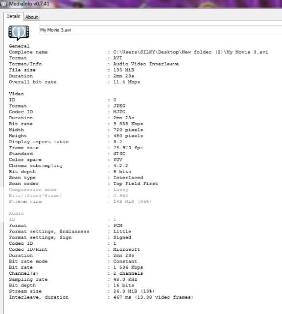

silky666
Captain Rulebook
Joined: 28 Aug 2006
PostPosted: 01:17 - 30 Jan 2011    Post subject: Reply with quote
Mine:
https://i157.photobucket.com/albums/t69/silky666/Random/Untitled-9.jpg
DynaMight
Joined: 27 Oct 2004
PostPosted: 12:20 - 30 Jan 2011    Post subject: Reply with quote
Thats an uncompressed format. Thats why the quality isn't very good for the size of the file and why the bitrate is so high. It's kinda like the difference between a JPEG and BMP picture, twice the size but quarter the quality.
What program do you use it edit the files? Chances are you may just need to install xvid, then choose it under compression, set the bitrate to about 3000 (assuming you're using the same resolution)
Also, what resolution is the original GoPro recordings? 720p, 960p, 1080p?
silky666
Captain Rulebook
Joined: 28 Aug 2006
PostPosted: 16:02 - 30 Jan 2011    Post subject: Reply with quote
Thanks for your help DynaMight ... but I am just as confused as I ever was Smile
I think I might just get Sony Vegas Smile
