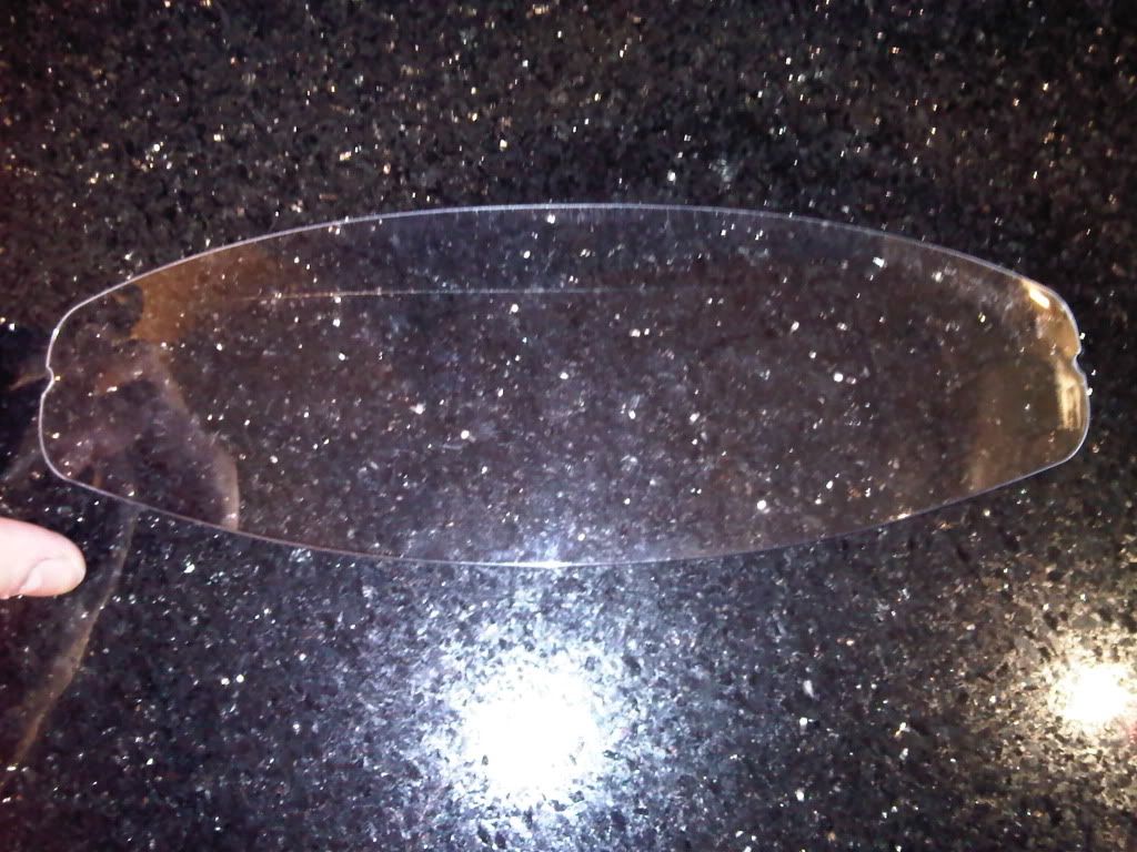

You want to thoroughly clean the visor with a dab of washing up liquid. I used my fingers to clean any dirty of as they are soft lol. Then rinse with water, and dry using kitchen roll or similar:
https://i1183.photobucket.com/albums/x474/0l0dom0l0/IMG00051-20110206-1648.jpg

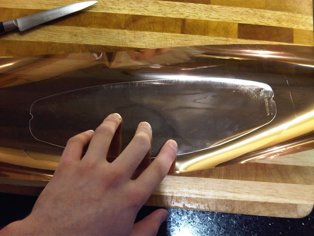

Anyways, leave yourself about an inch of spare film around the shape of the visor. I used a knife to mark the film where I wanted to cut:
https://i1183.photobucket.com/albums/x474/0l0dom0l0/IMG00052-20110206-1648.jpg

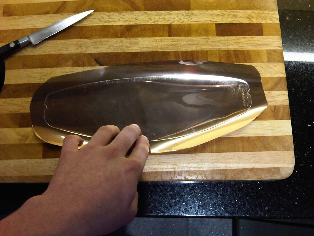

And scissors to make the actual cut. This worked well, so I would recommend this:
https://i1183.photobucket.com/albums/x474/0l0dom0l0/IMG00053-20110206-1650.jpg

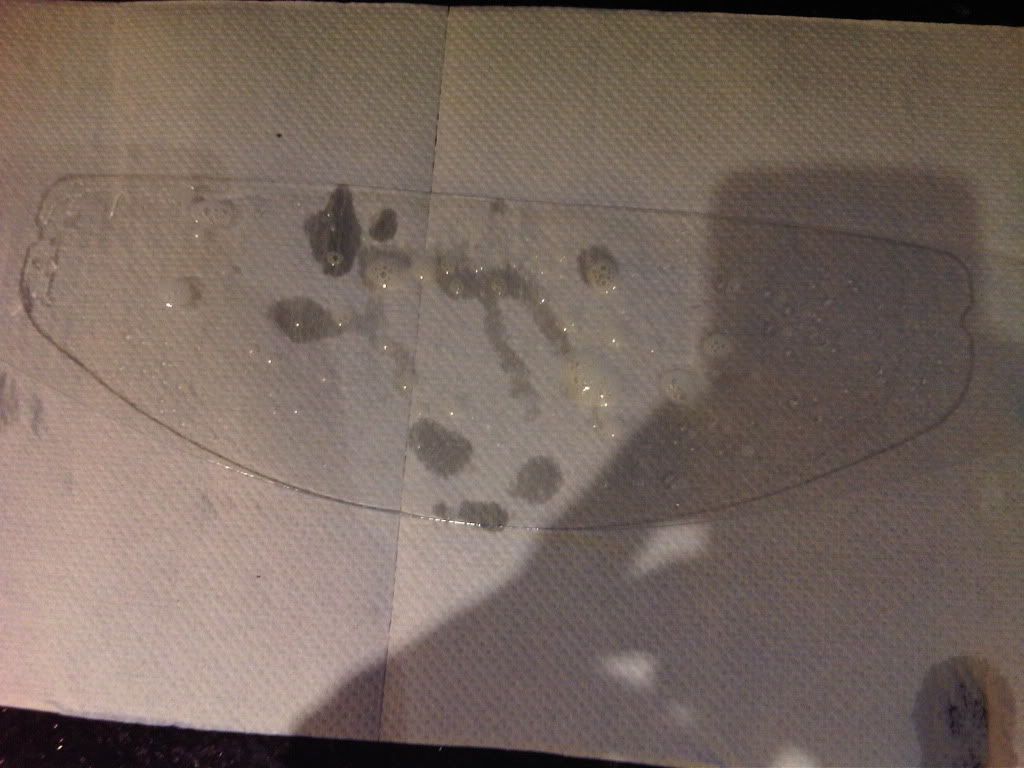

Then you need to peel a corner of the protective film off to reveal the adhesive side of the film (This makes sense when you actually get the film). Then add washing up liquid and a little water to the side of the visor you want to tint:
https://i1183.photobucket.com/albums/x474/0l0dom0l0/IMG00054-20110206-1652.jpg
This bit is really hard to explain but basically you want the film to be between the pinlock and the actual visor when its in the helmet (I got this wrong side in mine so I had the film on the inside bit by accident), more on that later). That way the film is being stretched rather than compressed when the visor is in the helmet and it helps get rid of any air bubbles.

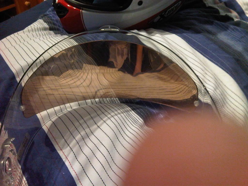

Then after an hour or so, take the mags off and trim around the edges with the scissors. I then put it into my helmet to stretch it out. This is when I realised I would have been better tinting the other side (in-between the pin lock and visor). It looks like this:
https://i1183.photobucket.com/albums/x474/0l0dom0l0/IMG00057-20110206-2004.jpg

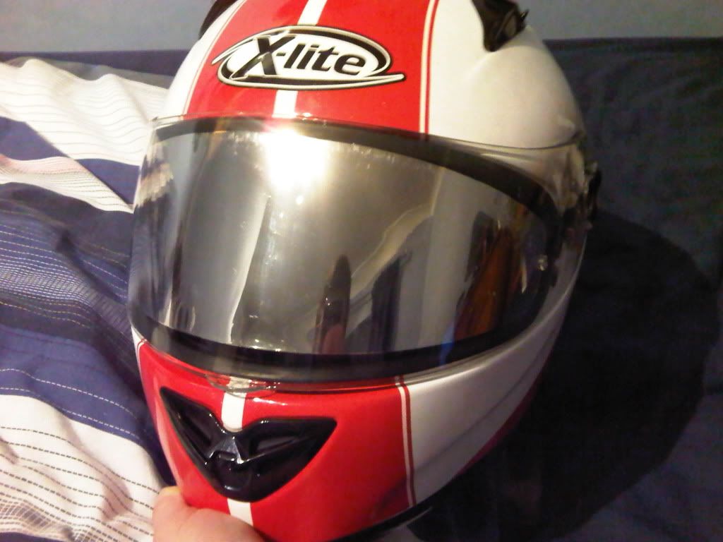

However, the joy wit this film is its actually universal. So from the outside you see this:
https://i1183.photobucket.com/albums/x474/0l0dom0l0/IMG00058-20110206-2005.jpg
If I turn the pin lock around, you would see the gold tint on the outside (I will do this when it dries properly).
Basically, I can chose between a mirror effect and a gold effect. The film reflects light from either side in the same way. From the inside of the visor, it just feels like your wearing sunglasses.
In my opinion its a pretty good job tbh. Considering the visors for my helmet I were looking at came in around £50, this has cost me the price of the film + just a standard antifog insert which can be bought for pennies. The end result looks pretty professional. I am really impressed!
