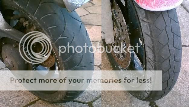

I changed the front tyre on my VFR750 from a 70 to a 60 section and left the rear as it was. This made more of a difference because it lowered the front by 6mm but left the back where it was. The increased contact patch size and lower profile was overridden by the decreasing of the rake angle. So I got a bike that felt both grippier and quicker to steer.
I decided on this course of action because of the huge disparity between the amount of tread on the front tyre I was using compared to the rear.
So this was the wear pattern with the 70 section front:
https://i48.photobucket.com/albums/f216/stinkwheel/70sec.jpg
And this is with the 60 section front:
https://i48.photobucket.com/albums/f216/stinkwheel/60sec.jpg
As you can see. It 's closer to the edge of the tyre for the same angle of lean on the lower profile tyre. Fine in my case because I'm still going to run off the rear tyre first.
