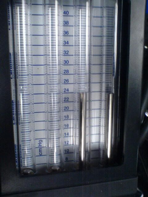

PostPosted: 18:19 - 15 Feb 2011    Post subject: Reply with quote
Just thought I would update this.
Balanced the carbs today with the balancer I borrowed off Phil. Much smoother, picks up better from low revs and the flat spot I had is barely noticeable. Will update with mpg figures once I have some Thumbs Up

PostPosted: 09:31 - 16 Feb 2011    Post subject: Reply with quote
Just out of interest but can you remember how far out they were before you adjusted them?
PostPosted: 12:30 - 16 Feb 2011    Post subject: Reply with quote
Four, possibly, but I'm not entirely sure.
