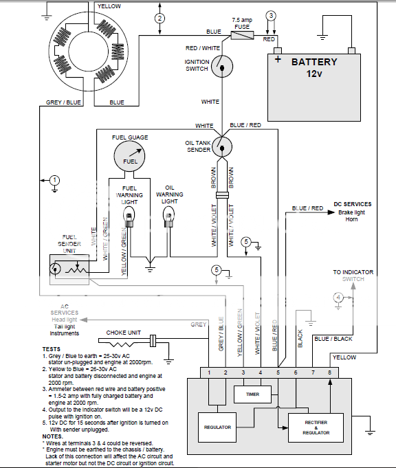

Having a bit of trouble sourcing an NRG wiring diagram, but here's one for the runner.
https://electricwiringdiagram.com/wp-content/uploads/2009/12/electric-wiring-diagram-scooter-gilera-runner-fx125.jpg
looks like it should be right...
So it looks like your black wire with the red wire underneath goes through to the ignition, and the little plastic box should be a fuse.
Cant do much more with this till someone can find a wiring diagram for the NRG.

Think i have the diagram for the nrg.... I have just put some pics up that show the basic jist of my problem... I shall upload the nrg wiring loom asap. Thanks

So we have:
https://i624.photobucket.com/albums/tt325/duncdmc/NRG.png?t=1297976988
And you're wanting the CDI end of the wires off that one.
And then we have
And you're wanting the Engine side off that.
So, gimme a wee minute while i compare to figure this out Laughing
Dunc
dextersaurus
Joined: 26 Mar 2009
PostPosted: 22:36 - 17 Feb 2011    Post subject: Reply with quote
I'll edit this post more as i learn more.
The yellow wires join together, one comes from the reg/rec and goes to the alternator.
There should be a red wire (the one with the black cover) from the engine side also, that goes from the genny to the ICU so i'm thinking the Red cable (with the black cover) goes into the grey cable. right next to it (the one with the matching blue cover)
Also, the blue cable looks to go to the Coil... that'll need to be extended quite a bit. The coil should just ground off the frame.
The green wire from the alternator should join to the ignition switch, should connect to the blue/red wire as that's your ignition one from the reg/rec
So that's the green, blue, red(black), grey and yellow wires from the Engine taken care of.
Also, the yellow, and the blue/red cable on the reg/rec side taken care of.
Anyone that knows more about my limited knowledge of wiring could help, i'm not doing too well with this, doing my best though.
Dunc
