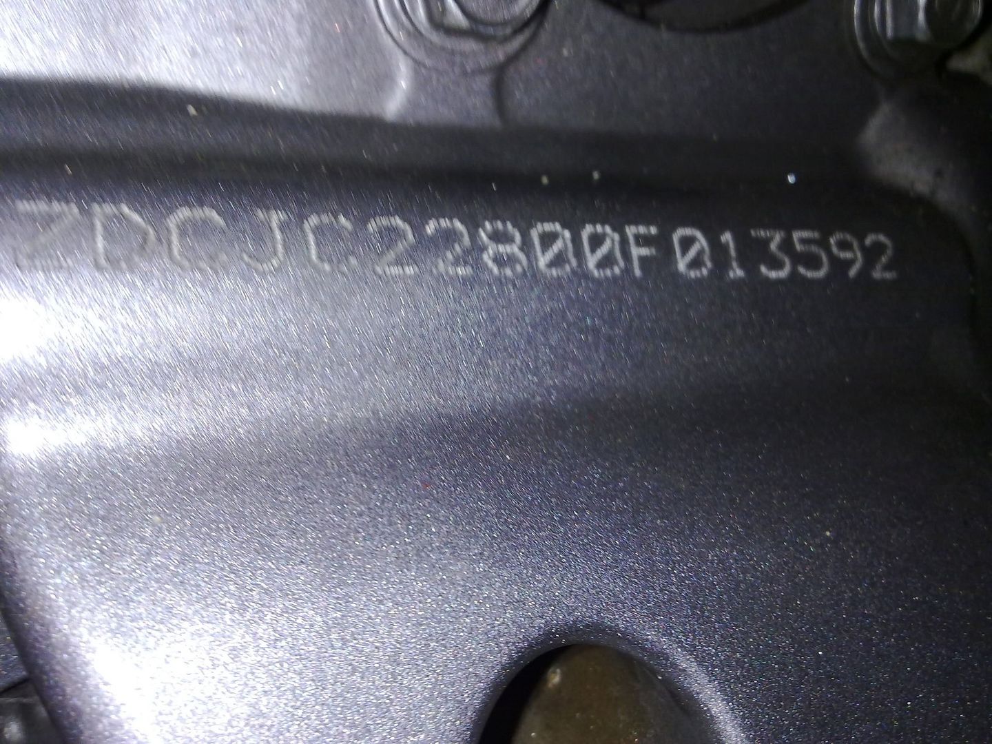

Yoke number is: ZDCJC22
You need to tell us the letter after the 22!

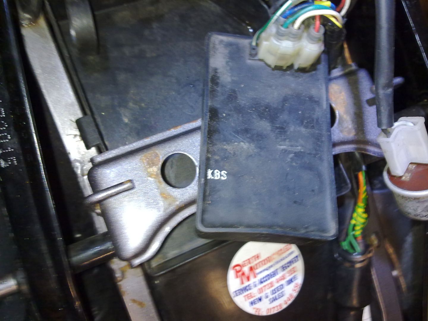

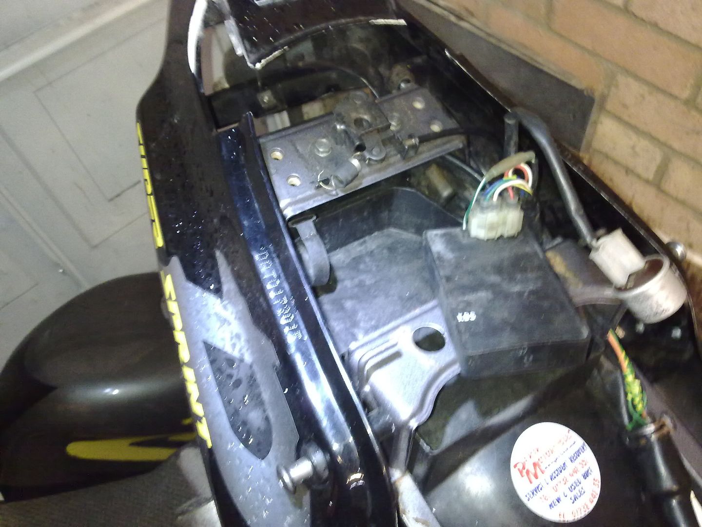

CDI location is under the rear seat lock crossmember (photo 1)

Yoke number is: ZDCJC2280 0D013592

Managed to get the CDI out after pulling bits for ages. Whats the easiest root to get it out? Coulden't come towards the front of the bike as theres plastic all in the way...

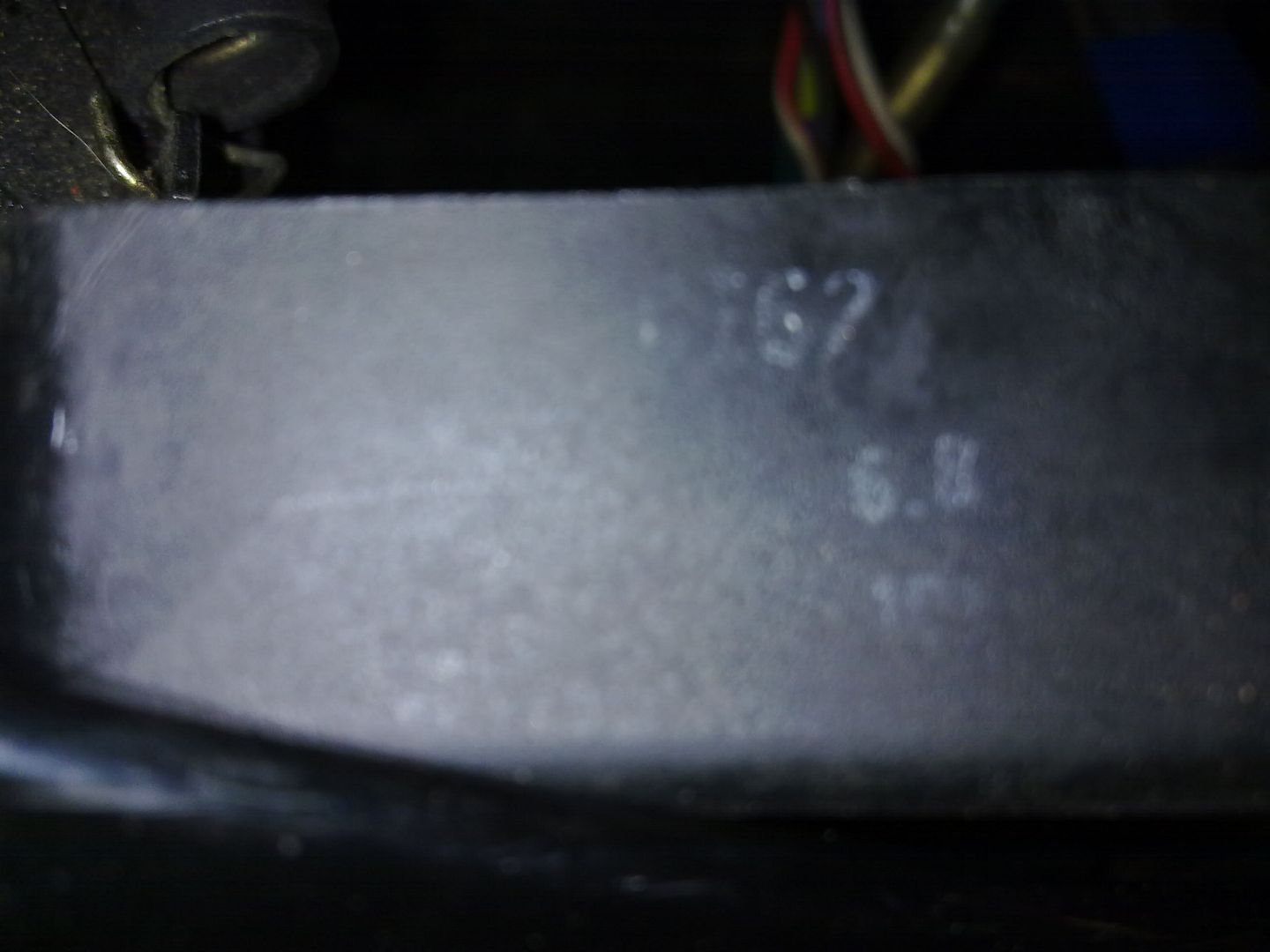

Any way here it is. This is the only text on it which is "KBS" and somthing a long the lines of " CI62 " and some other smallprint text. I can barely read it as its almost rubbed away.
https://i152.photobucket.com/albums/s183/html33/23022011993.jpg
https://i152.photobucket.com/albums/s183/html33/23022011986.jpg
https://i152.photobucket.com/albums/s183/html33/23022011985.jpg

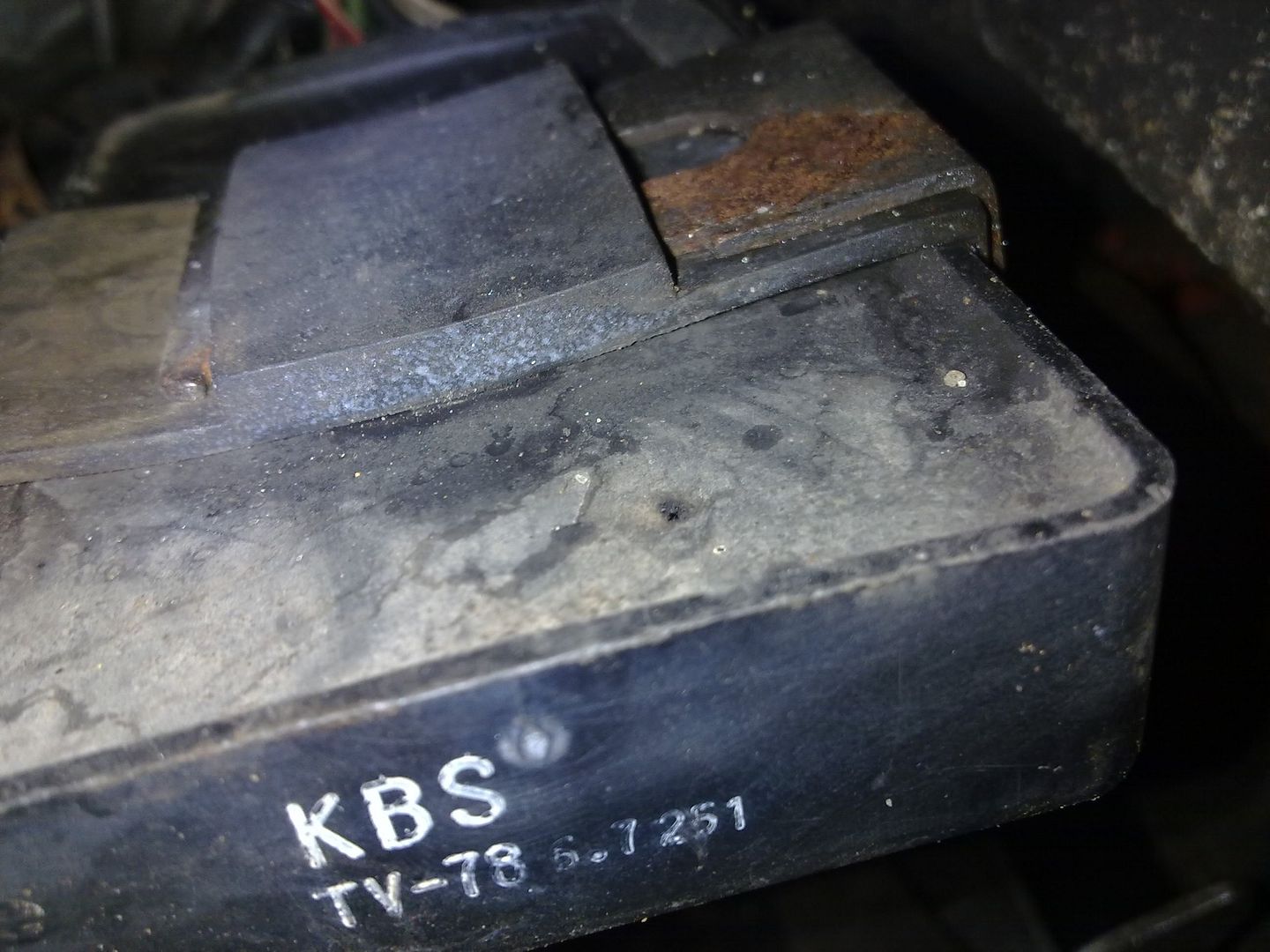

Here is the powervalve controller:
https://i152.photobucket.com/albums/s183/html33/23022011988.jpg

So from what it appears - Everything is de-restricted?
