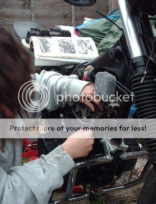

https://i178.photobucket.com/albums/w269/teflons-torque/XX-Forum%20Posts/imag1771.jpg
Hides in there, where Snowies waggling spanners adjusting the tappet clerences.
