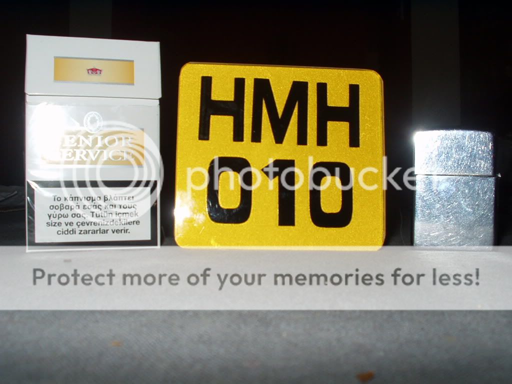

Installed my postage stamp number plate. Mr. Green

3 x 3 is the size of his reg plate.
wrong..But right Thumbs Up
