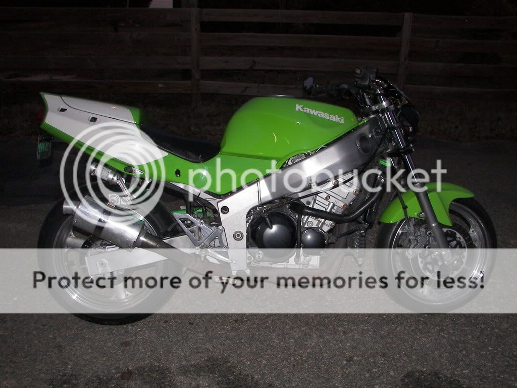

https://i410.photobucket.com/albums/pp190/mooreer2/bike/100_5434.jpg
Looking at that photo ^, the set on eBay don't appear to be long enough, they seem like they'd get as far as the join by the rear brake lever. If that is the case then you will need a link pipe.
RichieZX6R
Joined: 15 Jan 2009
PostPosted: 14:31 - 17 Mar 2011    Post subject: Reply with quote
Oh yeah I see what you mean now! I wasn't paying attention to the length! Guess I best start looking for a link pipe, might be able to get 1 turned out of stainless from my old man I hope. if not i'll have a look on fleabay or somewhere. Thanks again for the advice!
