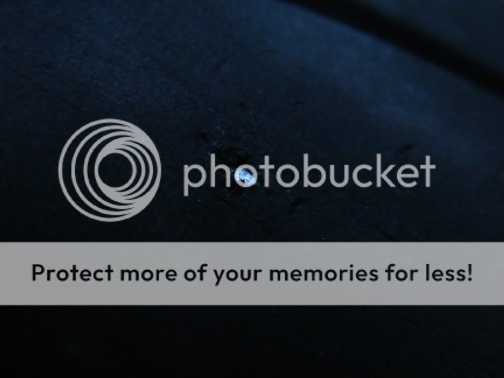

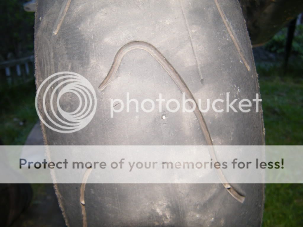

So i had a nice long run on the TT today, running very well.
Got home and checked over the tyres and the like, oh no... nail in the rear tyre.
https://i624.photobucket.com/albums/tt325/duncdmc/DSCF0759.jpg?t=1302723315
https://i624.photobucket.com/albums/tt325/duncdmc/DSCF0763.jpg?t=1302723379
tyres have about 1k miles worth left in them, is it just a case of taking it to get it plugged up? or would it just be worth changing the tyres? won't be doing many miles on it this month anyway, since i'm working constantly... so either way it won't matter too much.

Should plug fine.
Or I've totally convinced myself those figure of eight stab through bungs constitute a permanant repair, regardless of what it says on the packet about not exceeding 50mph. I have used many of them for protracted periods and at high speeds.
