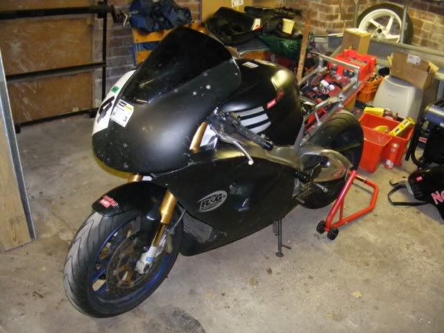

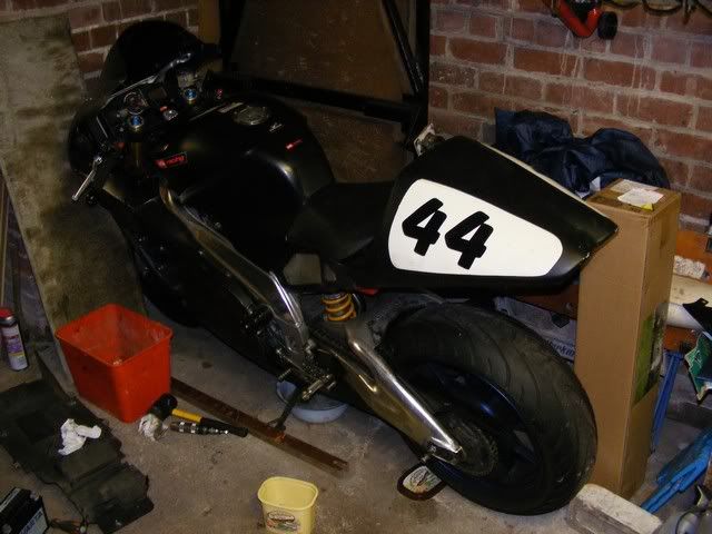

As I mentioned in the Winter Projects thread, I'm going to convert my 2002 Aprilia RSVR for track duties. I bought the bike in November 2008 and loved it. After owning it for a while the riding position started to grate and i used it less. However, my love for it was rekindled when i took it on track, as it's awesome there. After those trackdays I rode it even less on the road, as the only time it was comfortable and 'fun' to ride was when I was giving it the berries, and I didn't want to lose my licence!
Here's how I bought it:
https://i47.photobucket.com/albums/f186/markjackson13/n660357060_1551843_2894.jpg
https://i47.photobucket.com/albums/f186/markjackson13/n660357060_1551841_2380.jpg
I purchased some track fairings but the rear seat unit never fit over the numberplate bracket on the undertray and the double seat subframe.

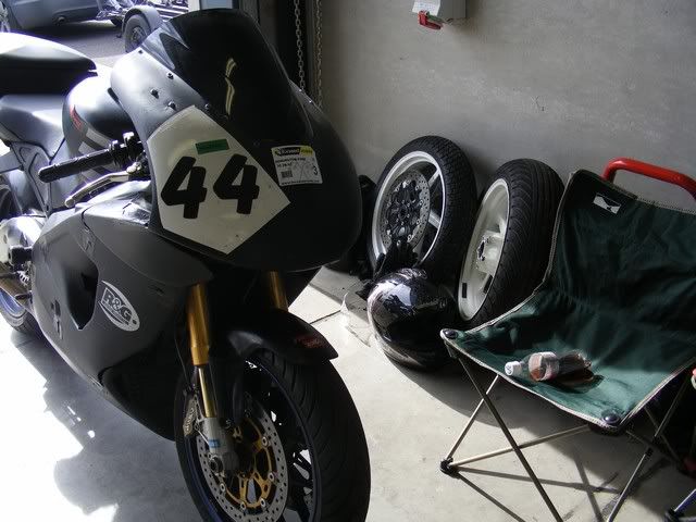

Cadwell 2009:
https://i47.photobucket.com/albums/f186/markjackson13/6408_111070147060_660357060_2730823_1955418_n.jpg

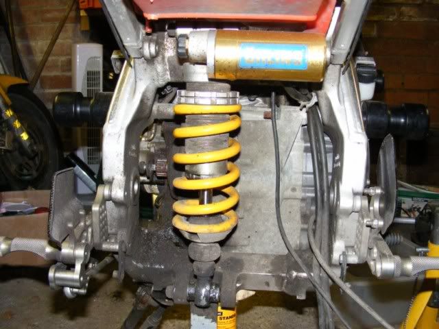

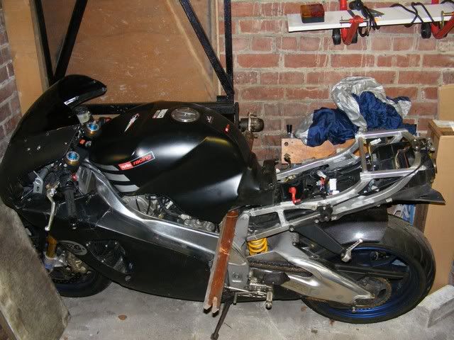

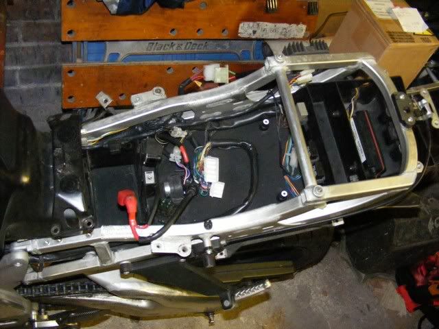

I took the rear plastics off the double seat unit
https://i47.photobucket.com/albums/f186/markjackson13/DSCF1042.jpg

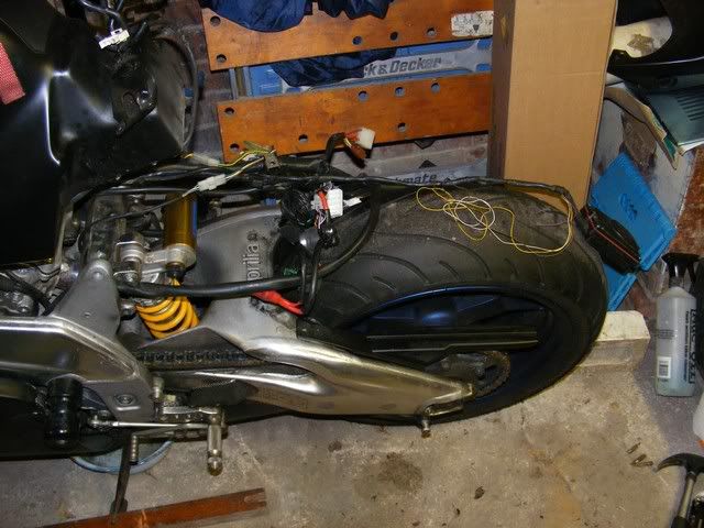

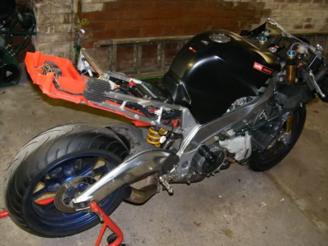

Took the ECU box and battery out
https://i47.photobucket.com/albums/f186/markjackson13/DSCF1043.jpg
You have probably noticed I have an alarm on the bike. I was going to chop it out, but then thought that i don't mind it having an alarm really. I'll keep it but will pack the area it sits in with foam for when it's at a trackday - I put it into service mode at trackdays so if I fall off and a marshal turns it off by the key the alarm won't arm.
Double seat subframe out!
https://i47.photobucket.com/albums/f186/markjackson13/DSCF1051.jpg

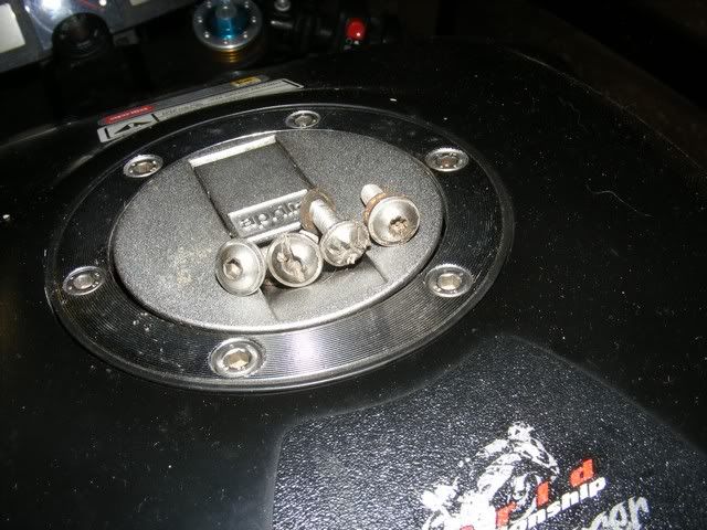

You can also see I removed the rear hugger. This actually took 3 hours to get the four bolts out as they'd all seized into the swing arm Sad Had to impact driver two of them out by cutting a slot in them, and got one out by hammering a torx head into it:
https://i47.photobucket.com/albums/f186/markjackson13/DSCF1052.jpg

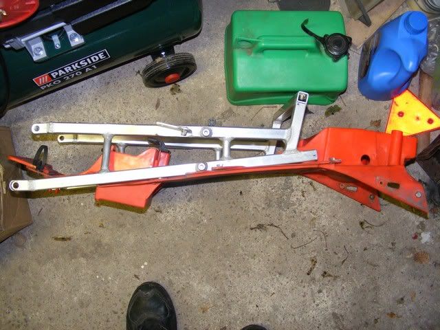

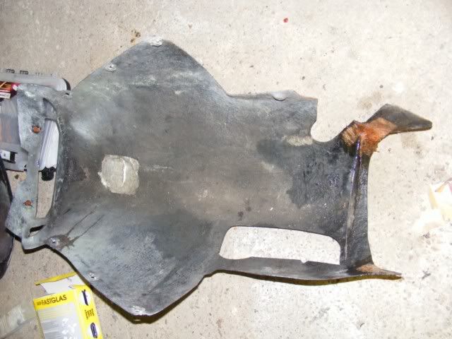

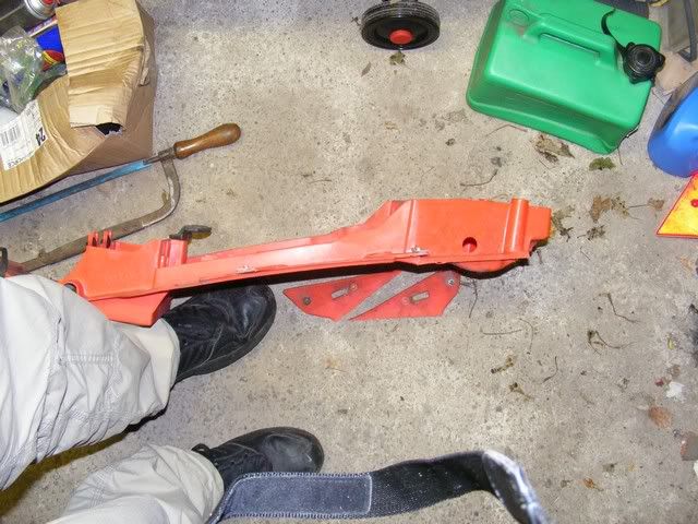

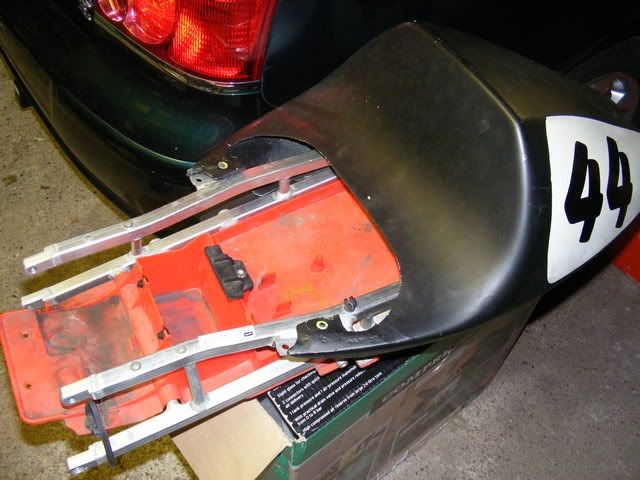

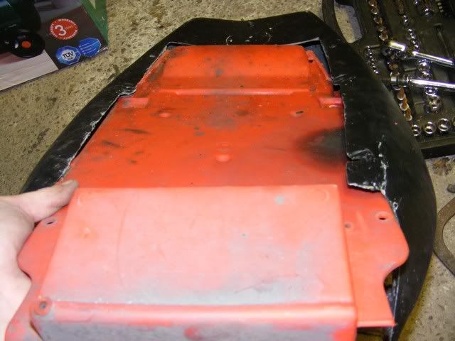

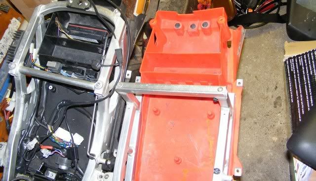

I put the undertray in the new subframe, but the seat unit doesn't go on because it can't get past the numberplate brackets:
https://i47.photobucket.com/albums/f186/markjackson13/DSCF1062.jpg
So I chopped 'em off!
https://i47.photobucket.com/albums/f186/markjackson13/DSCF1064.jpg
The undertray then fits in the seat unit
https://i47.photobucket.com/albums/f186/markjackson13/DSCF1065.jpg

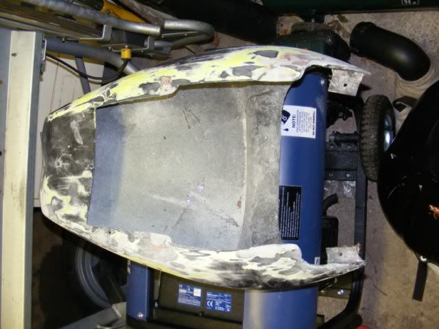

Undertray is a bit grotty, so may give it all a sanding to see if it'll get rid of the crap. hopefully the burn mark is just on the surface.
View from the top
https://i47.photobucket.com/albums/f186/markjackson13/DSCF1066.jpg

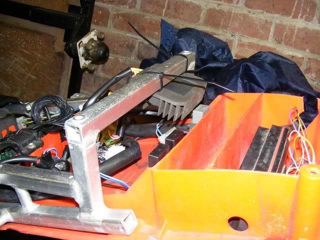

I tried to mount the reg/rec with cable ties but it stopped me being able to put the seat unit on. I ended up screwing it to the side of the subframe with just one bolt.
https://i47.photobucket.com/albums/f186/markjackson13/DSCF1056.jpg

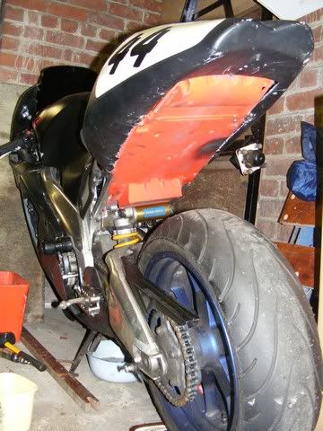

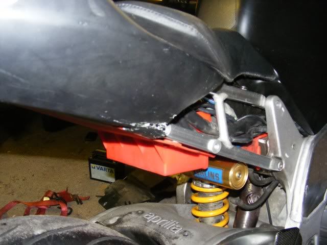

Then I fitted the seat unit!
https://i47.photobucket.com/albums/f186/markjackson13/DSCF1053.jpg
Underneath. Can just about make out where I chopped the numberplate brackets off.
https://i47.photobucket.com/albums/f186/markjackson13/DSCF1054.jpg

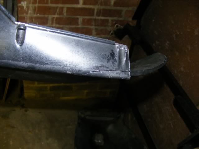

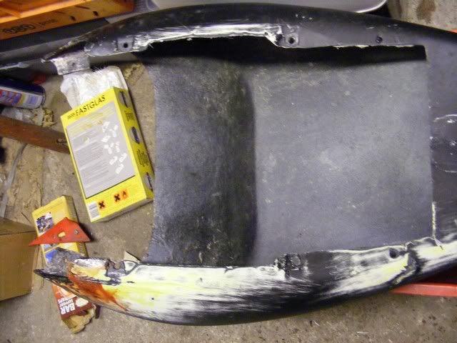

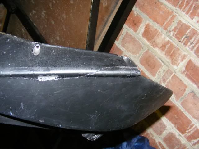

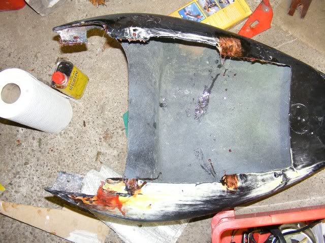

Unfortunately there are a few cracks like this one:
https://i47.photobucket.com/albums/f186/markjackson13/DSCF1055.jpg
So I set about with the fibreglass repair kit. Before:
https://i47.photobucket.com/albums/f186/markjackson13/DSCF1059.jpg
After:
https://i47.photobucket.com/albums/f186/markjackson13/DSCF1060.jpg

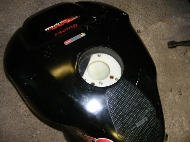

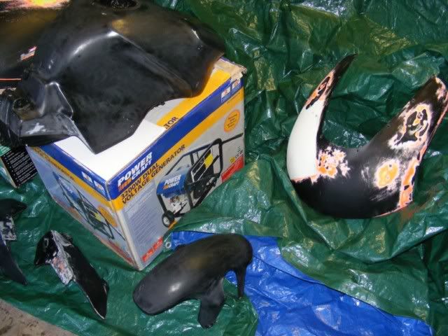

And finally, a picture of the spare tank I have.
https://i47.photobucket.com/albums/f186/markjackson13/DSCF1061.jpg
The fuel pump inside it works (tested it last night) which is good.
Had to get the lock picked on it Very Happy It's a plastic tank. Has anyone ever sprayed a tank like this before? Would I need a plasticiser?

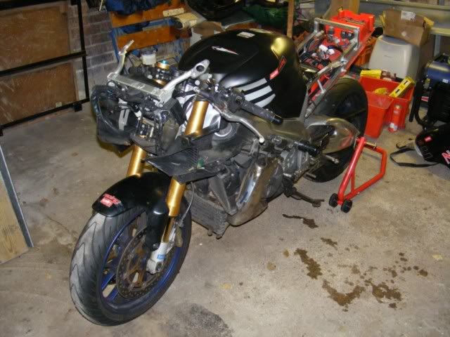

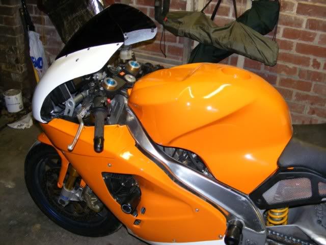

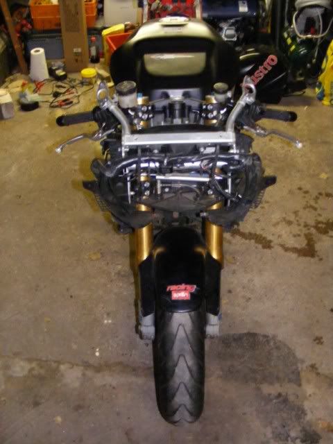

Went from (nearly) fully faired:
https://i47.photobucket.com/albums/f186/markjackson13/DSCF1069640x480.jpg
To not:
https://i47.photobucket.com/albums/f186/markjackson13/DSCF1079640x480.jpg
https://i47.photobucket.com/albums/f186/markjackson13/DSCF1080640x480.jpg
https://i47.photobucket.com/albums/f186/markjackson13/DSCF1081640x480.jpg

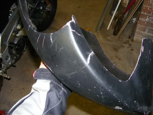

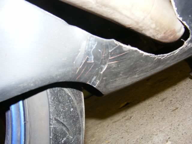

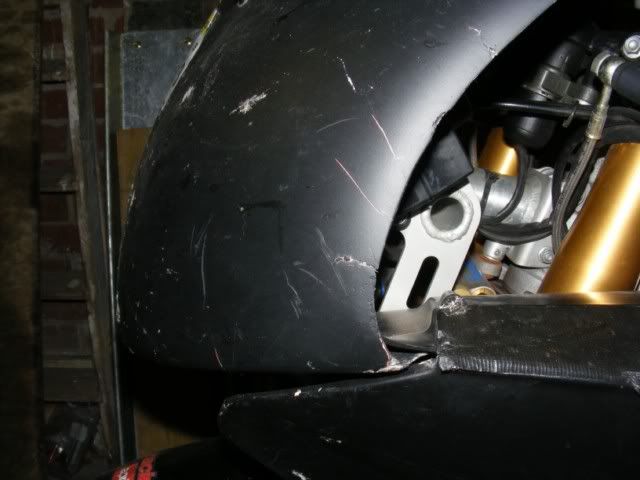

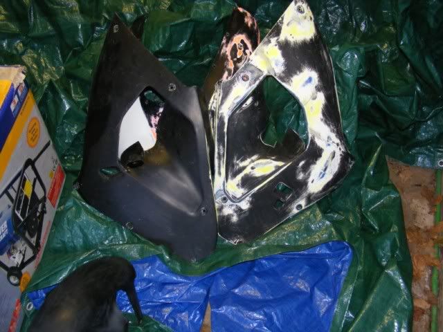

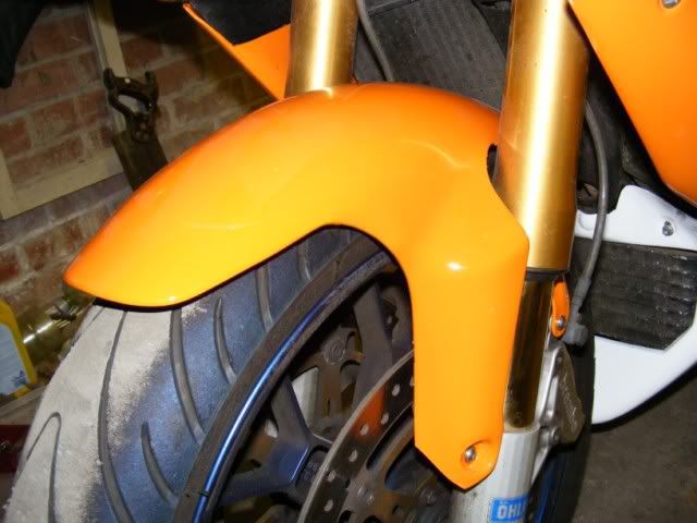

Bits that need fixing...

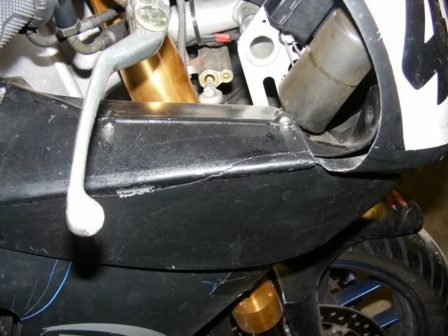

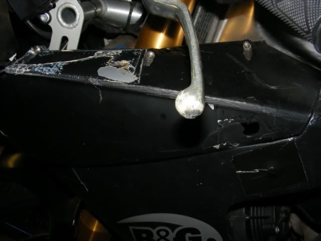

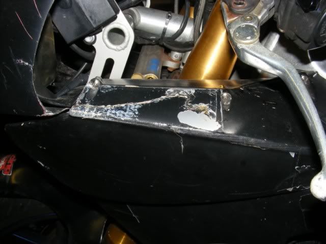

Nose cone. The side that surrounds the clutch lever is pretty thin and has cracked with the stress of the wind:
https://i47.photobucket.com/albums/f186/markjackson13/DSCF1071640x480.jpg
https://i47.photobucket.com/albums/f186/markjackson13/DSCF1082640x480.jpg
Bit of a gouge at the top mounting point too:
https://i47.photobucket.com/albums/f186/markjackson13/DSCF1070640x480.jpg

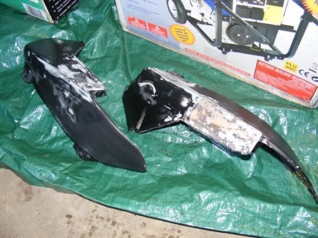

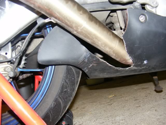

Belly pan. There are some flimsy parts at the back which aren't strong enough, so wobble and crack the paint. these just need strengthening.
Exhaust side:
https://i47.photobucket.com/albums/f186/markjackson13/DSCF1074640x480.jpg
https://i47.photobucket.com/albums/f186/markjackson13/DSCF1073640x480.jpg

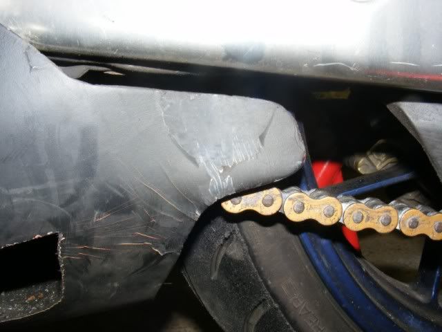

Chain guard:
https://i47.photobucket.com/albums/f186/markjackson13/DSCF1072640x480.jpg

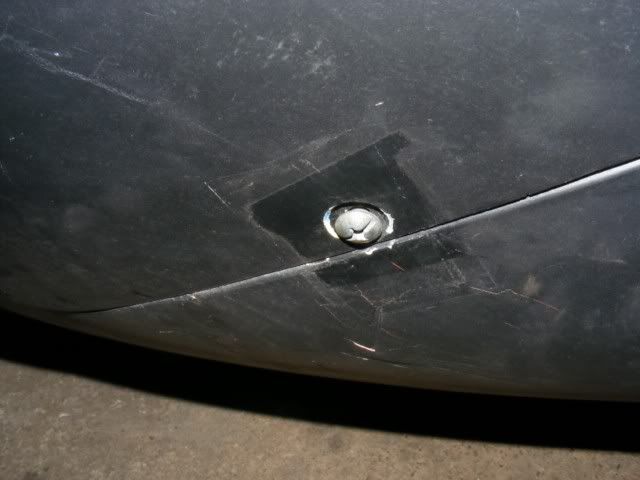

And finally, some of the DZUS fastners on the fairings don't fit tightly, so undo themselves unless they are gaffer taped on:
https://i47.photobucket.com/albums/f186/markjackson13/DSCF1078640x480.jpg
Will probably just stick a bit of foam/sealant/bodyfiller behind the fairing to widen the gap making the bolts fit tightly.

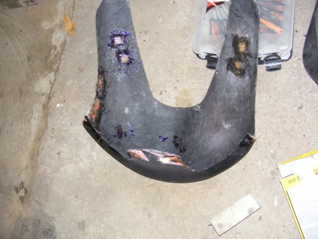

Last night I strengthened the bellypan:
https://i47.photobucket.com/albums/f186/markjackson13/DSCF1098640x480.jpg
And strengthened the nose cone:
https://i47.photobucket.com/albums/f186/markjackson13/DSCF1097640x480.jpg

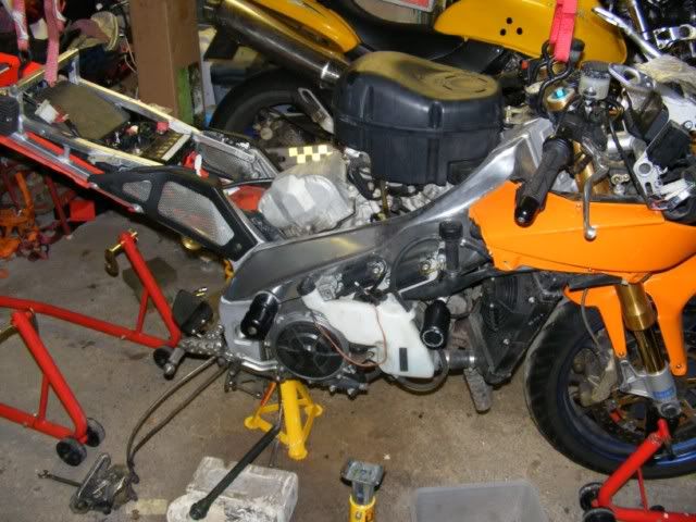

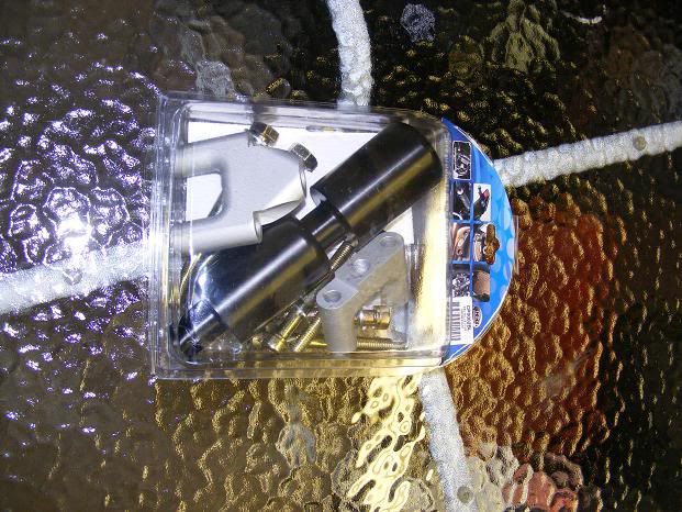

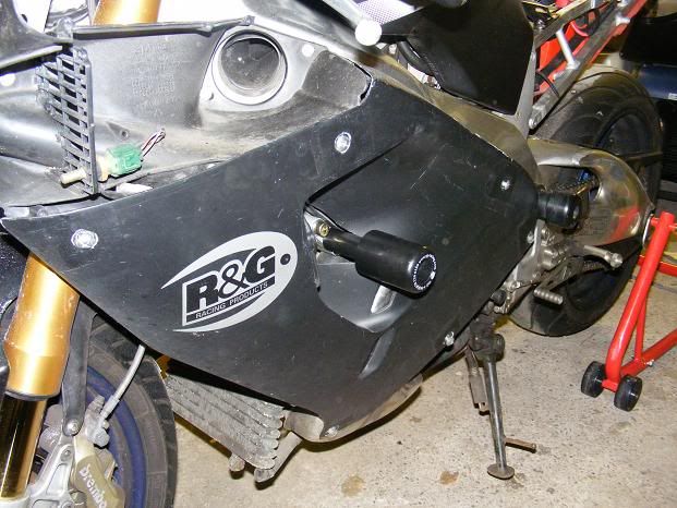

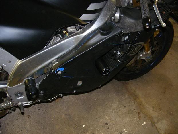

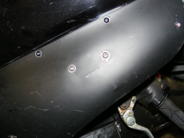

Bought some R&G bungs the other day, fitted them tonight.
https://i47.photobucket.com/albums/f186/markjackson13/DSCF1099.jpg
https://i47.photobucket.com/albums/f186/markjackson13/DSCF1100.jpg
https://i47.photobucket.com/albums/f186/markjackson13/DSCF1101.jpg
Fairings were already cut for crash bungs so this was a nice quick job. Should hopefully be finishing off the bodywork this week.

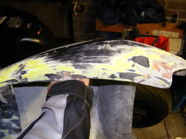

I "finished" (got them to an OK standard then got fed up with them) preparing the fairings, bought the paint and then made a right cock up of spraying the primer. It came out all watery, but was still thick inside the gun and clogged it all up. They're currently at the painters now and should be done on Tuesday hopefully, will post some pics then.
The air ducts are just another set of standard air ducts, definitely not race items. I'd actually forgotten how bad a condition these were in until I looked at these pics - they're not perfect now, but at least look presentable Very Happy

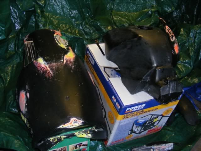

Everything except the air ducts is just from wind pressure and vibration. The glass fibre was quite thin in a few places and obviously the stress of it moving made it crack. The air ducts however seem to have been on a bike that's been crashed due to the damage. After I sanded them down you could see that this fairing kit had been made up from different pieces.
It's made up of:
One green side panel
One blue side panel
An orange nose cone and belly pan
A green tail unit
One silver air duct
One black air duct
One black petrol tank (which I bought)

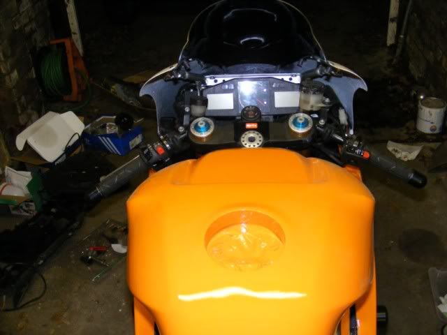

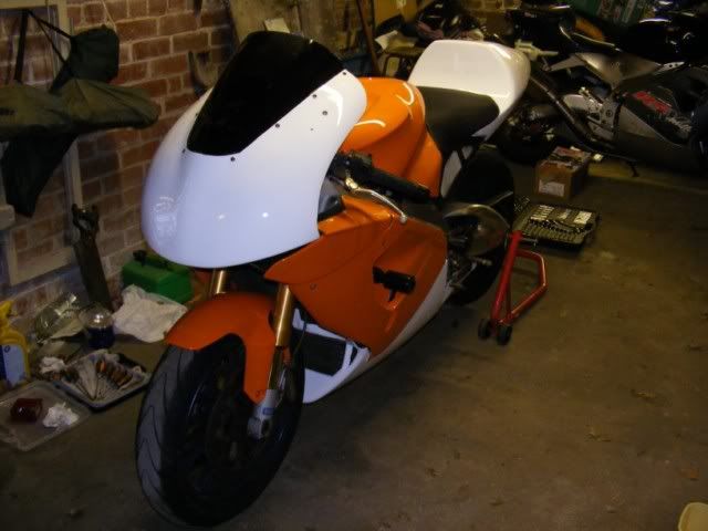

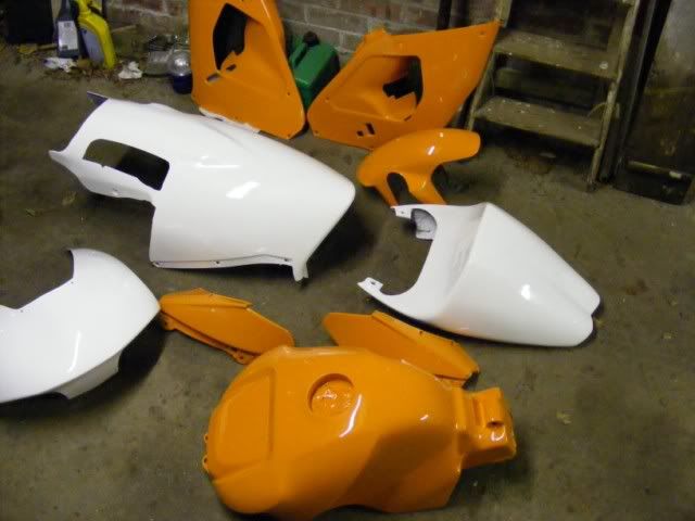

Right, I very roughly put everything on today, going to screw everything together properly together tomorrow.
Ready for painting:
https://i47.photobucket.com/albums/f186/markjackson13/DSCF1163640x480.jpg
https://i47.photobucket.com/albums/f186/markjackson13/DSCF1164640x480.jpg

And back from the painters:
https://i47.photobucket.com/albums/f186/markjackson13/DSCF1167640x480.jpg
https://i47.photobucket.com/albums/f186/markjackson13/DSCF1170640x480.jpg
https://i47.photobucket.com/albums/f186/markjackson13/DSCF1169640x480.jpg
https://i47.photobucket.com/albums/f186/markjackson13/DSCF1168640x480.jpg
https://i47.photobucket.com/albums/f186/markjackson13/DSCF1173640x480.jpg
https://i47.photobucket.com/albums/f186/markjackson13/DSCF1172640x480.jpg
https://i47.photobucket.com/albums/f186/markjackson13/DSCF1171640x480.jpg
Shiny Mr. Green I know orange isn't to everyone's taste but I like it. The painters did a really good job and at least I won't be one of the many black or red bikes in the trackday pictures Very Happy

I seem to be going backwards now Laughing

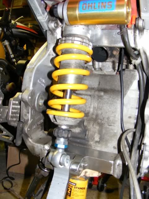

https://i47.photobucket.com/albums/f186/markjackson13/DSCF1174640x480.jpg
The suspension linkage bearings on the bottom of the swingarm had seized (common problem with RSVs) and if left like this for a while can eventually disintegrate and sometimes snap the linkage plate, so I took the swingarm off and took it to my local bike shop for the new bearings pressing in.
The shock is quite awkward to clean as the swingarm is quite tall so now was a good opportunity to clean the whole area.
https://i47.photobucket.com/albums/f186/markjackson13/DSCF1175640x480.jpg
20 minutes of scrubbing with a rag and white spirit later:
https://i47.photobucket.com/albums/f186/markjackson13/DSCF1176640x480.jpg
https://i47.photobucket.com/albums/f186/markjackson13/DSCF1177640x480.jpg
Picking swingarm up tomorrow, fitting that and the fairings & tank properly at the weekend then should be all finished Thumbs Up
