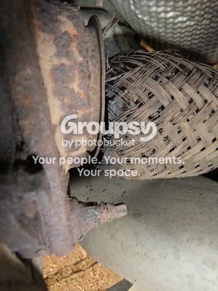

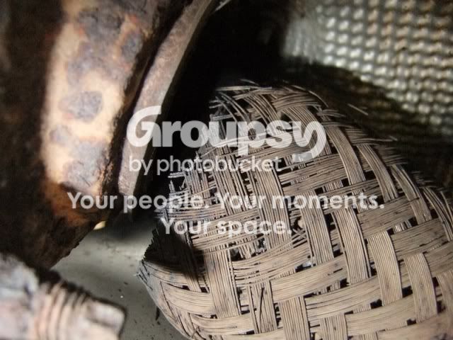

Afternoon all.
Whilst driving to the shops for some milk, all of a sudden, my car sounded like a dragster. Initial though was that the exhaust had fallen off. Parked up, looked under the car and everything was where it should be and nothing was dangling. Got home (thankfully a short distance) and inspected the system from front to rear and found this:
https://i701.photobucket.com/albums/ww11/drewie3000/DSCF6372.jpg
https://i701.photobucket.com/albums/ww11/drewie3000/DSCF6373.jpg

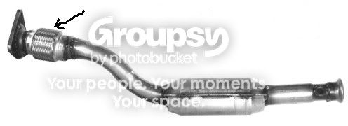

It's the flexi bit on the cat (typical it would be the most expensive part of the exhaust system Rolling Eyes). Diagram for clarity:
https://i701.photobucket.com/albums/ww11/drewie3000/90578.jpg
In usual renault style, to get to that section I'd have to pull off the air filter assembly etc to get to it. However, my question is, does anyone know if this can be repaired (I'm open to bodge job repair ideas as the car is old and knackered anyway), or is it a £100 new cat job?
Cheers all

You can buy universal flex ( from most local factors/exhaust specialists, failing that ebay), but you will need to measure the diameter and success with them is hit and miss.

If you are not planning to keep the car for long, perhaps not past its next MOT, just buy a cat bypass pipe if you can find one.

You can buy a race cat... just to weld on and fit.
I used the race cat to get car through the MOT.

Had this on my MX5, just go on ebay and get some flexijoint, tis dirt cheap and just weld it on. Cheap fix that should last a while.
