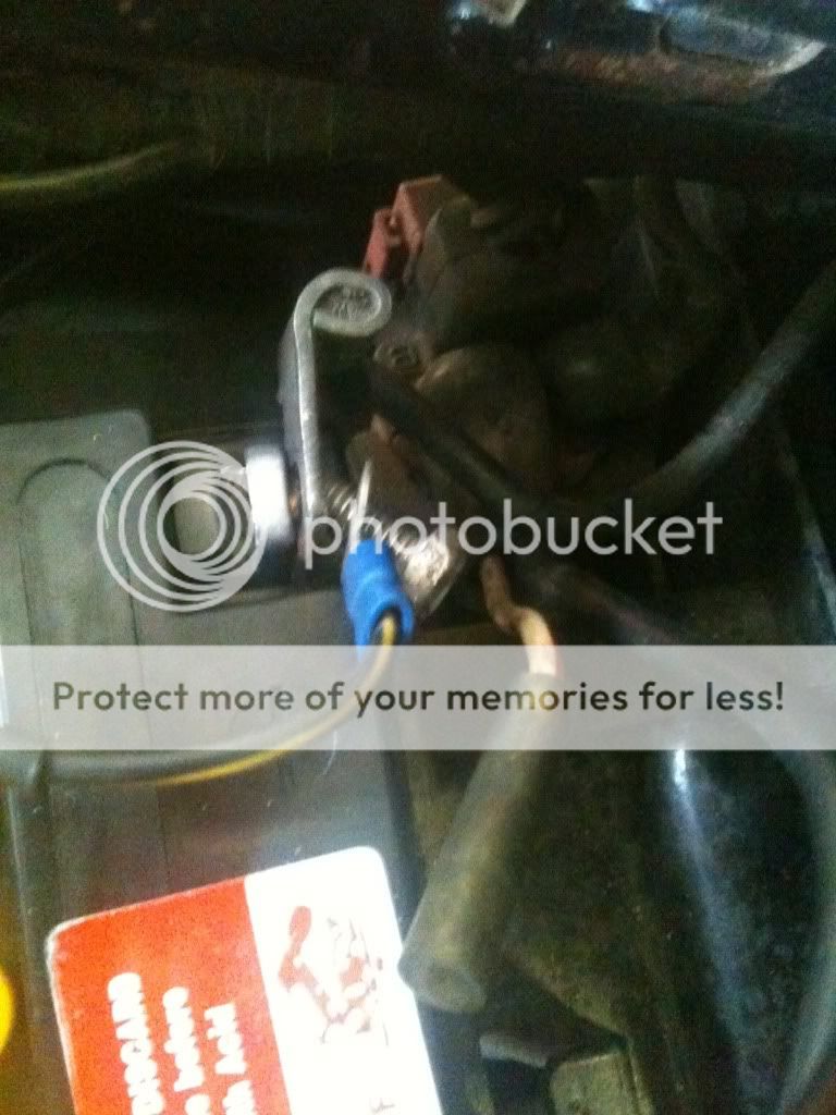

Another thing anyone know what the unconnected wire below is, the wire is red/white it appears to come from what I think was the starter solenoid.
