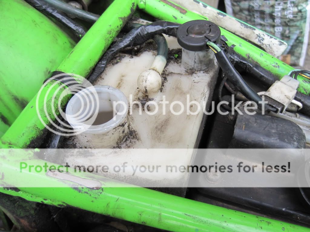

anothing thing ive noticed is, the engine/fuel oil thats under the seat has been filled up way passed the max line so im unsure wether that will be a problem, my oil light goes out when im in gear which i understand is normal when theres sufficiant oil

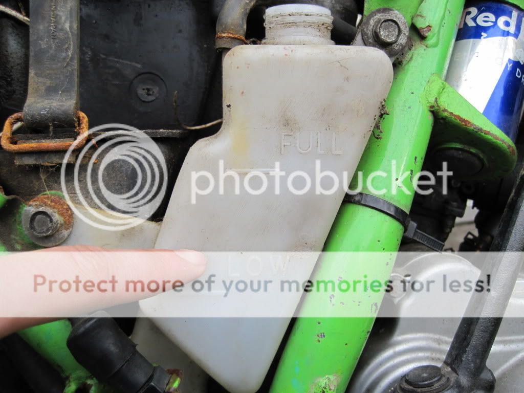

the coolant level should be between the FULL mark and the LOW mark on the plastic coolant reserve tank.
the coolant mix from the factory is a 50% solution of ethylene glycol and has a freezing point of -35c.

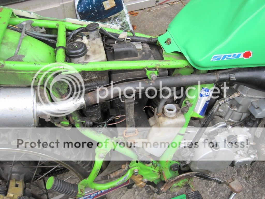

i got you guys some pics (thought ild show her off). stipped her down to her underware because i had no oil or coolant and i wanted to do something.
first pic is of the bike before i started

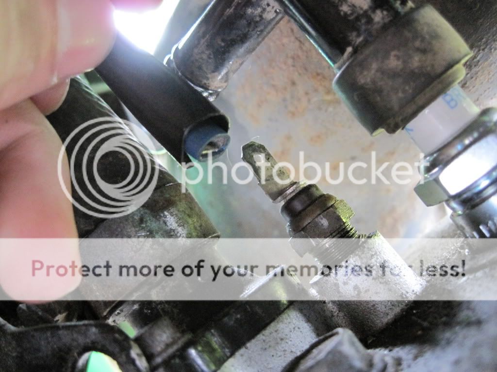

this pic is a wire that connects to a spade on the engine which i have no idea what it does, maybe someone does

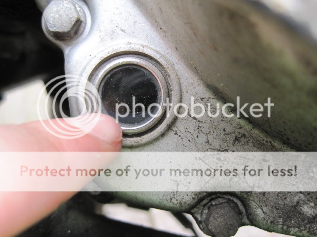

this pics is of the coolant reserve which i first thought was the fuel oil
https://i985.photobucket.com/albums/ae338/bennell09/IMG_0471.jpg
theres fluid in there Smile

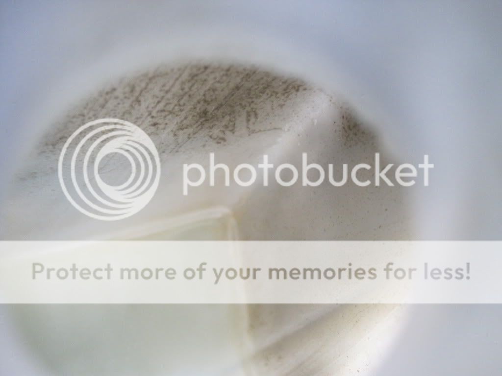

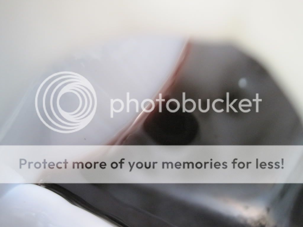

next pic is of the 2 cycle oil tank
https://i985.photobucket.com/albums/ae338/bennell09/IMG_0473.jpg
theres fluid in here too Smile

heres a pic of the sight glass which i can conferm is showing a oil level 1/3 up from the bottom pointed out by my finger

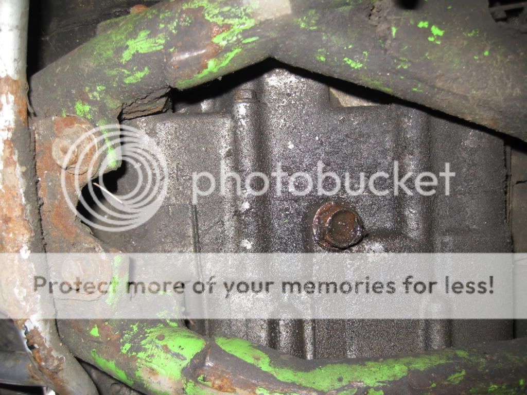

last pic is of the sump bolt (i think) to drop the gear box oil, can any one conferm this is the right bolt

the wire that u pulled off is the wire to the temperature sender - its what makes your temperature gauge give a reading as to how hot/cold your engine is ...
mine goes into the red when off road riding sometimes ... coz not moving fast ( esp in 1st gear ) so not a lot of air getting thru radiator but the engine can be working hard so it gets hot - as long as it doesnt steam i just keep going.
your correct - the bolt in your your last pic is the sump plug - id put on a new seal on it when you drain and replace the oil - looks bit wet down there.
