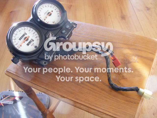

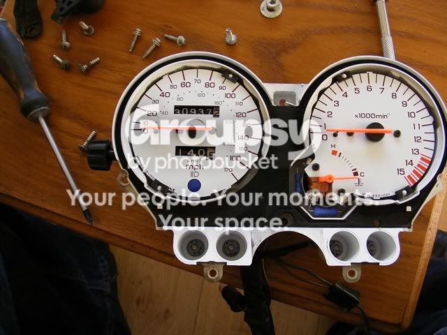

Anywho, pics.
Here be clocks:
https://i47.photobucket.com/albums/f186/markjackson13/DSCF1323Copy.jpg
If you're going to take the speedo out completely you need one of those small screwdrivers that you normally get in crackers to take the odometer reset spinny thing out.

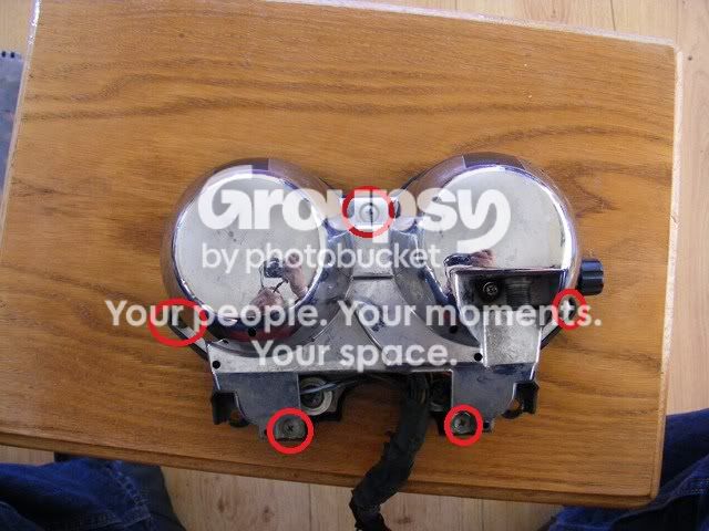

Undo these five screws and you'll have the rear chrome cover off:
https://i47.photobucket.com/albums/f186/markjackson13/DSCF1324Copy.jpg

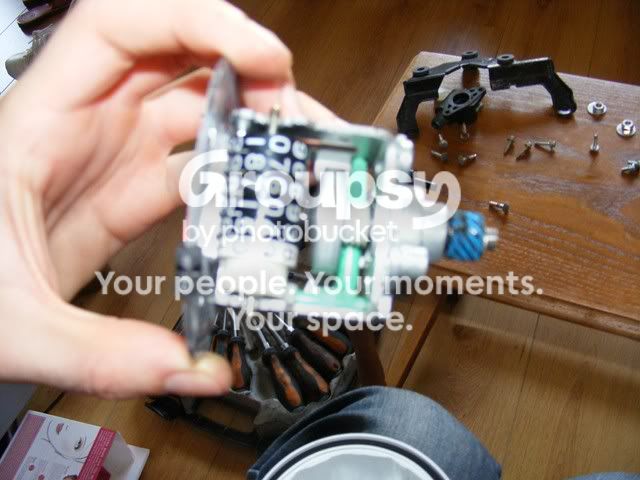

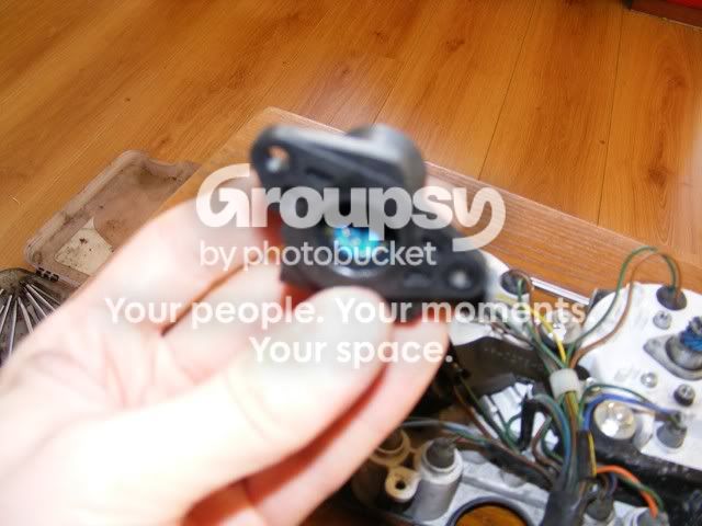

Then these two to check the worm gear that spins the back of the input shaft on the speedo:
https://i47.photobucket.com/albums/f186/markjackson13/DSCF1325Copy.jpg
Might be worth sticking the speedo cable into it now and getting someone to spin the back wheel. If the worm gear turns it looks like it could be the speedo:
https://i47.photobucket.com/albums/f186/markjackson13/DSCF1326Copy.jpg
Try and put some resistance on the worm gear with your finger incase the cable has snapped but can just about turn under no load.

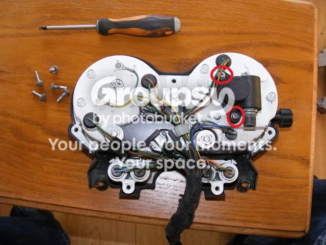

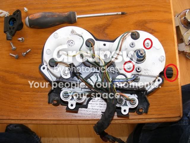

The next part you need to undo a screw that is in the middle of the four idiot lights. If you can't angle your screwdriver in to undo this you'll need to take the metal bracket, tacho wires and bulbs off:
If you then need to take the speedo out, pull out the four lights from the top part of the clocks (the three clock illumination lights and high beam light)
https://i47.photobucket.com/albums/f186/markjackson13/DSCF1327Copy.jpg
You'll also have to undo the three wires for the tacho - on the left of the pictures. With these off you can undo the three 10mm nuts that hold the backet on and slide the bracket out. Underneath in the midde of the clocks is one more screw, undo this and the front of the clocks will drop off:
https://i47.photobucket.com/albums/f186/markjackson13/DSCF1329Copy.jpg
Finally undo the two screws holding the speedo in, and the one inside the odometer reset spinny thing and you can gently coax the speedo out.
Then you could connect it all up again without the clock surround on to see what isn't turning:
https://i47.photobucket.com/albums/f186/markjackson13/DSCF1331Copy.jpg

You sir are a saint, many thanks, although looking at it and wondering how the hell I'm going to manage all that almost reduced me to tears Laughing
I couldn't get those bottom two screws off the chrome plate before but then the clocks were still attached to the bike so will try and get them off first next time and have a better go at it, will probably have to wait till weekend so I've got time to wonder how the shitting hell to put it all back together.
