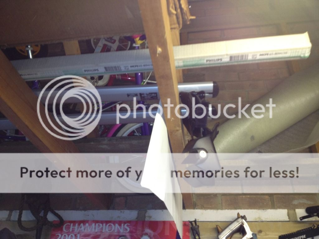

https://img.photobucket.com/albums/v295/chris-red/869cb7bd.jpg
It was up here wedged between the kiddy bikes, it took about an hour to wiggle it out. It was stuck hard I was perched on top of a ladder with 3 motorbikes below me wiggling this this it was an experience! I was more sweaty than I ever will riding it.

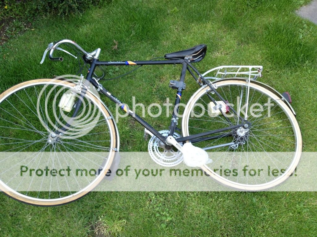

https://img.photobucket.com/albums/v295/chris-red/5df970c5.jpg
Here it is in all it's glory the name on the bike is 'Sun Solo' alot of the parts say Rayleigh.
I took all the extras off, as most of them were fucked from the crash, mudgaurds lights etc.
https://img.photobucket.com/albums/v295/chris-red/d18cfc1b.jpg
Looks pretty slick!
The plan is new tires and tubes, new cables and a chain.
Any advice? I've never really worked on push bikes. What sizes do I need for tyres and the chain? Any other bits I should change? Brake blocks?
Both wheels are buckled slightly (it was a pretty big crash Laughing ) any guides on how to fix them something to do with loosening/tightening spokes.

PostPosted: 00:25 - 09 Aug 2012    Post subject: Reply with quote
Wheels can be straightened, but it might be worth getting some new ones, maybe with some tires already on?
Change the seat, that one looks shit. Soak all the moving bits in diesel for a while then lube them up before use.

check the sidewalls of the tyres for the size as could be 700c wheels or older style 27 1/4"

Looks like a Raleigh Falcon Sun Solo.
Think they had Reynolds 531 frames, if so, not to shabby. Thumbs Up
The problem with working on push bikes is you need a lot of specialised tools, each manufacturer uses their own versions, so if your going to try and remove anything like, BB, cassette or so on, your first going to have to find out what company made them. Then what version they are, so that you can buy the correct tool. Wheels will either be 700C or 650C (will say on the side of the tire), you'll probably want to buy 700/600 x 23C tires.

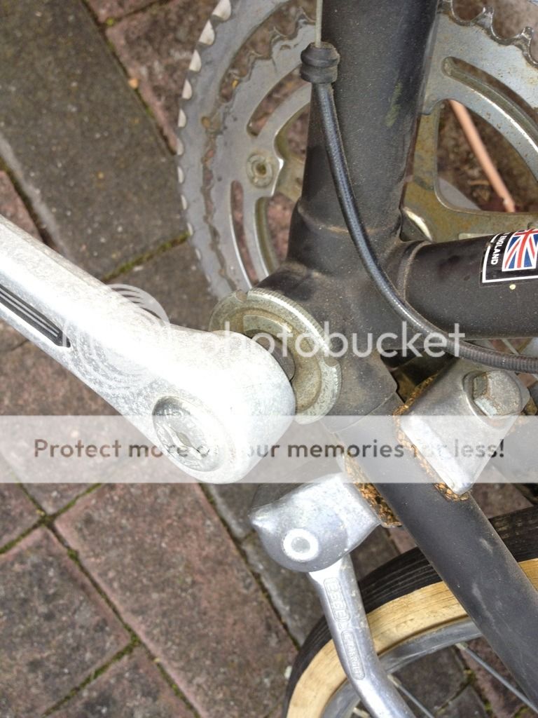

https://img.photobucket.com/albums/v295/chris-red/d4c531e9.jpg
Here is the bottom bracket any idea what tools I would need?

chris-red wrote:
The tires are 27" 1 1/4
I didn't think it was that old. Shocked
Yea you will have to buy 27" x anything tires, you cant really interchange anything with a 27".
How many gears on the cassette? 7? 8? you will have to buy a chain to match.
The bottom bracket looks like an old Cup and Cone, problem is they normally have a fixed cup and an adjustable cup, the left is normally adjustable and can be removed with a C Spanner and sometimes a pin spanner as well. However the fixed side usually needs some elaborate overpriced tool, these were sold to bike shops forcing people to pay to have the BB removed and installed. There are a few ways to bodge your own tools, there are some guide on the interwebs.

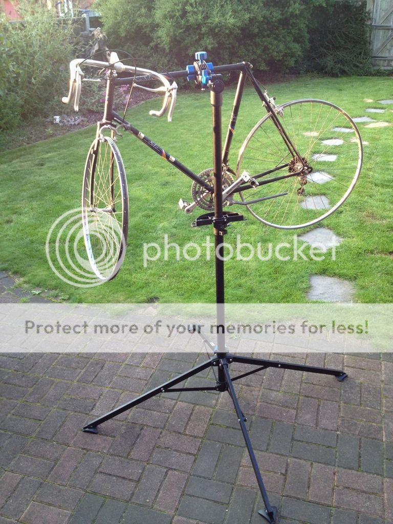

Have been slack updating this, I managed to true the front wheel reasonably wheel however the rear is proving very difficult, thinking of just taking to to a pro.
I have a chain on and gears set up front tyre on too, and a new saddle/seatpost. I have regreased the front wheel bearings and set it right.
I bought this which i think is amazing value. Really steadily built and fast delivery very impressed with it for the money. I would recomend it to anyone even for doing really minor work on a bike it makes it much easier.
https://img.photobucket.com/albums/v295/chris-red/B86DD780-2C8C-4D84-9AFE-14A85DC2A1D1-29700-00001B7EACB5AC1A.jpg
https://img.photobucket.com/albums/v295/chris-red/5B5C42F3-0BCD-48D1-96AE-C37EFFD77B68-29700-00001B7EA09A5468.jpg
All thats left to do is true the rear wheel replace the brake cables and wrap the bars Very Happy

PostPosted: 20:45 - 15 Aug 2012    Post subject: Reply with quote
Looking tidy mate!

PostPosted: 16:53 - 16 Aug 2012    Post subject: Reply with quote
I used this type of removal tool. Can't vouch for the site though.
