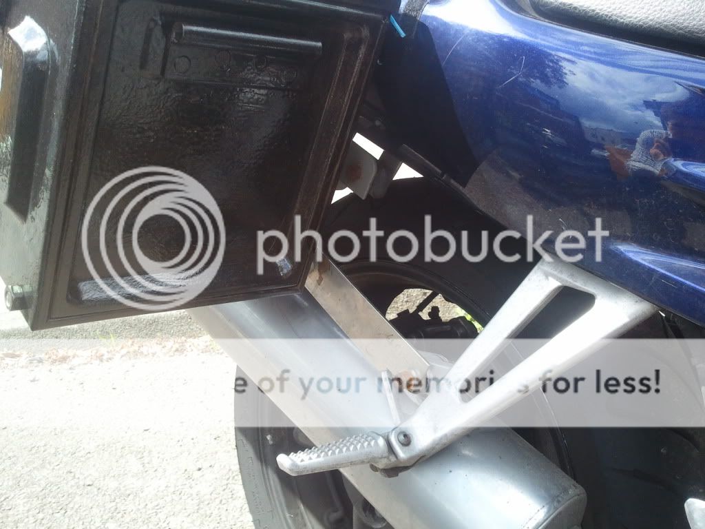

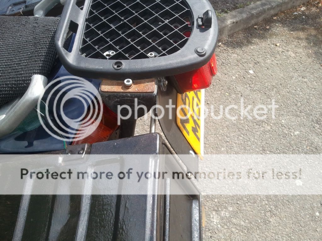

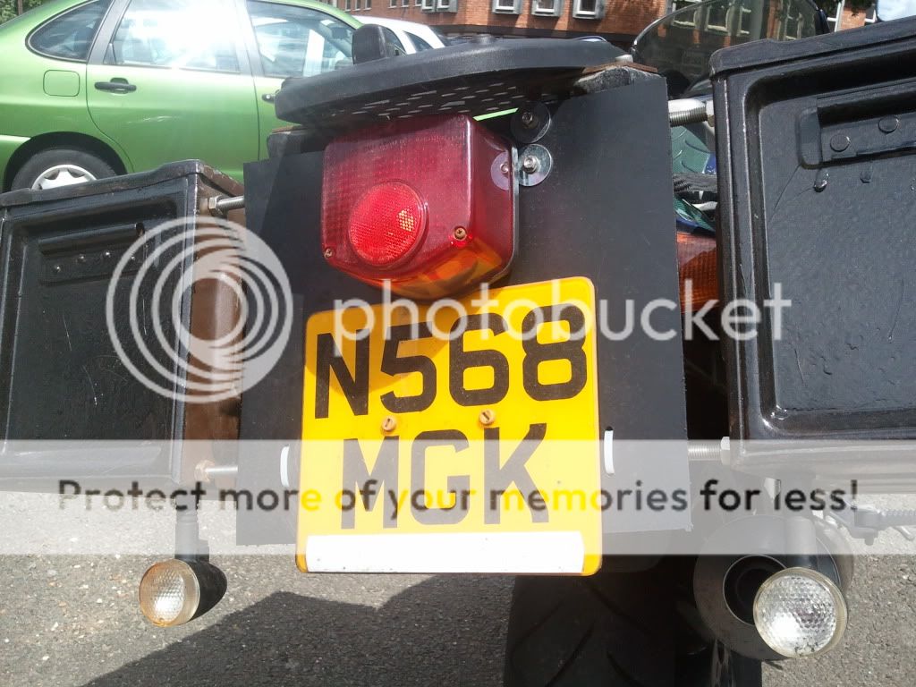

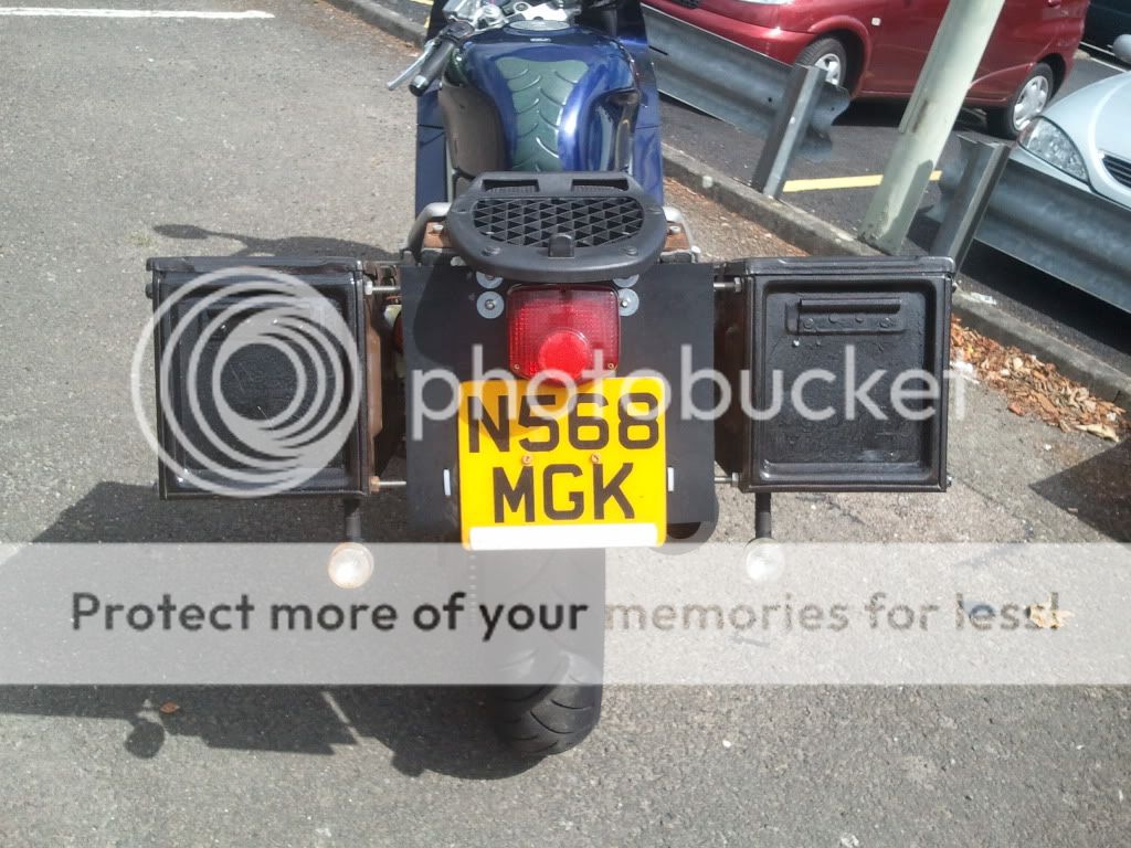

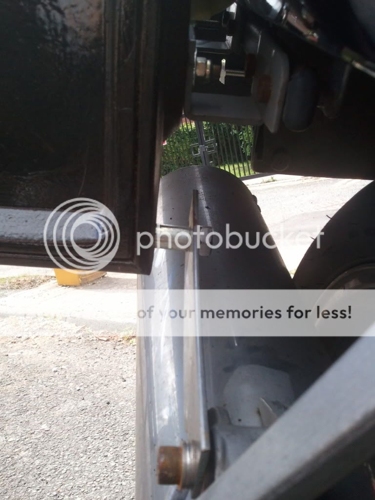

Well just a quick photo dump to show you guys my cheapo homemade ammo tin panniers
Knocked up some mounting brakets, bolted the boxes to the top box frame (bolted and welded to the sub frame), boshed through some stainless threaded bar full length between the boxes to support them and stop them wanting to fold into eachother, wacked on some stainless brackets from the front of the boxes to the pillion footrests, slapped on some hammerite so that the border police on the continent didnt think we were carrying live ammunition, made a plastic plate to mount an auxillary rear light and numberplate, drilled a couple of holes in the bottom of the boxes to mount aux indicators, jobs a goodun'
Now, many people have said these sorts of things are too heavy and what not but they really arent and for the 24 quid for the boxes to be delivered and some shit I had lying around at home I think they are perfect!
I'd just like to point out that they are not removable (quick release etc) I have made them semi permanent so that they stay on the bike for our 2 week jaunt around europe then it can all be taken off afterwards.

Haha trust everyone to pick faults, the tank pad isnt wonky its just the light in the photo, well I have riden around 80 miles with the panniers and top box full and another 80 odd with them empty and everything is still tight and solid Smile
