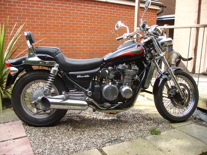

Whilst i was at it i polished some other alloy bits and bobs on my £300 quid eliminator project bike...
https://i1239.photobucket.com/albums/ff501/harrybarfield/photo-15.jpg
