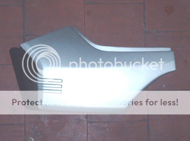

PostPosted: 21:08 - 06 Jun 2011    Post subject: Reply with quote
From another thread:
Teflon-Mike wrote:
Find lightly scraping with a stanley blade quickest & easiest to get down to the base, rather than wasting lots of sand paper.
https://i178.photobucket.com/albums/w269/teflons-torque/Little%20Dreams/PlasticsAndDecals/imag2030.jpg
Tatty side Panel
https://i178.photobucket.com/albums/w269/teflons-torque/Little%20Dreams/PlasticsAndDecals/imag2035.jpg
Shave
https://i178.photobucket.com/albums/w269/teflons-torque/Little%20Dreams/PlasticsAndDecals/imag2036.jpg
Sand
https://i178.photobucket.com/albums/w269/teflons-torque/Little%20Dreams/PlasticsAndDecals/imag2037.jpg
Hi-Build
https://i178.photobucket.com/albums/w269/teflons-torque/Little%20Dreams/PlasticsAndDecals/imag2038.jpg
Paint In this case two tone, so silver first, mask, then mat black for the inset
https://i178.photobucket.com/albums/w269/teflons-torque/Little%20Dreams/PlasticsAndDecals/imag2041.jpg
Add decals, then laquer
If its rally BAD
https://i178.photobucket.com/albums/w269/teflons-torque/Little%20Dreams/PlasticsAndDecals/104_0299.jpg
After Shaving
https://i178.photobucket.com/albums/w269/teflons-torque/Little%20Dreams/PlasticsAndDecals/104_0346.jpg
Lugs can be built up by plastic welding, using soldering iron and similar texture 'scrap' plastic.. coat hangers work well....
https://i178.photobucket.com/albums/w269/teflons-torque/Little%20Dreams/PlasticsAndDecals/imag1915.jpg
Damaged areas can be welded up, and filled in, to remake the shape
https://i178.photobucket.com/albums/w269/teflons-torque/Little%20Dreams/PlasticsAndDecals/imag1919.jpg
Dressed by filing & sanding
https://i178.photobucket.com/albums/w269/teflons-torque/Little%20Dreams/PlasticsAndDecals/imag1936.jpg
Then 'smoothed' with hi-build before primering and painting
https://i178.photobucket.com/albums/w269/teflons-torque/Little%20Dreams/PlasticsAndDecals/imag1937.jpg
Before two-toning
https://i178.photobucket.com/albums/w269/teflons-torque/Little%20Dreams/PlasticsAndDecals/imag1941.jpg
after... with untouched panel from other side for comparison
- Soldering iron
- 'Scap' plastic filler rod
- Lots & lots of patience
I have 'bedded' washers or wire in accross splits... but, often makes life harder... just use plastic & if it breaks... do it again.
