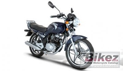

This yours?
https://www.bikez.com/pictures/giantco/2008/28890_0_1_2_hunter%20city125_Image%20credits%20-%20Giantco.jpg
I'm sure someone can identify what it's copied from.
The engine looks to be a 156/157FMI unit, a fairly close copy of the Honda CG125's engine. When you say "filter change", did it actually have a replaceable filter, or is there a mesh filter fitter horizontally on the bottom left hand side?
It sounds like your problem is at the bottom end, but it'll also want the valve (tappet) clearances checked regularly. It's a fairly simple job, so I suggest that you do that now. You'll need a set of feeler gauges. The procedure is described here and here.
These engines tend to be pretty robust. Sling any old oil in them. I've used semi and fully synthetic, and even dumped some Activ-8 friction reducer in without causing clutch slip: that's not a recommendation, just information.
Just be cautious about handing it to a garage to deal with. Once they get into the engine, it can easily cost you more than the bike's value. If it turns out that the gearbox is shagged, then you may be as well trying to find a replacement engine from another bike.
And bear in mind that you'll never recoup anything that you spend on it, so only spend what you can afford to lose.
